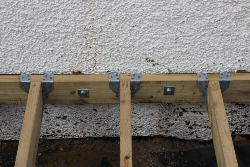

I'm fitting a ledger board to gable end to hang a suspended floor off in new extension. The other end of joists will be on joist hangers hung from the blocks at other end.
Should I bring the dpm up from under the concrete oversight and behind the ledger board at one side and the joist hangers at the other?
Seems to me this would completely eliminate any risk of damp wood.
You could do what you suggest or, perhaps simpler, run lengths of DPC behind any ledgers or plates?
"joist hangers hung from blocks" what does this mean? Hangers would usually be pinned to the ledger board.
Sorry if not clear, I'll try to explain...
Here is the house, with extension planned to the side.
On the current gable, ledger board with joist hangers like this (will it matter if this is below the current dpc on gable?)

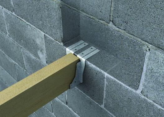

On the far side/new gable, hangers set into blocks

No, it wont matter if its below the house DPC just so long as it has a strip of PC behind the ledger.
You can hang from a ledger or as in the pic, from the masonry.

Given that I'm building it myself and I'm not a pro, I imagine a ledger on each side would be the easiest way of getting the floor level? Without having to rely on mm perfect blockwork?
You wouldn't need to have the blockwork so precise. Just leave over-large slots in the blockwork and pack up underneath the joists later to get them level. Then fill the gaps above with foam.
Masonry hangers are not cheap, and you will still need to do a little packing to get the joists seated level.
