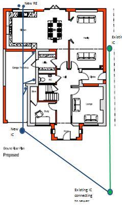

Thanks for your reply Noseall. I have put together a quick diagram of the existing drainage in green and what the architect has drawn up in blue.
I was originally not in favour of this as there is an inspection chamber in the middle of the garage floor for connection to one SVP (upstairs ensuite), two sub stacks (family bathroom and cloakroom) and the gulley from the kitchen at the back of the house. I guess I don't like the idea of the inspection chamber inside the building this limits future conversion of the garage. There will also be an inspection gulley close to the driveway entrance. The maximum distance on the proposed design is 30m
I would have thought it was a neater solution (but maybe not the most practical) to run all drainage to the rear of the house with a single inspection chamber outside. The run of the longest drain in this case would be 38m. If the existing inspection chamber along the side of the house could be used then better still.
The inspection chamber close to the sewer is 600mm below finished floor level, the other existing chamber is 300mm below.
Any good ideas and suggestions are much appreciated.

Why does the blue run run all the way down the garden and then turn 90° instead of just running diagonally to the existing connection? What's the shortest run in metres that can be achieved by going as close as possible to the existing corner of the house and then diagonally?
Nothing technically wrong with a manhole in the garage even after a conversion, provided it has a sealed cover then no smells or risk of it backing up should occur, just more hassle to inspect if ever its required (ie its gonna be under the carpet).
And why hasn't your architect sorted this out?
Can you identify what each blue dot is?

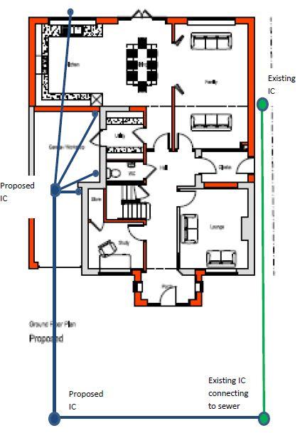

On the face of it, I'd take one straight run from the rear kitchen, with a RE in the back garden, connect the other drains to this on the basis of rodable stacks/access points and low usage, so no MH under the garage, put a chamber just outside the garage door and then run diagonally to the existing manhole at the front

Based on your suggestions, I wonder if Woody's suggestion is this is the way to go? The total run from the rear of the extension to the sewer connection is 28m - 14m front to back and just under 14m diagonally.
If the inspection chamber level is 600mm below the finished floor level then a 28m run and various gradients requires the following drops:
1:40 - 700mm
1:60 - 470mm
1:80 - 350mm
Is this really possible given the concrete slab at the rear of the house?
To answer the question about the blue dots, from front to back there are 4 connections:
SVP for ensuite bathroom upstairs
sub stack for cloakroom downstairs
sub stack for main bathroom upstairs
BIG for kitchen

Take finished floor level datum as 1000. Invert level at top of run 300 below FFL = 700. Invert level at IC before main sewer 600 below FFL = 400. Gives a fall of 300 over 28m.
Over 28m you need minimum fall of 350 at 1in 80. Therefore theoretically, drainage will not go in on gravity, how ever if we were doing it we would go in at 1 in 95. If bottom of trench is hand trimmed and pipe is laid very accurately then with three WCs on the line you should have no blockages, repeat should not have, but not guaranteed. The existing 600mm deep inspection chamber will need new channel junction and not a three quarter section bend as you will need the additional 50mm in the IC.
If you do not fancy fall of 1 in 95, then you will require single dwelling 1178 litre pumping station. Not cheap, and can be troublesome.

Going back to the original idea of the inspection chamber in the garage floor for the three soil pipes, would it be feasible to run the sink waste to the existing inspection chamber at the rear of the house? This IC is 300mm below FFL but could go around the perimeter of the house rather than cut across the slab.
Thanks once again.
Matt
That idea is feasable - and a good one - If you use a gulley with rodding access and have an outside tap above it , you`ll be able to flush the pipe if necessary . The problems I have encountered with sink/dishwasher/washing machines/waste disposal ( in sink) is due to the fine debris and fat making a sludge . So with this drain run the worst case scenario is you MAY have to rod it with a brush on the rods from the existing manhole . Also Build Control might let you use a long radius bend @ the corner of the house , instead of a manhole :idea: Any work is outside the house , also the double seal internal manhole in the garage could be shallower because it now takes just the WC`s - giving more opportunity to get a better fall :idea:
I think you will find that the 40mm sink waste cannot exceed 3metres long, so you would have to use a 110mm from there to the manhole.
