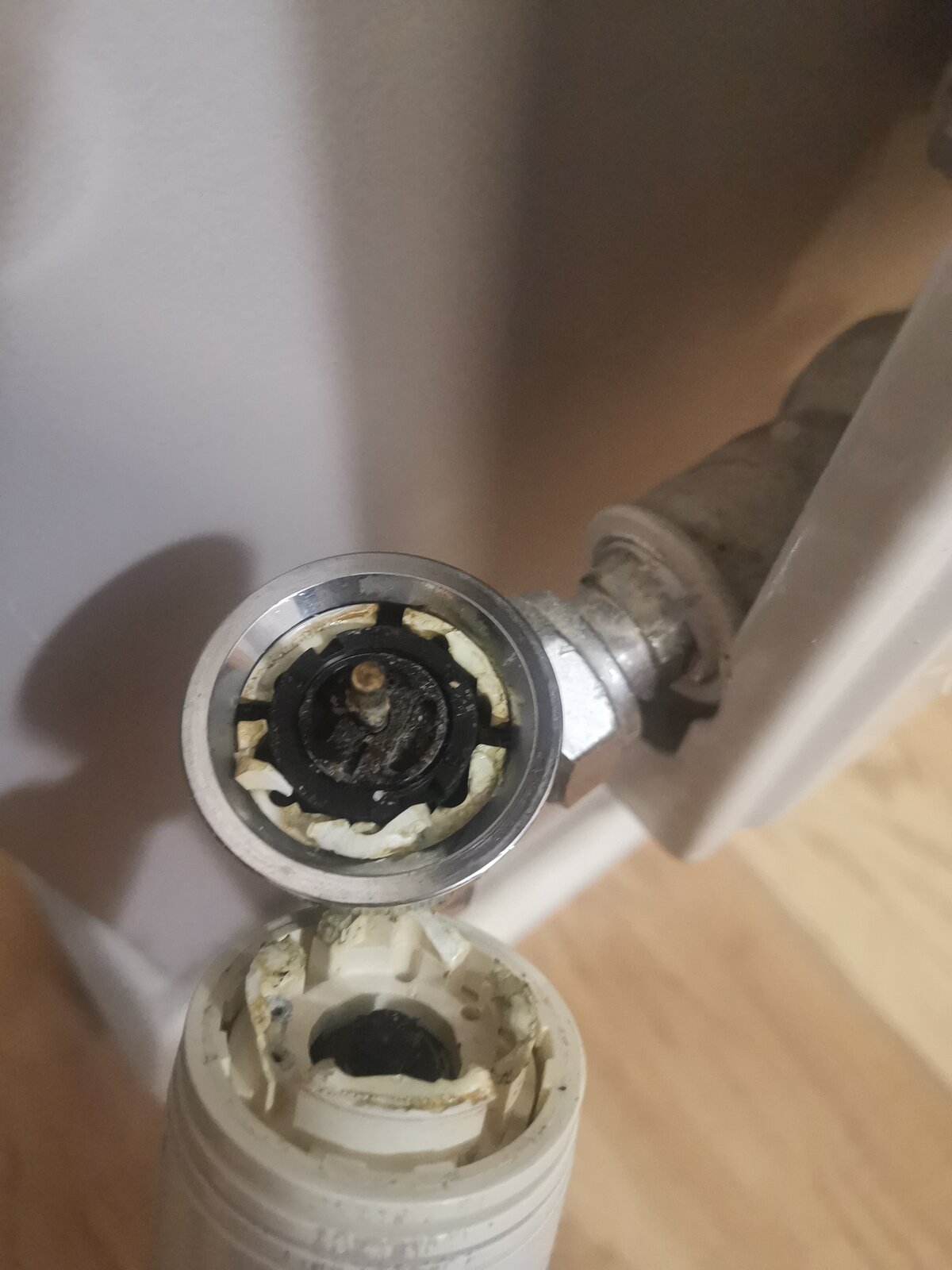

I've replaced a new Drayton trv 4 myself on the first week of November with the same issue. Now it's broken AGAIN! I've attached the image here of the broken valve. Can anyone determine what's the cause of this broken valve? Is it the quality or what are the causes??

Replacing head onto an actuator pin that is jammed open will do nothing but stress the new head.
Do I have to replace the valve body as well? I'm new to this. The pin is jammed at that position
You can try freeing the pin off- have a search in this forum, it's not a rare problem. WD40 and a spoon are popular. And yes that'll be why your new head has failed.
