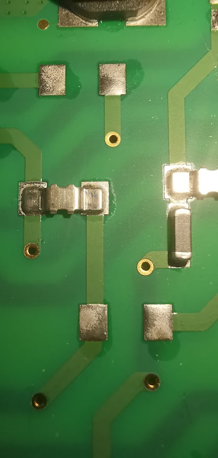

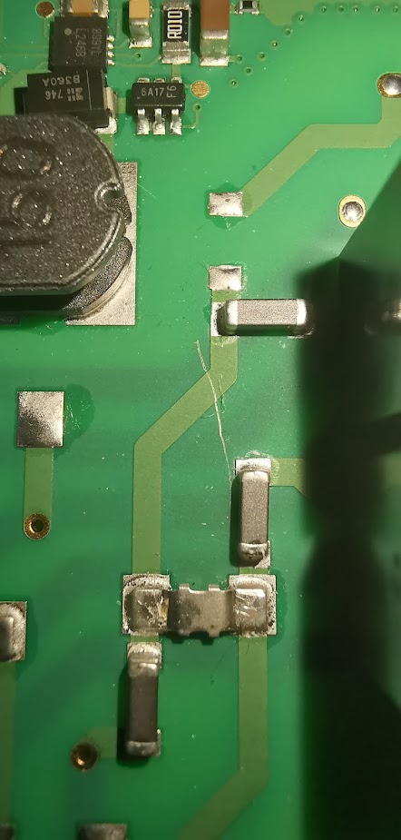

I failed to install the Hub and managed to burn a component on the PCB in the process.
So in order to fix my mistake I managed to ask a friend of mine that knows his way around boards and how to replace faulty components.
Is there anyone who can take a detailed (or more picture) with the back of board the one with resitors and such? Or the Board diagram would be more helpful as the burnt component can't be recovered... I know, don't even start. :(
So please, I beg you to help me.
Is this what you need?
Yeah I think that's it. I forwarded it to my friend. Pending reply. Thank you for the swift reply!
Well it turns out that the picture isn't detailed enough for the resistance to be identified. I wonder if i can find the PCBs wiring diagram or even better still if someone (who I will be forever in debt) can measure the 2 resistances that are in the center.
Most of those components have no markings. My Brymen BM235 says they have no resistance either! (well maybe 0.001Ω) - so are they just links?
