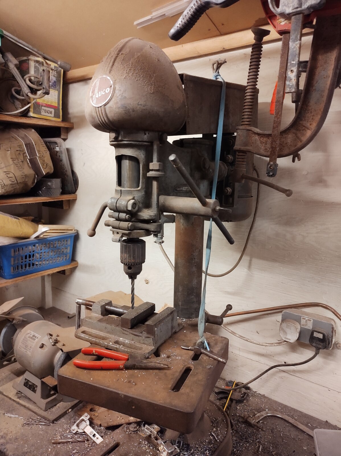

Yesterday I had to drill through the centre of some brass nuts to turn them in to super thick washers.
It first one, I did using a cordless drill, my adjustable jaw pliers and a sacrificial block of wood. I regularly had to flip the nut as the drill bit kept grabbing. That first one took me about 2 mins.
My stepfather reminded me that he had my benchtop drill in his shed. Still using a block of wood and my grips, the remaining nuts took about 20 seconds each, and no grabbing.
I guess some drill stands will let you do that, but many won't.

My £40 boot sale Tauco is still going strong after 75 years or so.
That reminds me, you need a drill vice to go with it. Some are very small.
