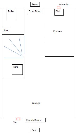

I have a fireproof safe that needs to be fixed to a concrete floor in my house. The house is 5 years old and has a concrete floor but I was wondering if it is ok to drill down 70mm? Would there be anything in the floor like water pipes? I know the wiring is in the walls.
The safe is to be located in the centre of the house to one side (but not against the wall). The water supply comes in to the front of the house (kitchen) on the opposite side, the bathroom is also on the opposite side, but the downstairs toilet is on the same side at the front of the house over 2 metres away. There is also an outside tap (installed during the build of the house) which is on the same side of the house to where I want the safe but over 4 metres away, however I don't know the route of the pipe work. I imagine it's run along the wall from the downstairs toilet behind the plasterboard. What are your thoughts on this please?
I've attached a ground floor plan to help show what I've described above, it's not to scale.
Thanks in advance.
If you have a screeded floor then the fixings are only likely to be contained within the screed material and not the actual concrete.
No one on this forum will be able to tell you whether pipes exist at the points where you wish to fix. However, laying the pipes within the screed would be a less desirable option for the plumber. Other simpler options would be explored first.

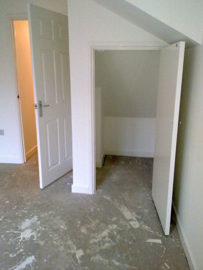

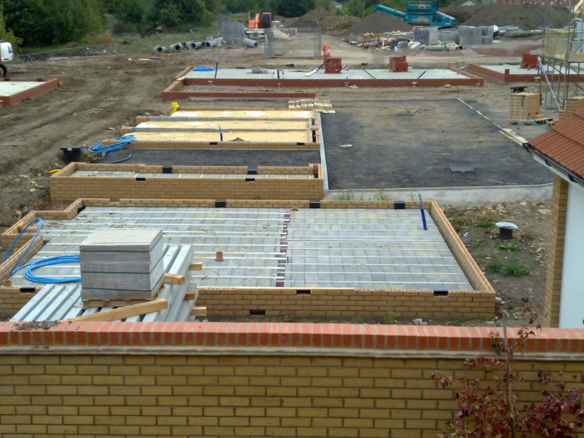

Thanks. I guess I can get longer fixings than the ones supplied. Is there a standard depth the screed should be?
Attached photo is the flooring before the carpet was fitted. The other shows what the concrete blocks, which are under the screed? (not my actual house but from the same development)
They are B&B floors (block and beam). There will be a screed. I doubt drilling deeper will be any more of a deterrent. Most crooks would see that it was bolted to the floor and likely leave it there and go look for a key or angle grinder or O/A torch etc.
The screed thickness could be anything above 50mm.
It looks like that floor will have 50-75mm of insulation on it too before the screed.
Pipes are not buried in screed nowadays unless you have underfloor heating
Thanks. So I'll need really long fixings then. I guess there is no point trying to fix it to the screed as it will be too weak and crumble?
