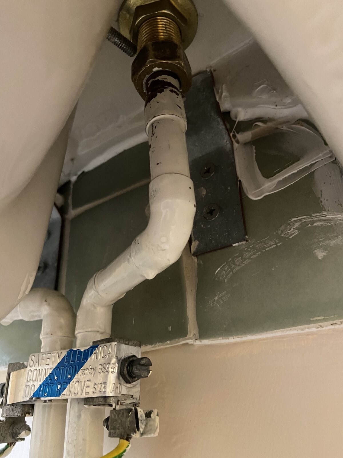

Hi all,
Finally got around to changing a tap after it finally gave up and stopped turning off entirely (up until then it had been a bit stiff but nothing more).
Quite limited space under the sink (looks like they put the taps on and then screwed to the wall given the limited space, but I am no expert…)
It works - turns on/off and was a like for like replacement of the tap, but… there’s a drip from under the bolt (that cannot be tightened further) - it’s not huge, but sufficient enough to need fixing.
Any ideas on why this could be?

Just tidying up in defeat - a rather suspicious looking dried out washer… potentially…
should the bolt have one? I can’t see to check, but wonder where else it could have come from (it could also just be a suspicious dirt ring)
Can only see one steel bolt at right angles to the tap shank and that wouldn't have anything to do with water by the looks of it, looks more like the bolt from a plug chain
There should be a fibre washer under that union, connecting pipe to tap, where the two faces meet.
Sorry - typed in haste, for some reason I have always confused nut and bolt; so yes, I meant a drip from the nut - not the bolt, and yes, sadly, I think it's what was put in when the house was built and they wanted to make sure it'd never come off... or not until they were a good distance away...
I think that's where this could be going wrong, but it's so hard to get any visibility due to the set-up, fumbling around blindly isn't the best solution, but the fact that there's a drip (and the mysterious half a washer shaped rubbish) suggests that it might be worth a try.
You should always fit a new fibre washer when fitting a new tap ,and all traces of the old one should be removed from the tap connector first ,to ensure a leak free joint.

Had I seen the washer I probably would have done this anyway, but given the tight workspace and awkward angle (also no isolator on the pipe, so the whole house water has to be shut off) it was a struggle.
Will take apart and start again tomorrow.

The nut should drop right down so you can see the flange that the fibre washer sits on, that'll ensure you can see that it is nice and clean before using a new one.
Doesn't need to be super tight, as long as the nut tightens up easily with your fingers, then it's finger tight plus 1/4>1/2 turn.
