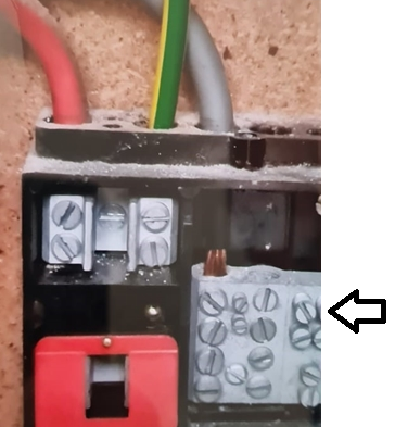

The thing about the photo is the bottom screw is not screwed in.
They say they would never leave a screw loose like that.

Thats a very unlikely mistake to make. If you've got a wider pic that wld be handy, see what length there is on that lump of cpc.
EDIT The phase and neutral conductors look like nice swept bends, the cpc is just chucked on top. Again looks inconsistent
Yeah I'm not convinced by that photo either, I'd like to see a wider shot of the associated equipment and consumer unit. I'd be very, very surprised if someone who's been in the trade for 25 years would make that mistake. I'm not saying they didn't I'm just saying it's very unlikely in my opinion.
danniboi2003 - No wider pic.
That's the one sent by the householder's 'electrician'.
Bernardgreen that's an excellent spot!
They do look screwed out.
The installer said they remembered breaking out the top to accept the earth.
Oldbutnotdead - The gas and water pipes were bonded.
The point about the swept live and neutral was pointed out to me by the installer.
They said they would never put a cable straight in without sweeping it over, as per the other two.

Lesson here, take photos before leaving, doesn`t matter if customer see`s you doing so or not.
Whoever took that picture has removed the main fuse, and also removed the cover over the neutral terminals.
If that earth wire is connected to anything at the other end, inserting the fuse into that would cause a severe fault, probably enough to blow the main fuse, and causing arc damage to the fuse holder and those terminals.
It has not been energised like that for 2 days or even 2 minutes.

When I'm working with tails, and I think it's same for most electricians, I NEVER run the thinner earth cable OVER the thicker L&N tails.
I tend to run the earth cable behind the heavier L&N tails as they keep the earth cable in place.
If the earth cable is in front of the L&N, it flaps about because it's quite light.
THE ELECTRICIAN IN QUESTION MAY WORK LIKE THIS, IN WHICH IT LOOKS LIKE IT MAY HAVE BEEN TAMPERED WITH.
And another thing, that terminal where the earth wire wrongly is, wouldn't that have had a bung or something over the top of the casing? Otherwise it would have been wide open beforehand.
