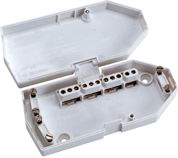

@stuz do you have access to the ceiling space above? If so, the correct method would be to fit a lighting junction box up in the loft with the two wire cable coming into the new junction box.
@Taylortwocities Thanks for the reply - it's downstairs so no access to ceiling cavity - I did think about tidying it all up into a separate box and easing JB back though the hole in the ceiling - but my understanding is that's 'illegal' as it won't be fixed. I could put it all in a seperate box next to my new light fitting? That would be a bit ugly but I guess would work. What about the earthing question?

As you say lighting junction boxes do come with cable clamps, 1675775161487.pngbut as it if you could get it through the hole where the cables come out, not so sure. Says Width - 50mm, Height - 120mm, Depth - 30mm so it would fit through a hole drilled for a down light, but the cover shown does not look big enough to cover a hole made to take that box.
I use these:
Your ceiling hole will need to be slightly bigger, but it is easy enough to push back through, out of the way.
