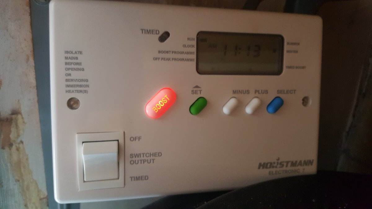

I have just moved into a rented house and the boiler does not seem to be producing any hot water, I moved in on Friday and switched the HorstMann Electronic 7 to the timed position, over night the light seemed to come on to suggest the water was being heated, and if I press the boost button the light comes on (picture below)

However no hot water is being produced, im not sure if I have missed another switch somewhere or if something else is wrong? Could use some opions before I contact the landlord tomorrow.

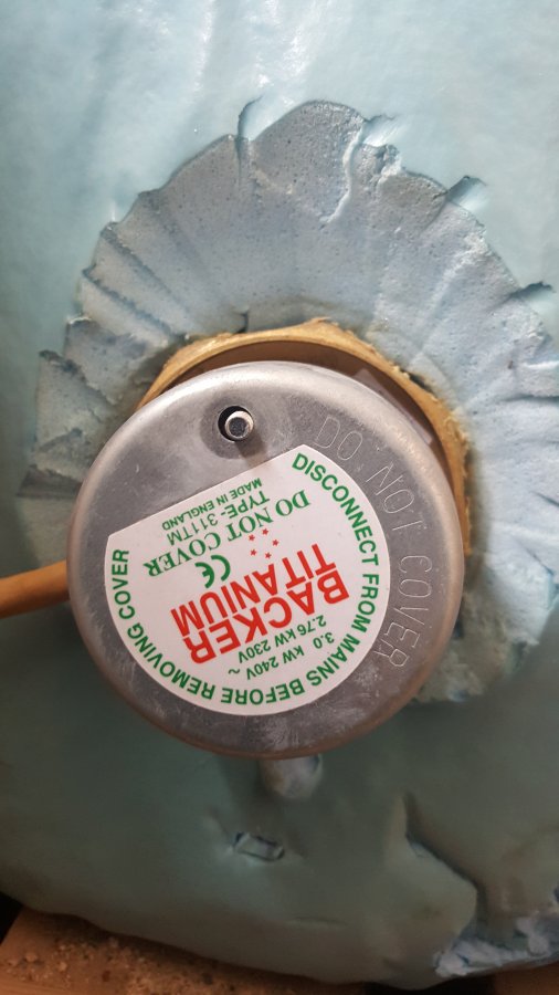

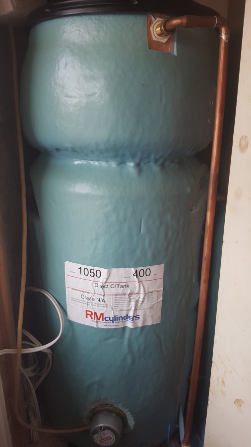

Zac. I guess that you only have one element in the tank, or are there two.?

I believe its just the one element? and unfortunately I don't have any test equipment, I did have a multimeter but im not sure where it is after the move....

However, it looks like you only have one immersion (at the bottom of the tank).
If the cable from there goes directly into the Horstmann unit then it could be
the timer unit itself
The immersion element
the immersion's thermostat
or a broken/burnt out bit of wiring.
there's a light on the boost so at least we know there is power going into the Horstmann .
Cant be more help that that..
PS, I see the securing nut to the immersion cover is missing, so somebody may have been in there……………
