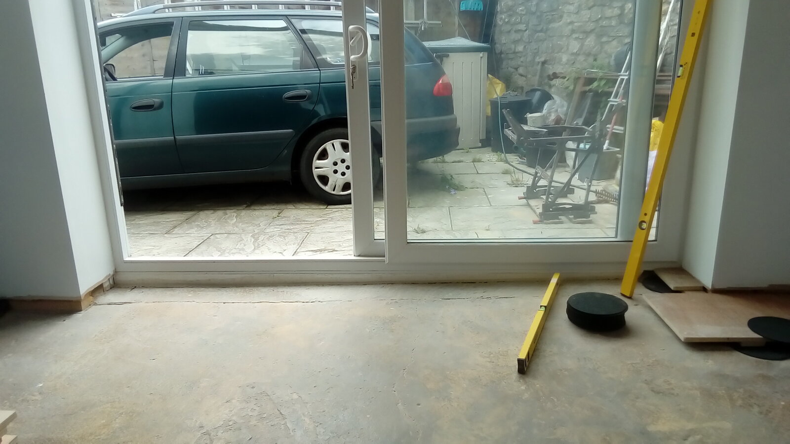

P_20210925_151525.jpg P_20210925_151546.jpg Am putting in 18mm ply with 8mm click vinyl surface, looking for an 8mm edge trim to go along the btm of this sliding door, just under the window frame btm, it's a bit tight for clearance at the right hand end but gets better to the left.
Reveal is 2525 skim to skim. There is a 2.5m Dial 8mm aluminium edge trim but is it for wall tiles? It's quite flimsy.
Are there any dedicated flooring edge trim about, out of thicker gauge? A little more substantial, like thresholds are perhaps?

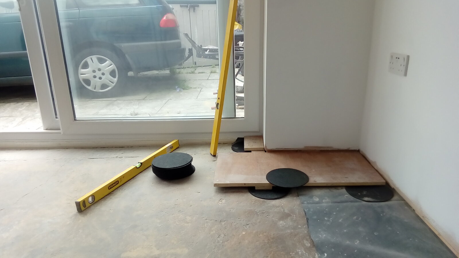

I was going to bracket a timber bat/strip up off the conc. base, vertically against the upvc frame and screw the edge trim to the top of that. The edge trim should provide room for movement. The ply substrate may extend beneath the trim slightly, but will not be in contact with the edge trim support.
I was hoping for a few pointers re support and fixing ply where top of floor height is an issue (set by the upvc frame). I've considered rubber pads, ply doublers as splices, Stratarise decking pedestals etc.

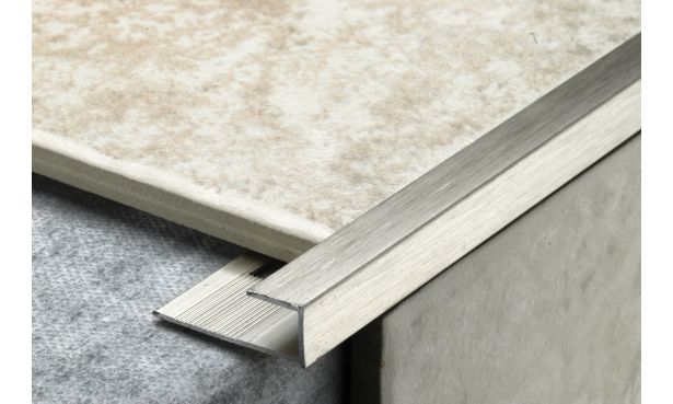

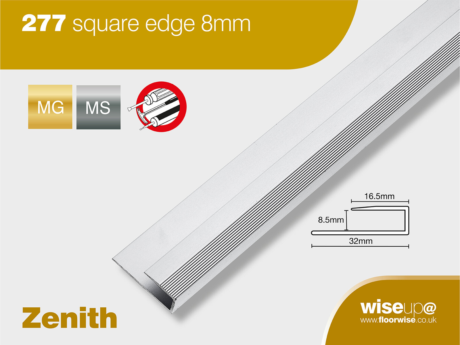

Does anyone know where I can find a single length of this? It's 2.7m, which is handy. It looks much better than the really thin stuff at the sheds, which would be ok if up out of the way on wall tiles.
Or similar?
