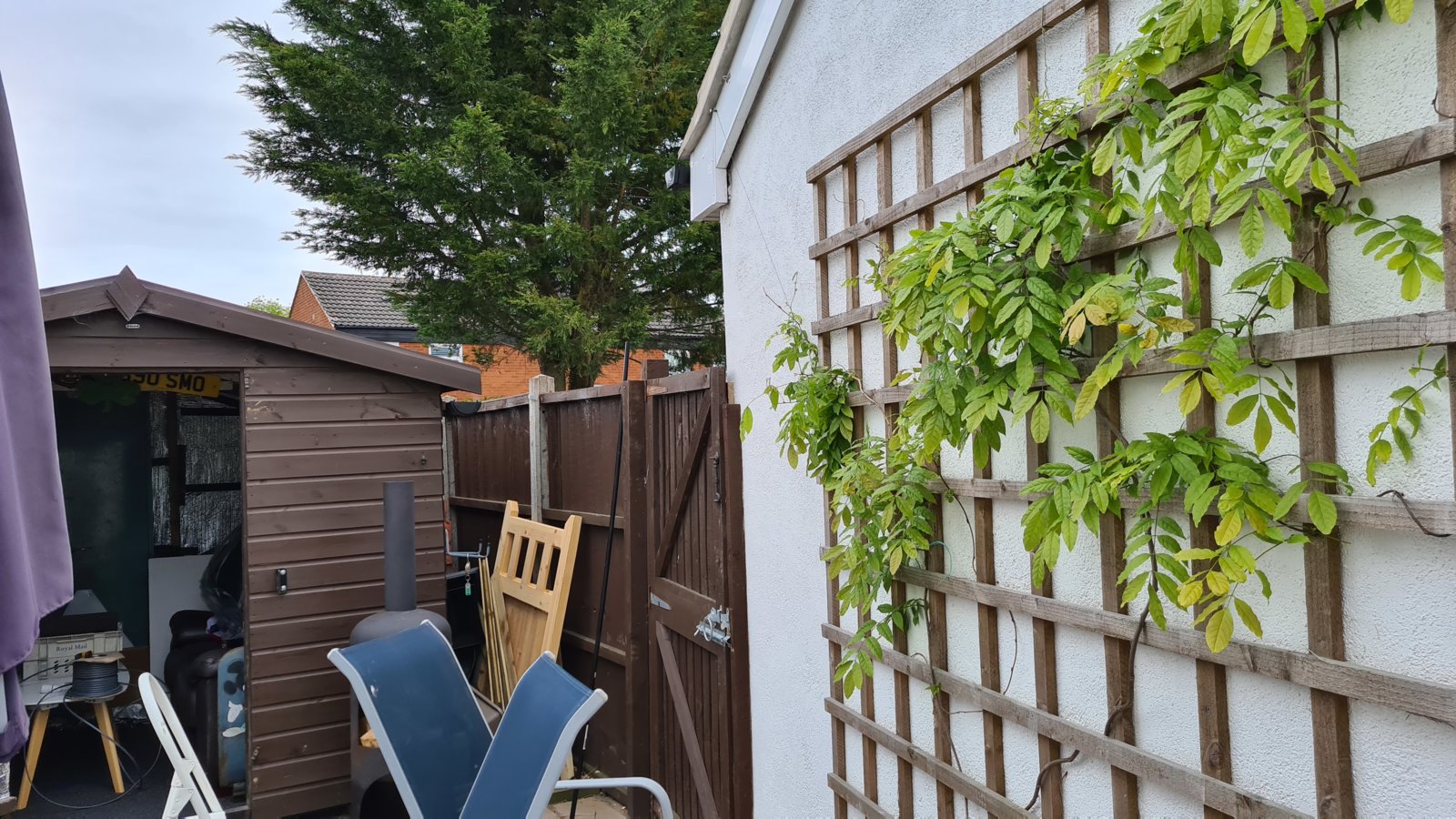

Hi
I only wanted two sockets for a TV and fridge and a light in the shed.
What's my best way could I just span some amounted cable overhead as only a small space. Cant go underground as patio is laid
That cable in the shed is not suitable for outside use.
You could use armoured cable but this is lighter and easier for overhead applications
https://www.tlc-direct.co.uk/Products/NY2dot5slash3.html you can buy it by the metre.
You can string it up using a catenary wire. The whole selection of parts is here
https://www.tlc-direct.co.uk/tcl/search?query=catenary&Submit=Search
you just need to order what you need for your application.

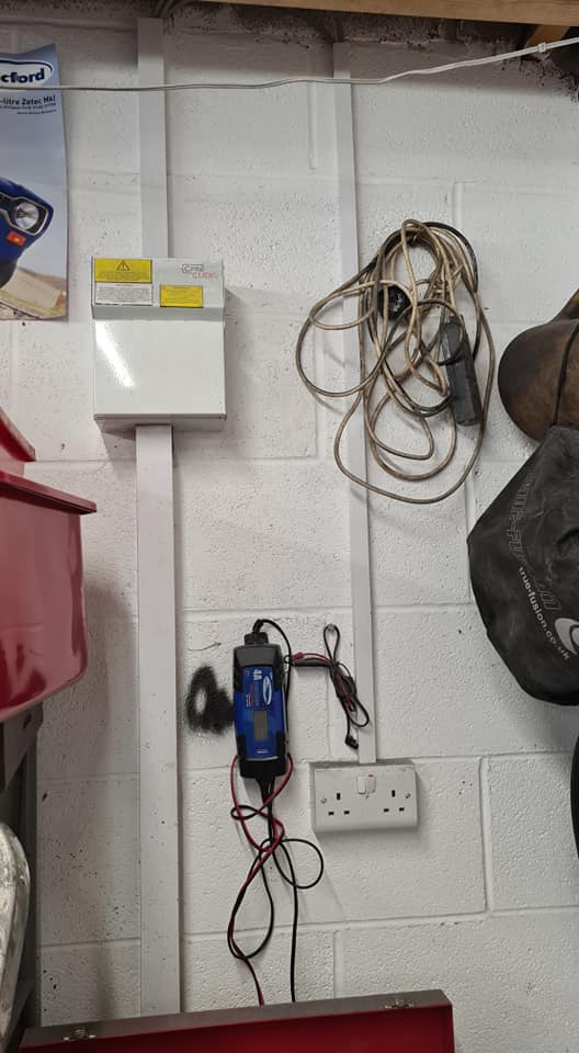

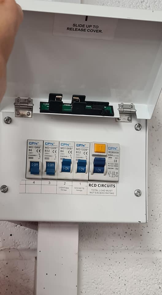

I was just going to take off the back of this socket on the garage ring, and run it over via the same system to have linked me to.

Are those two MCBs on left spare?
If so, your best option is to use one of those to power to the shed.
BUT
the 2.5mm² cable I specified is too small for a 32A supply. You have two options
1. Change the breaker for a 20amp one (must be a CPN one)
2. Use 4mm Cable.
https://www.tlc-direct.co.uk/Products/NY4slash3.html
but this is really circuit design territory. You should be using an electrician to tell you exactly what your options are.
Are those two MCBs on left spare? If so, your best option is to use one of those to power to the shed. ... BUT ... You should be using an electrician to tell you exactly what your options are.
Indeed, and another 'BUT' (and another reason for engaging a 'self-certifying' electrician if one went down that route) is that, even though those MCBs are 'already there', I imagine that most people would say that connecting something (the first and only something) to them would constitute creating a 'new circuit' - hence notifiable.
