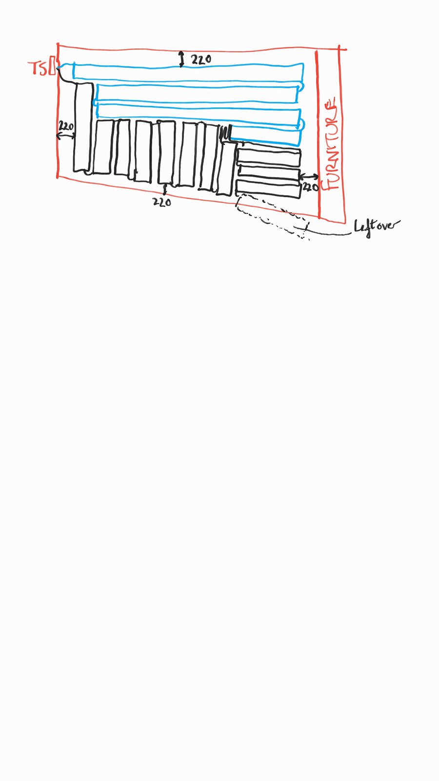

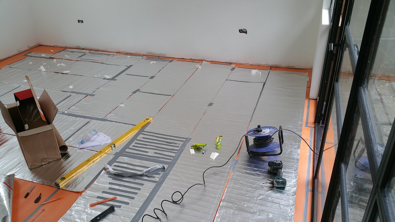

I have installed a couple of those foil backed Pro-Therm electric underfloor heating matts, and am about to install another, each under engineered floating floor.
To be honest, the layout has been a complete nightmare. Thought I had it planned out with a nice border round the edge, but ended up having to slice the matt up into loads of pieces (not cutting through the wire obviously), and running it all over the place where I could find a slither of space. I'm sure you get the picture (see attached images).
I contacted Pro-Therm directly but they said that they were suppliers only, and so could give no advice on installation. Nice! Watching this video (
) gives you an indication that you go off in 2 directions and zig zag, but they way they do it, meeting in the middle is very risky. If you get it wrong, you have a lot of spare matt with nowhere to go!
Obviously if you have one matt, life is simple, but starting with the main cables near the entry point into the wall, and working outwards back and forth.
I'm sure space is lost, as you cut the matt and rotate it 180 degrees, but it still ends up covering a much bigger area than I intended.
So, the question is, is there a trick to doing this, or some sort of software that can map it out for you, or do you suffer the same problem?

I've only done electric UFH once at a mates house - we used a roll of wire for that. Having the wire pre-fixed to a mesh saves time laying it out, but as you've found, loses you a lot of flexibility.

Afraid so - but you are to late to employ it. I'll post my thoughts based on my experience of laying EUFH mat in my bathroom.
When you measure up the room you need to subtract 250-300mm (10-12 inches) off the major dimensions so if your room is 2.6x3.5m (8'8"x11') (9mSq) then you need a mat to cover 2.3x3.2m (8'x10'6") (7.35mSq - in practice 7.5mSq).
When I did my bathroom I measured the room up, made a plan with exact measurements and took that to the suppliers, they rounded down and said I should have 4mSq. I really struggled to to use all; laying out all the mat and heating cord and that was after I'd removed a dividing wall which I hadn't decided to do before buying the mat. I'd have been better to buy 3.5mSq. As I'd cut the mat I could not take it back to exchange for a smaller one.
You could ask if it's possible to shorten the electric heating element; the manufacturer, not the supplier. Sorry I'm unable to offer any better advice.
