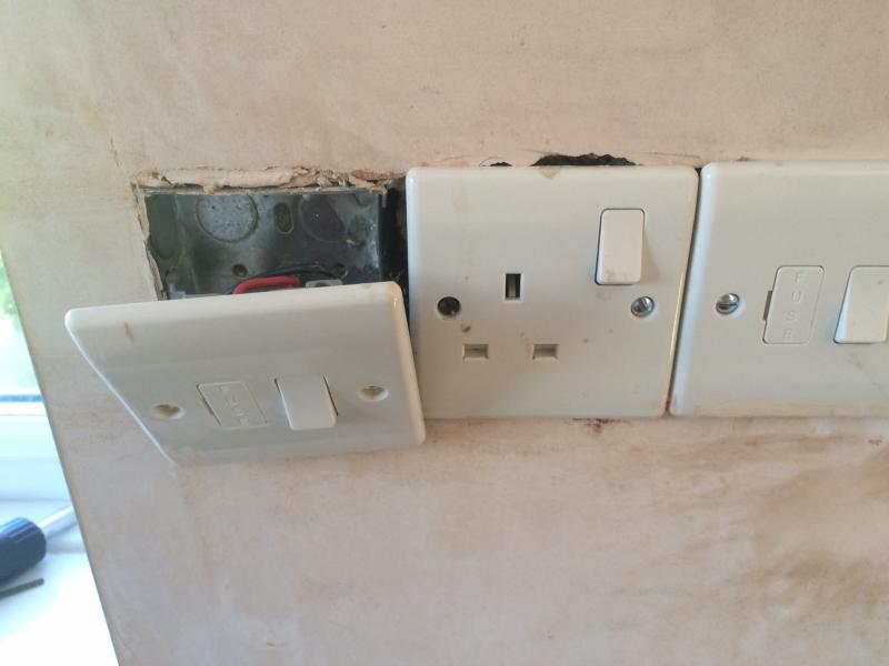

Electrical socket is live but nothing works in it?

Yes there is a switch above the worktop to turn the socket on or off. I did consider if this could also be the cause but everything worked fine until I unplugged the washing machine from the socket, so I'm presuming it's something wrong with the socket as a previous poster said, the heat damage to the wiring.

It may be that the switch opens and closes the live, but leaves the neutral open - which means a knackered switch.
Try a new switch.
Also could be bad/loose connections at the switch.
As was mentioned earlier, any burnt, black copper and burnt insulation needs cutting off and re-stripping.
Only shorten knackered wire, no point shortening good wire.

Followed a previous poster's advice and cut back and stripped any damage wire to bare clean copper, wired everything back up in the new socket i bought and still same problem happening- socket appears live but nothing works in it.
I've attched a couple of pics of the isolation switch for the socket that's located above the worktop in case anybody has any other suggestions on if this might be the cause rather than the socket underneath, otherwise i'm going to have to get a sparky mate in and give him a few quid to sort it all out.
You may well need an electrician. However, if you were comfortable doing it, you could temporarily bypass that switch by (with all the usual safety precautions) putting both black wires into one of the N terminals and both red wires into one of the L terminals. If the socket then worked, it would indicate that you need a new switch.

Well well. That isolation switch looks like a switched fused connection unit. As you have a fuse in the plug a second one is not required so get it replaced with a real isolation switch at the same time.
If you have fixed the dodgy line connection under the worktop and replaced the switch above it and it still does not work, you need to check the feed to the switch for the machine.

AIUI, the OP has sorted out the dodgy wiring at the socket, but has not replaced the above-counter 'switch' (which, as winston has pointed out, appears to actually be a SFCU)
Sleebagz: have you checked (or replaced) the fuse in that above-worktop 'switch' (which actually appears to be a Switched Fused Connection Unit)?

I can't say for certain that I've sorted the dodgy line under the worktop, all I've done is fit a new socket and cut away the heat damaged wire to new bare copper.
I did check the fuse in the switch above the worktop and it was fine, swapped it for another too and same problem.
If it makes any more sense when I plugged the radio into the socket under the worktop the blue screen on the radio will flash for a second some times, as if it's coming on and then goes off again....?
