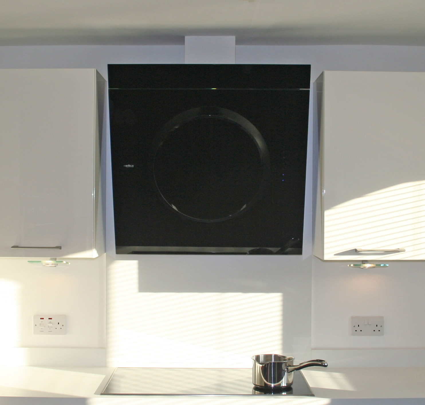

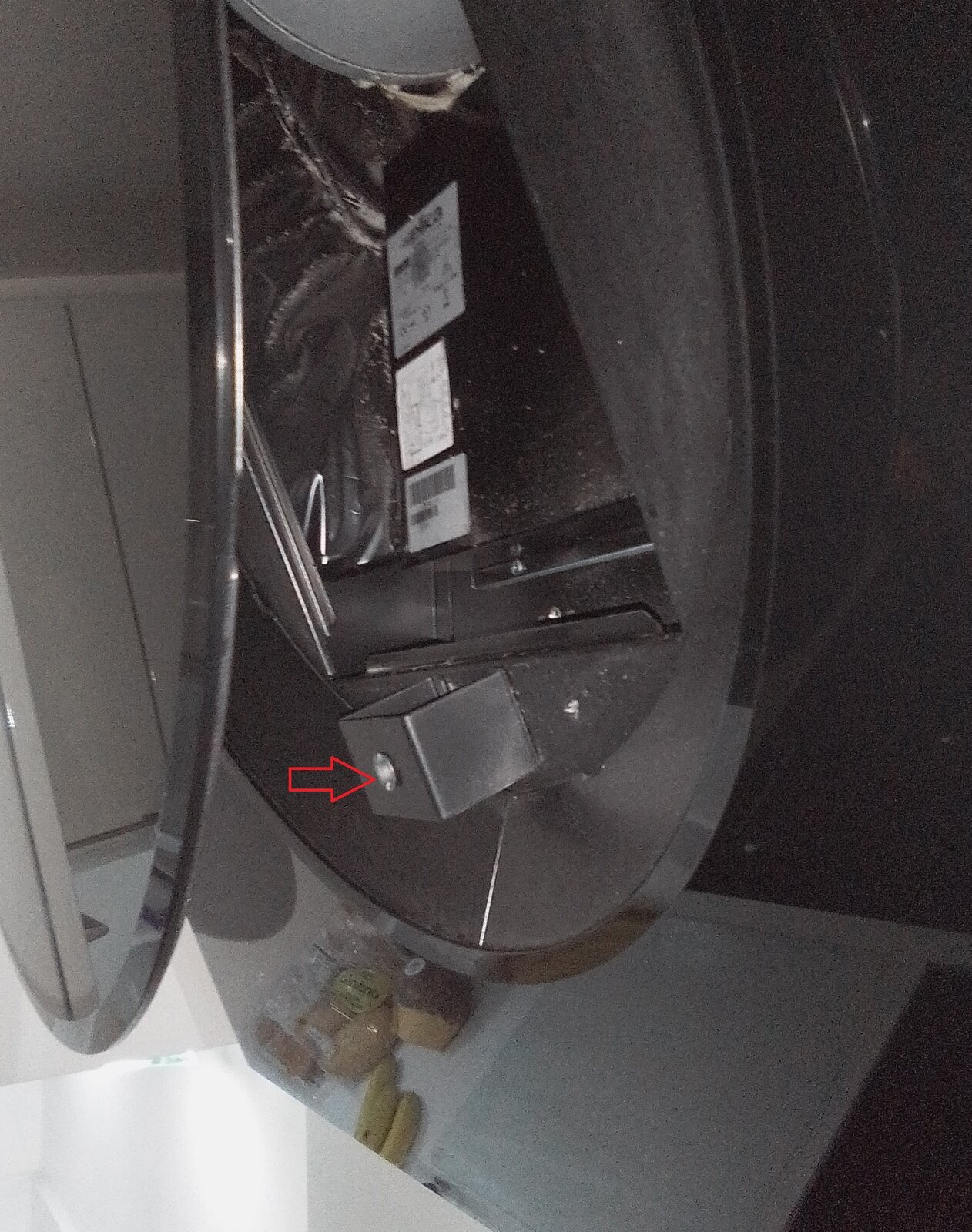

Have an Elica OM cooker hood, and parts seem a little difficult to find. The problem on mine was the push-to-release catch that secures the circular panel of glass which hinges open to allow access to the mesh filter. It started to need several shoves to get it to release.

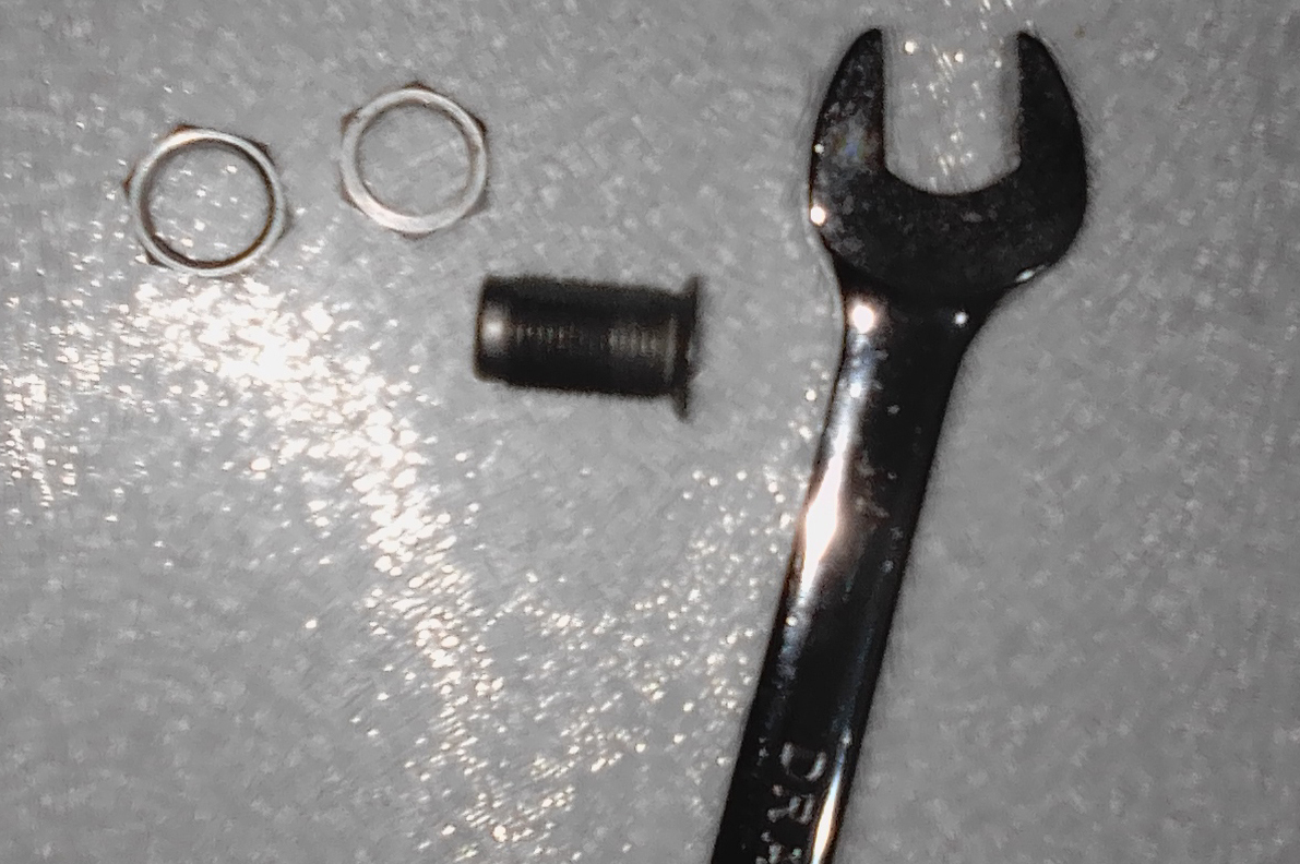

Turns out that once I had dug the item out and took a look with a magnifying glass, it had the manufacturer part number V15R13-1-1AB on it which helped me find one as they are used in other industries such as aerospace. Just needs a 14mm spanner and a bit of fiddling about to loosen the securing nuts behind its mounting bracket.
