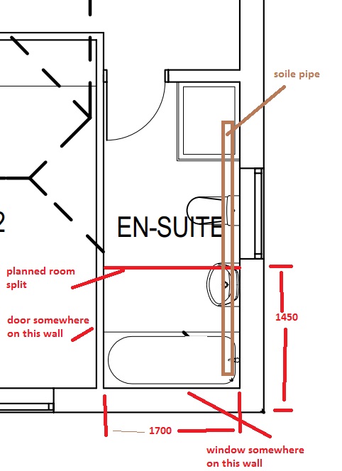

Bit crowded cos I was trying to work out sizes but that will work. The soil stack will have to run under the window on the outside wall to meet the other section unfortunately. That is your only way if you want a 1400 shower.

Thats was muted as an option but I dont want a stack on the outside.. it would be quite visible in my back garden. The shower doesnt have to be 1400.. I just didnt want one with doors and runner n stuff as they get all sh1t up. The idea of a walk in with minimal profiles, no door or runners appeals to me.

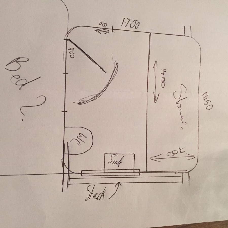

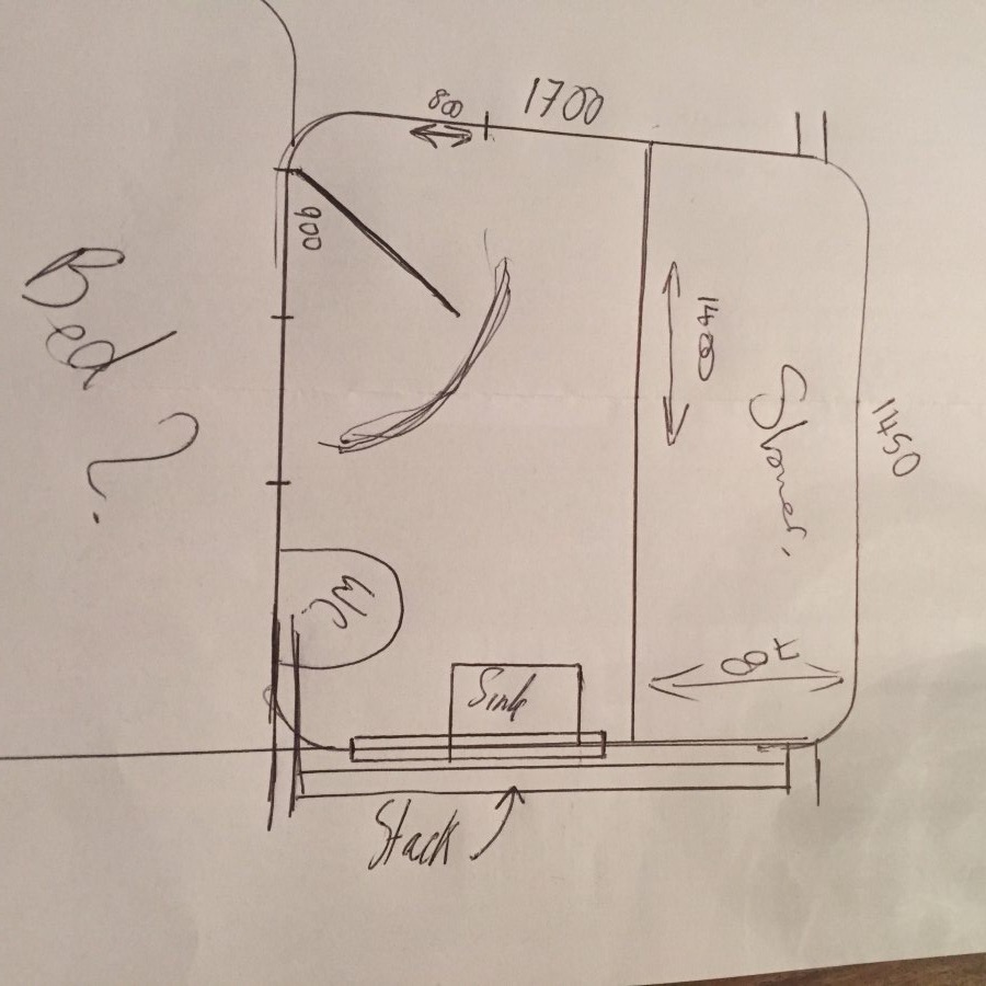

Ive confused you m8, the stack runs along the 1450 wall.. see the file I attached en suite ideas mark 2.jpg
I know pal, so where I've drawn the shower, the existing stack from the other bathroom will run under the shower. But to make it work, you will have to have another section of soil pipe from the toilet, run externally that will meet with the other section (bottom right hand side)
Just read your post about stack being internal, that makes it feckin awkward.

Just got yours too, internal stack makes it awkward but you'd have to go external and go back in with it, will be mega awkward but can be done. As u know you can't go through the joists, only other option is fitting a cubicle shower would give you more options.

Could use 1000x700 shower and have the toilet next to it right ontop of the stack. Will be feckin tiny tho imo
If door was opening into bedroom you could have shower full length of the new partition wall, the door next to window wall, window in the corner by the soil stack, toilet ontop of stack (almost) and the sink next to it or to the left of the door, either or. If that makes sense

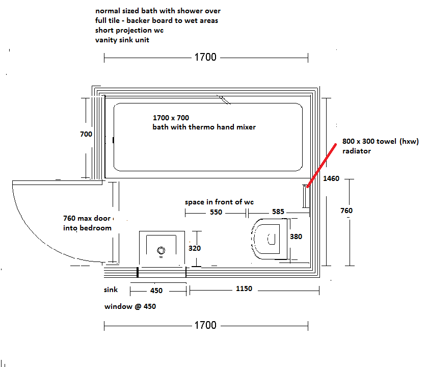

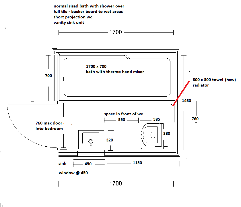

ok fella, change of tack. bath now instead of shower... with mixer tap. pic attached. thanks for all the input.

Run the soil "branch" (not stack) outside and you can have the ensuite(s) you desire... they add value to a property... visible branches do not detract from it!
Make the waste work the easiest way possible and enjoy comfort living from the inside without worrying about what you see when you look up on the odd occasion... that's what I'd do!
