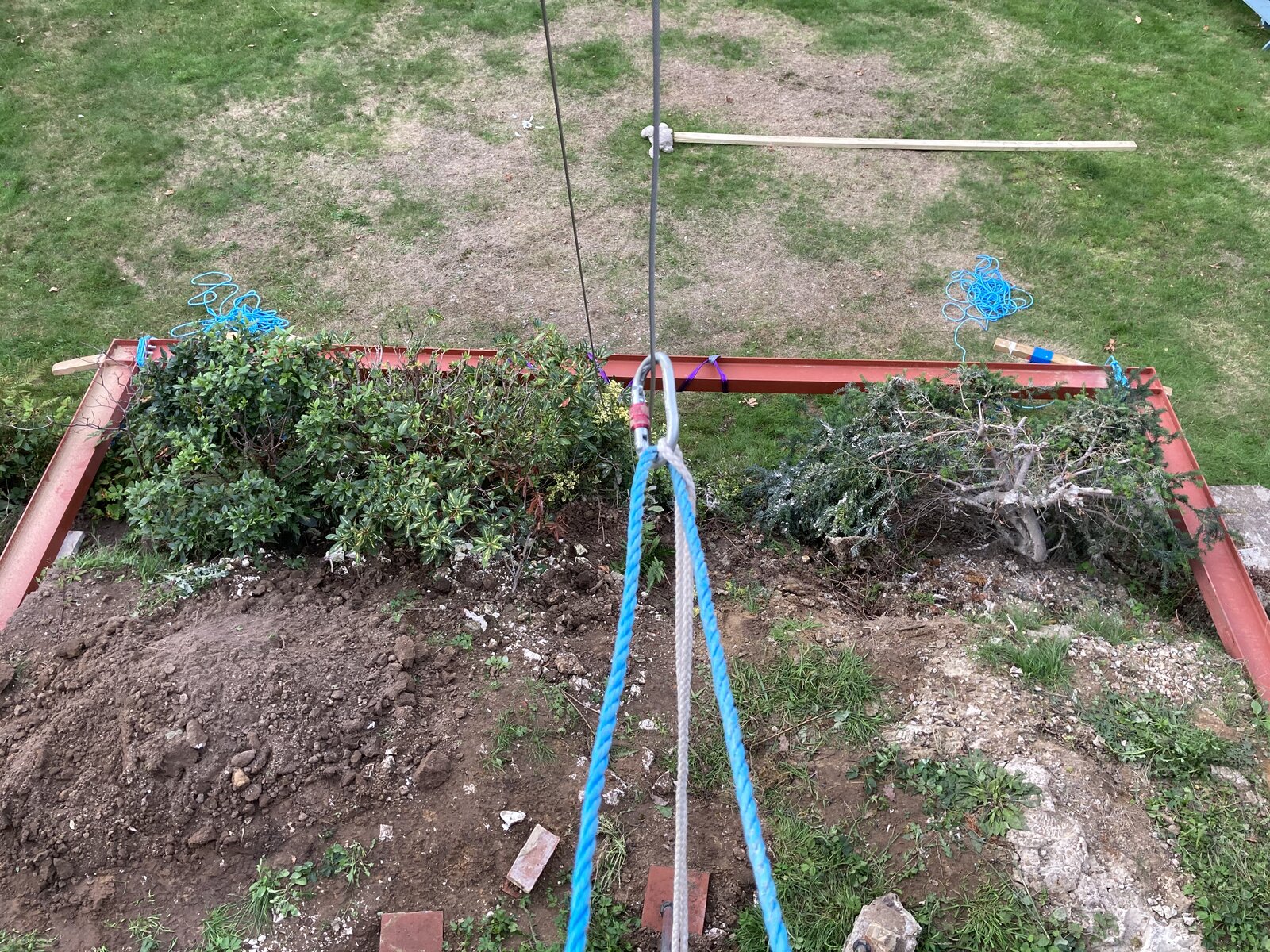

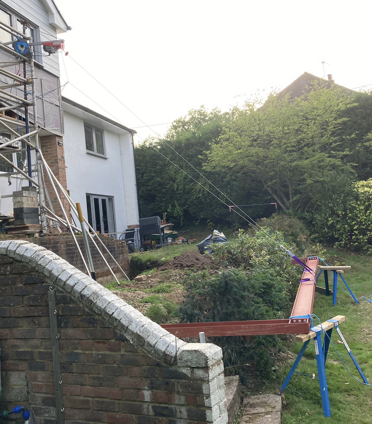

Well, the first attempt failed!
It started out ok as I gashed together a crane from a scaffolding tower, acrow prop and rope attached to the house.
However, the good ideas club kicked in and I decided to pull it up majestically into place from the opposite direction suggested above. A silly idea it turns out as the electric hoist is only designed for vertical loads and the limit switches kicked in after a few feet.
Rethink required.

It certainly is. Are you aware that scaffolding towers are not designed to rake sideways loading (it might even be in the little sheet the hire company provided)? The job requires something like a sheerlegs or portable gantry - and is more than a one man job
