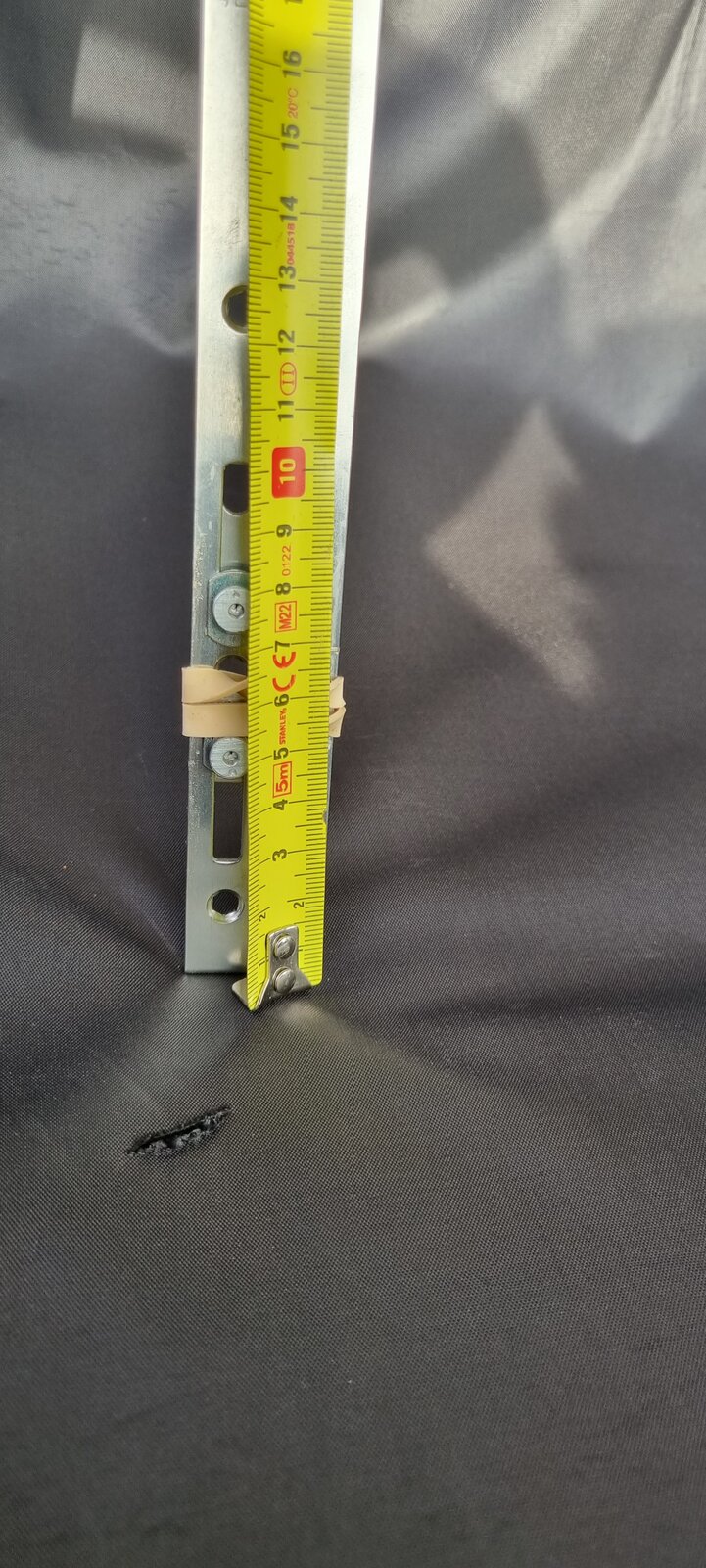

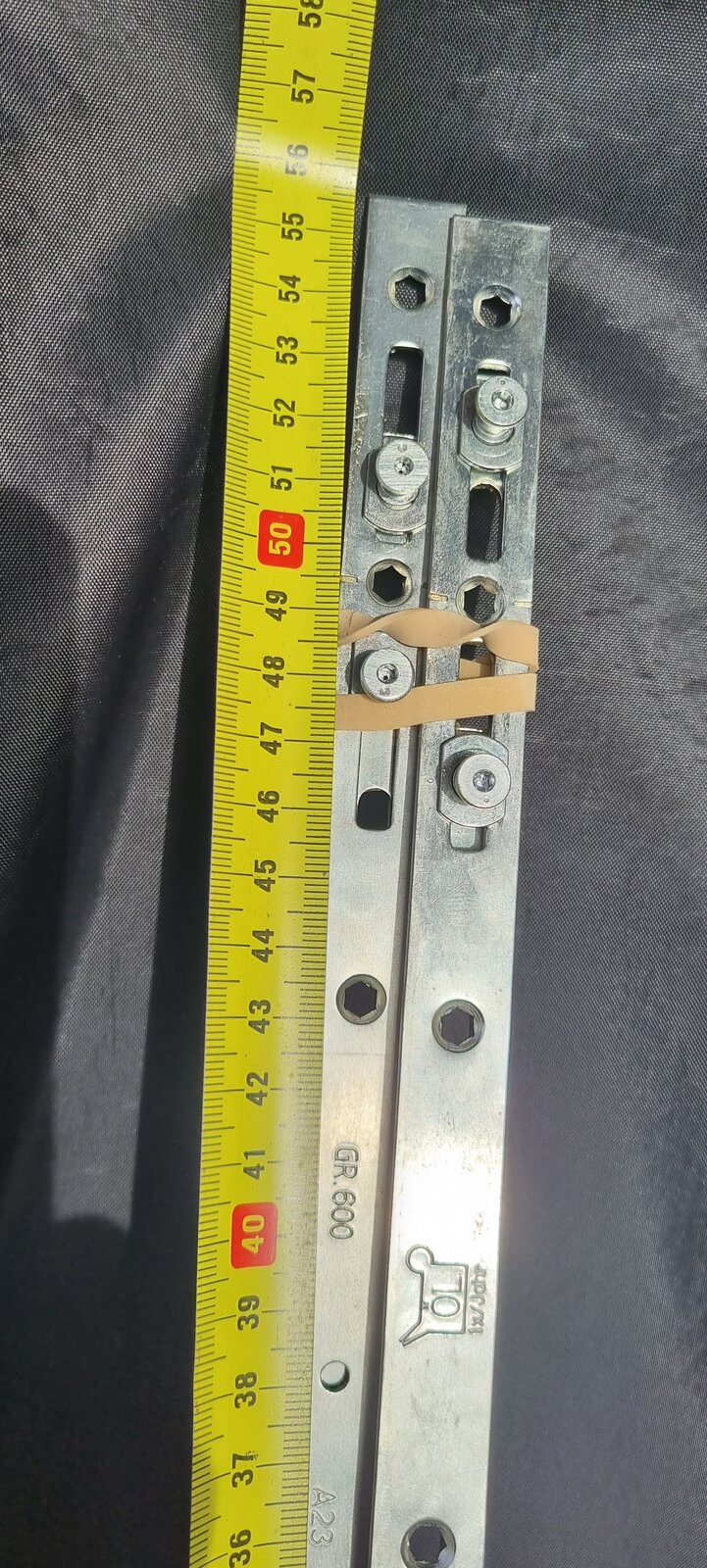

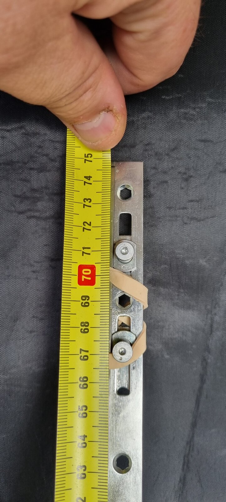

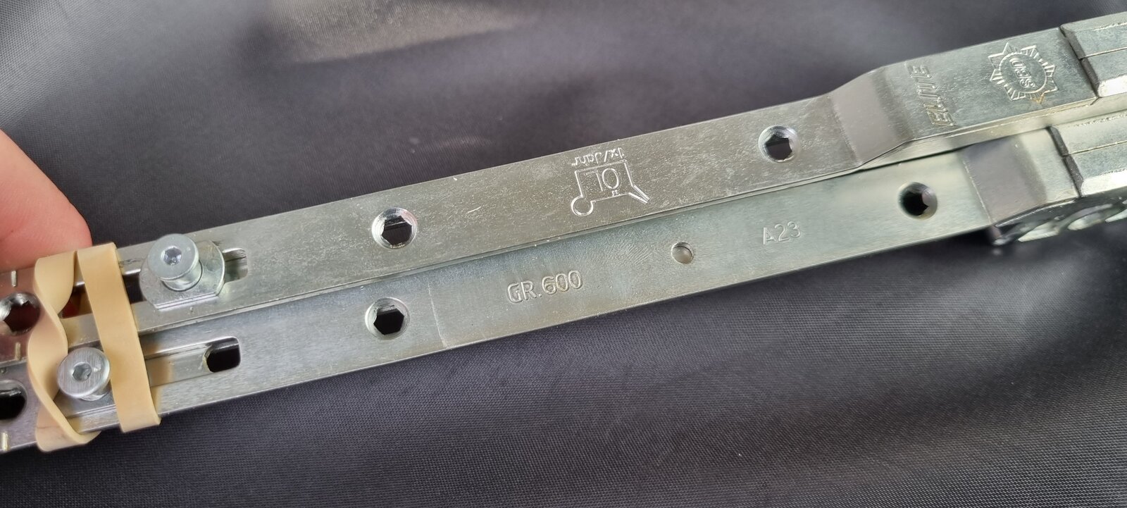

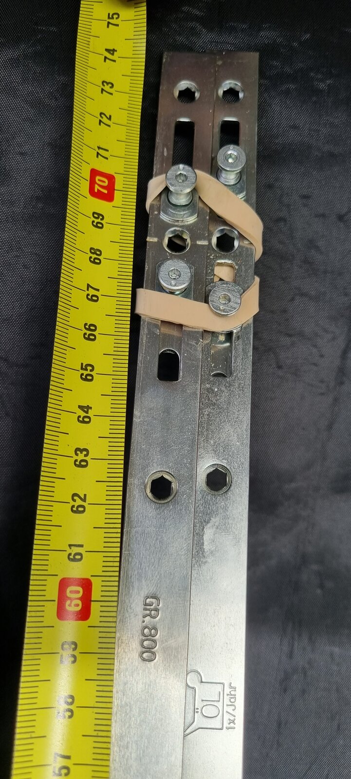

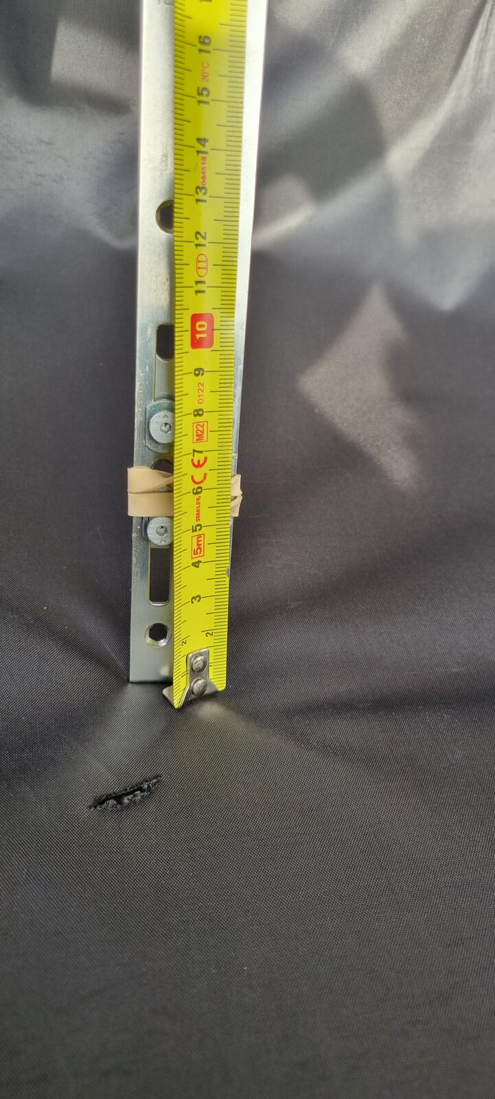

Hi
Does the length of a replacement Espag matter? I know I need a 22mm inline but the current length is 750mm. Seen some on Amazon for £15 or so but they’re usually 250mm-400mm. They’re the only ones I can get delivered tomorrow before rain hits Tuesday/Wednesday.
Would it being shorter matter? I assume it’d still work fine if the cams line up and I can always move the stays if not. The only downside I can think of is having holes in the window but I can fill them.
Failing that, what brick and mortar shops tend to sell the espags? I can’t seem to find any. They’re all online.
Thanks all!

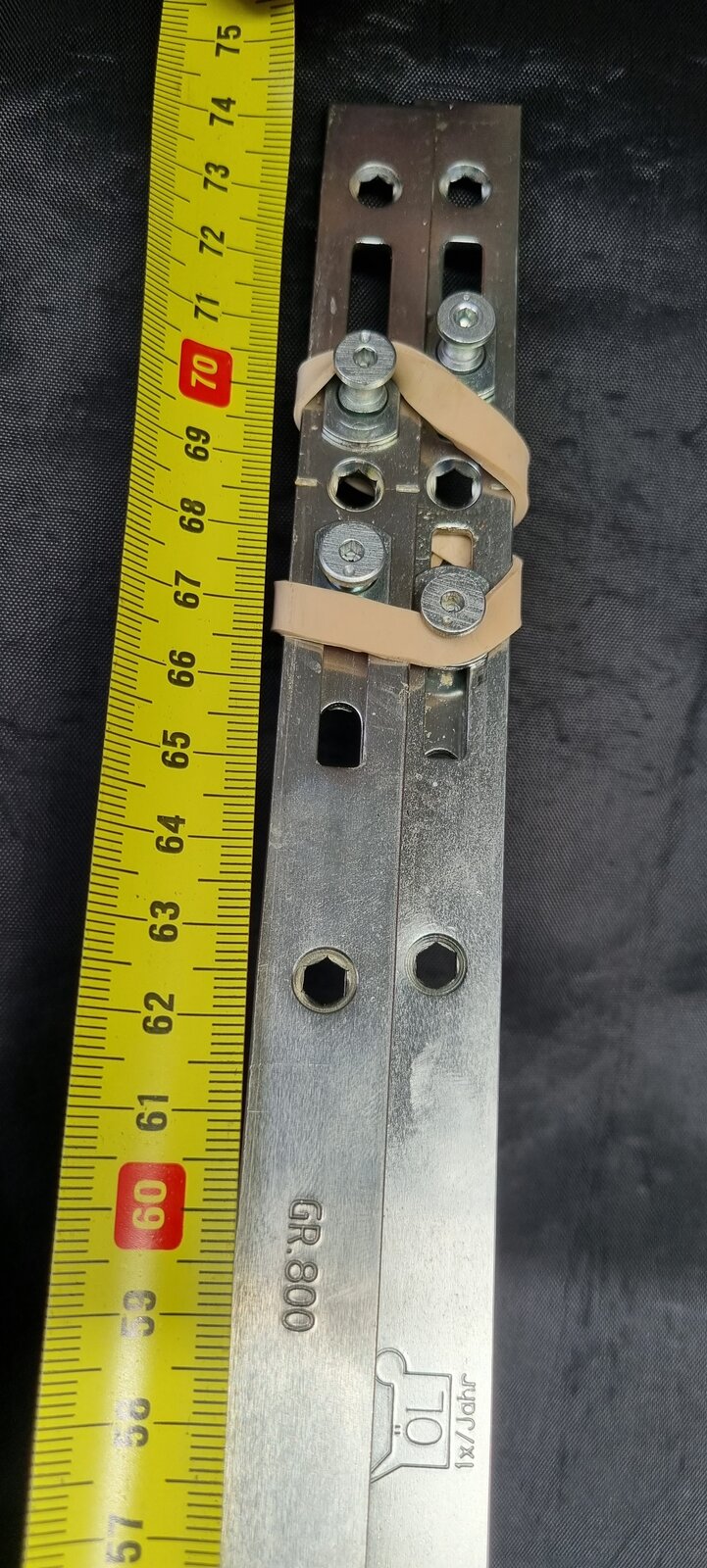

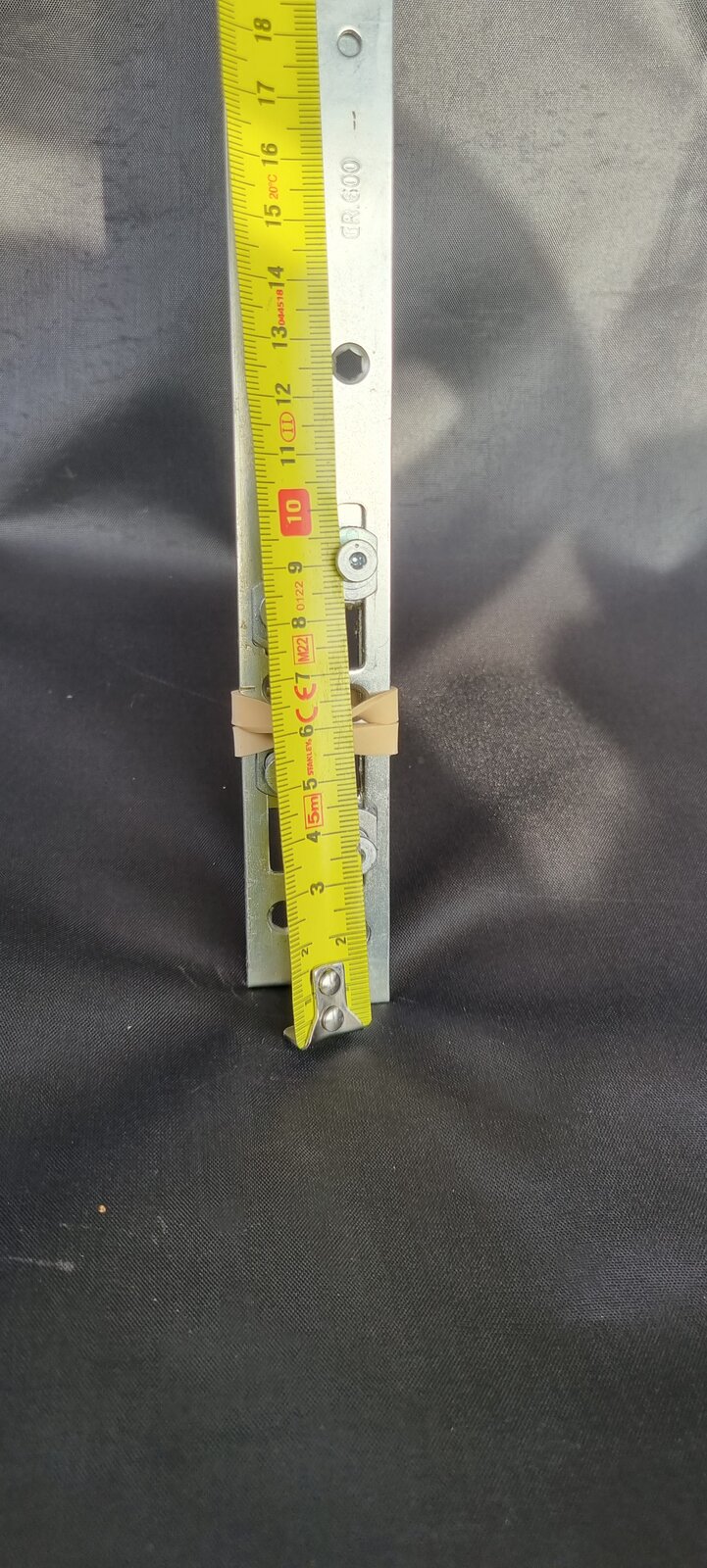

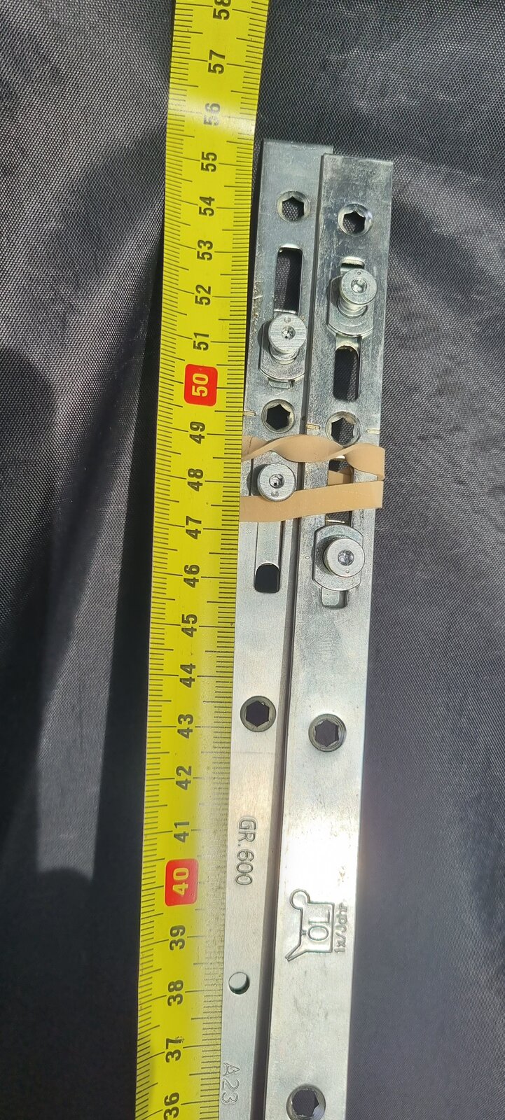

Sorry. Window is about 900mm high. The current espag is 750mm. Wondering if the 250 or 400mm would still work.
I think you mean a multipoint part for a plastic window. I don't understand how a different size will fit.
A photo would help.
There are quite a lot of parts on Ironmongerydirect

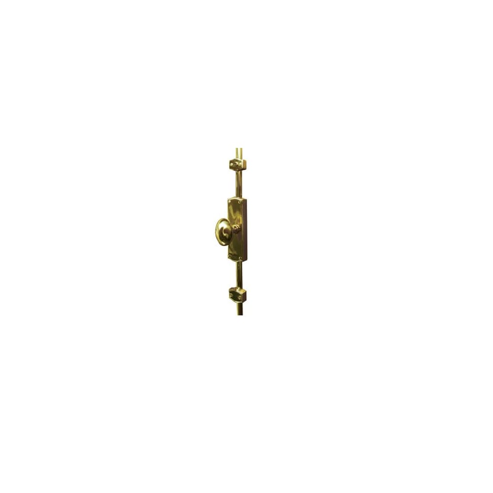

I thought they were called espags?

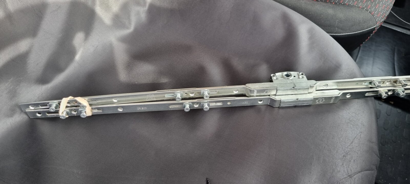

All that’s different is the lengths and the receiving part on the frame are just two metal bits that you can unscrew and relocate. So I’m just wondering if it’s just a case of filling the holes from the previous espag if you bought a shorter one.
Traditionally, an espagnolette bolt is surface mounted to wooden French Windows, with a geared handle mechanism and long bolts running to the top and bottom of the overlapping door, where they secure into the frame.
I misunderstood what you meant.

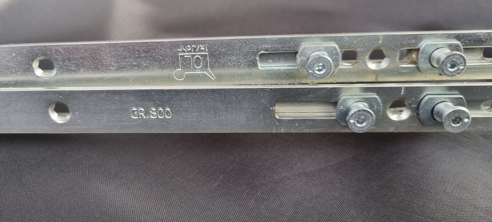

The 22mm backset is crucial but the length of the espag isn't but you ideally want to replace like for like, the shorter the length espag means the casement will not be being pulled in tight in the corners because the cams will be further inboard. You will almost certainly need to slide your existing keeps over to suit the new espag even if you fitted the correct length, different manufacturers all place cams in different positions

Yeah I thought that may have been a downside. It’s not a huge window it is old so think I’ll just have to suck it up and order one for longer delivery.

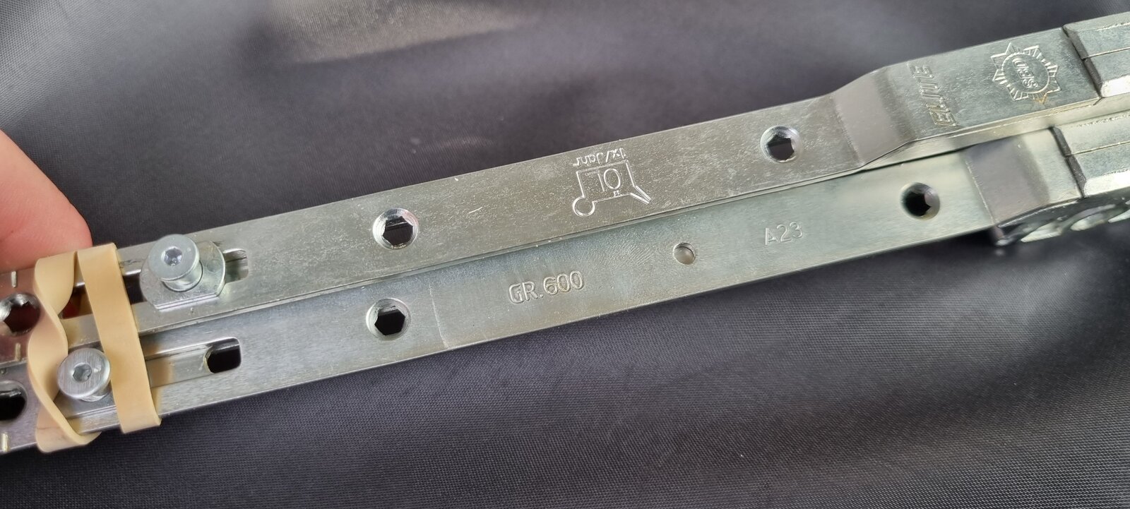

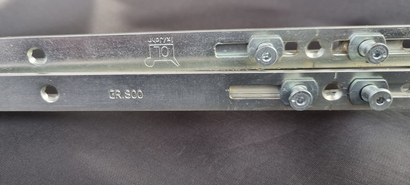

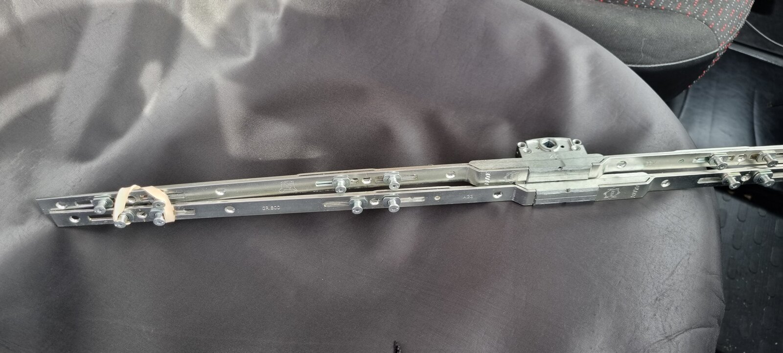

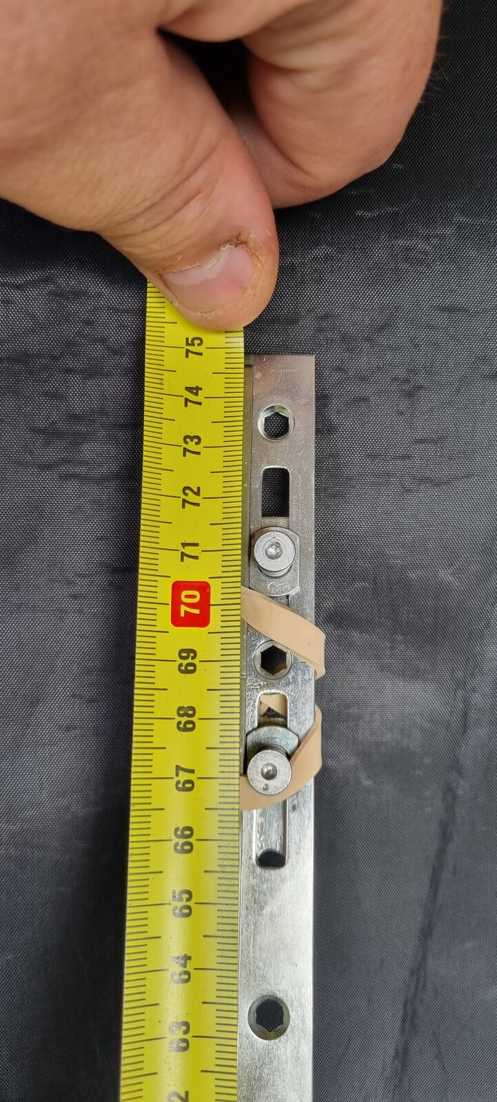

If you bought an 800mm unit, could the arms be cut shorter?
So James says he wants 750mm, but you think the readily-available "800mm" will fit?
The 800mm won't be an 800mm, it'll come as 750mm, James has no doubt measured the existing espag rod and it measures 750mm but on the websites it's probably listed as an 800mm, I don't know why they do but as an experienced service engineer I know what they mean, I know when it comes it'll be a 750mm, it's almost as though they are listing the overall casement height for you, again I don't know why but they do
Another example is a 300mm friction hinge will actually be 290mm
