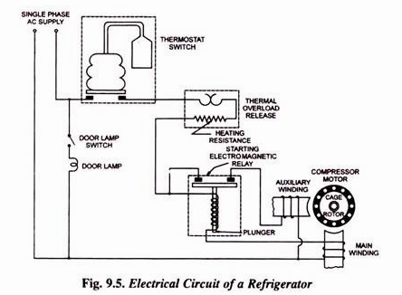

It's what they call a 'relay' - actually a semiconductor one (I assume a triac or somesuch) which seemingly turns the compressor on when so instructed by the thermostat. However, when I replaced it with a new one, that made no difference.
The other thing I replaced is a thermal switch they call an 'overload protector' which although supplied separately, actually clips into the 'relay thingy' - the purpose of that seemingly being to switch off the compressor if it gets too hot. That's what seemed to be the most likely culprit, but, again, replacing it with a new one made no difference.
However, I know about as much about fridges/freezers as you do - so who knows?!
Kind Regards, John
Not quite! I've been looking around, and it's simply a 'start relay (as I said, presumably a semiconductor one in my case), which activates the start winding of the compressor's motor at start-up.
The other thing I replaced is a thermal switch they call an 'overload protector', per one of the diagrams below :) ) - which although supplied separately, actually clips into the 'relay thingy' - the purpose of that seemingly being to switch off the compressor if it gets too hot.
That seems to be about right. The below two diagrams are typical of what one can find, the only difference being that one has the 'overload protector' (or "protractor", per the first diagram -) ) in the (presumed) Line path and the other in the Neutral Path. However, I've seen no diagrams which give any insight into how the light can go off when the compressor stops!
... none of which gets me anywhere :)
