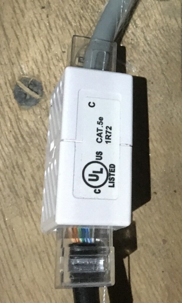

We built the house 10 years ago and asked the electrician to lay cables for a CCTV system and so he had to terminate them where he could. We didn't have the CCTV system installed until 5 years ago and so there were joints that had to be made. But at least doing it like this most of the cables are within the house build and not trailed along an external wall. Here is an image of one of the connector blocks.
I have tested the connector blocks and they seem to be O.K. I am beginning to think that the fault is either between the connector block in the attic and the camera. Either where it just goes through brickwork or actually the RJ45 plug inside the camera if indeed that is how the cable is connected to the camera. I wish there was a way of testing the circuit from one end of the cable i.e. at the NVR end. Other than that I have to get up to the camera and take the cable out and test it from there so that it would be the complete length being tested but even if I do that I won't be able to see the "receiving end" of the circuit tester.

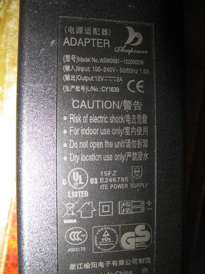

There are 2 cables that come through the wall. The ethernet cable that initially goes from the camera to the NVR (as in my diagram in #3) and the other cable is a 2 wire cable that is connected to the transformer - image below

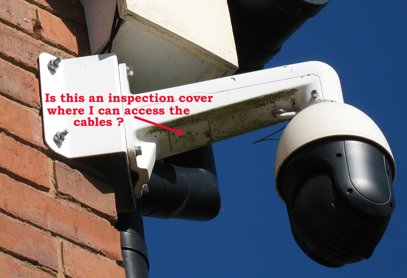

Thank you yet again for your help and patience. Below is an image of the PTZ camera that is affected. Are you able to tell me if what looks like an insepction flap underneath the supporting arm would allow me access to the connections of the power and data cables ? IMG_9040 copy.jpg
I have downloaded the specs. for the camera but there are no diagrams of the internal workings. However it does say that the ethenet connector is an RJ45. I thought that I might buy a roll of the correct cable and just put a temporary cable from the NVR, out of the door of the house and up to the camera, obviously having previously put an RJ45 connector on each end and tested them, and connecting it to the camera so that I could prove that the camera is O.K. Is there a limit as to how long an ethernet cable can be from a camera to the NVR ? That is of course as long as the 12V DC power supply is good all the way to the camera. I understand that the camera really needs power for the PTZ function and on that note if the camera is without power does it send a static image back to the NVR or would I still get the NO LINK message on my screen ?
Yes you should be able to inspect the fly lead from the PTZ and the connection to the leads going back. However I cant comment on what they have or haven't done.
