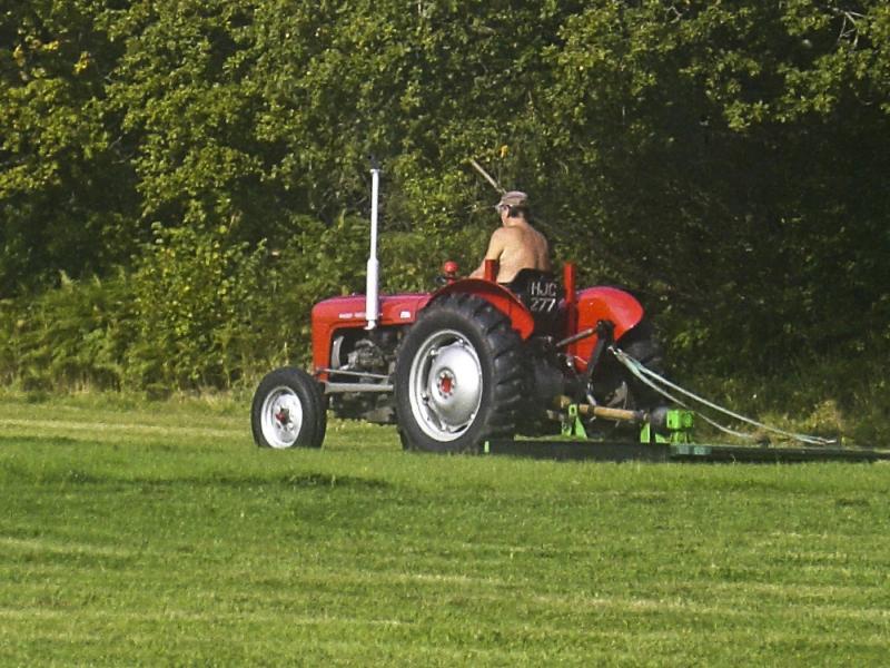

Picture of lawn mowing in Wales the old 35 was so called because that's its horse power so this lawn mower around 26kW much smaller than most lawn mowers modern one are far bigger but this clearly domestic as no role cage so can't be claimed as agricultural, neither can the school or local park as the grass is not used it's just left to rot.
However our garden waste is collected and processed by council so that is agricultural.
