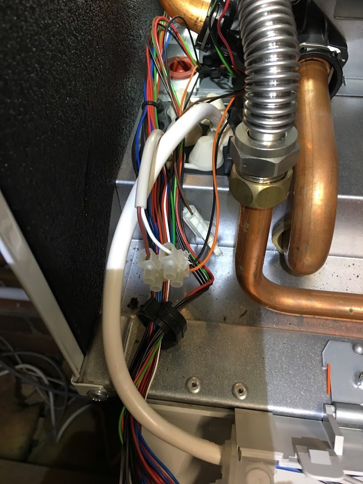

BDR91 at boiler, L&N in, L bridge to A, B to RT230, i threw the towl in for the day and got on the beers

You need to use the hot water bdr wired into the junction box to control the cylinder zone valve and the other two bdrs connected directly to the boiler 240rt connection, remove the 24v link, so you will end up with three wires in the rt , two from the bdr "b" connections and one from the orange from the zone valve.
Ahh, so the hotwater BDR also has to go back to the boiler? it was suggested that it did not and would work wirelessly to the BDR that IS connected to my boiler.
I have the evo home, all bought and on my dining table, bought from EvoHomeShop, they will not pre-configure anything and also wont offer any support for the wiring upto the boiler.
Fit the BDRs as suggested
Label one as unvented, other as CH
Both BDR L&N power up from supply at wiring centre
CH BDR switching contact must not have any power connected to then ie be voltage free, to link out the demand terminations on the boiler
If the hot water MV runs the boiler when valve calls for heat, I would utilise the orange wires of that valve as the demand pair to run the boiler for heating as well as hot water
The HW thermostat will need to be bound to the evohome (wireless) and HW BDR (which will have been harried to the wiring centre) assigned then CH BDR assigned else it will get screwed up. Follow the manual word for word.
The bdrs are just switches between the evohome controller and the boiler, one bdr controls the zone valve for hot water which turns boiler on through the end switches in the zone valve, the other bdr controls the heating by simply switching the boiler on when a trv calls for heat, as said you can do the wiring from the junction box.

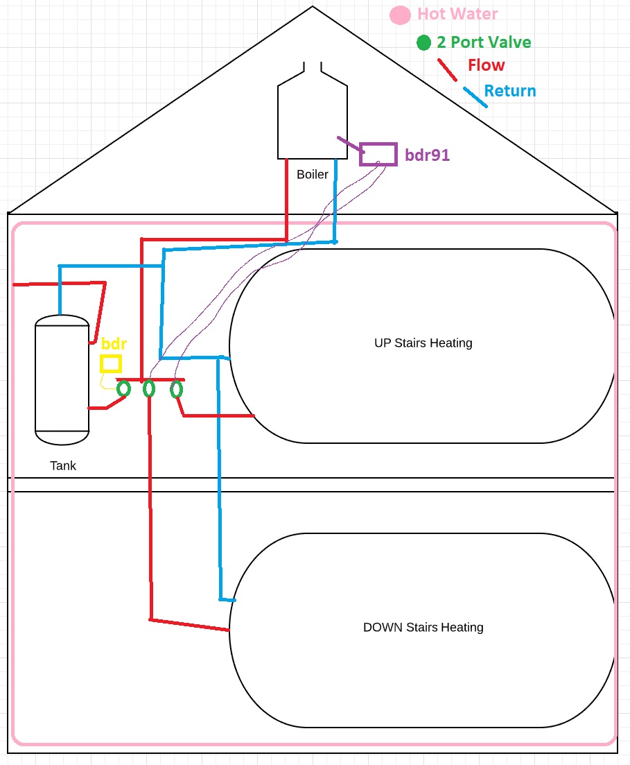

This is my layout, every rad in the house bar two Towel rads will have HR91/2's,

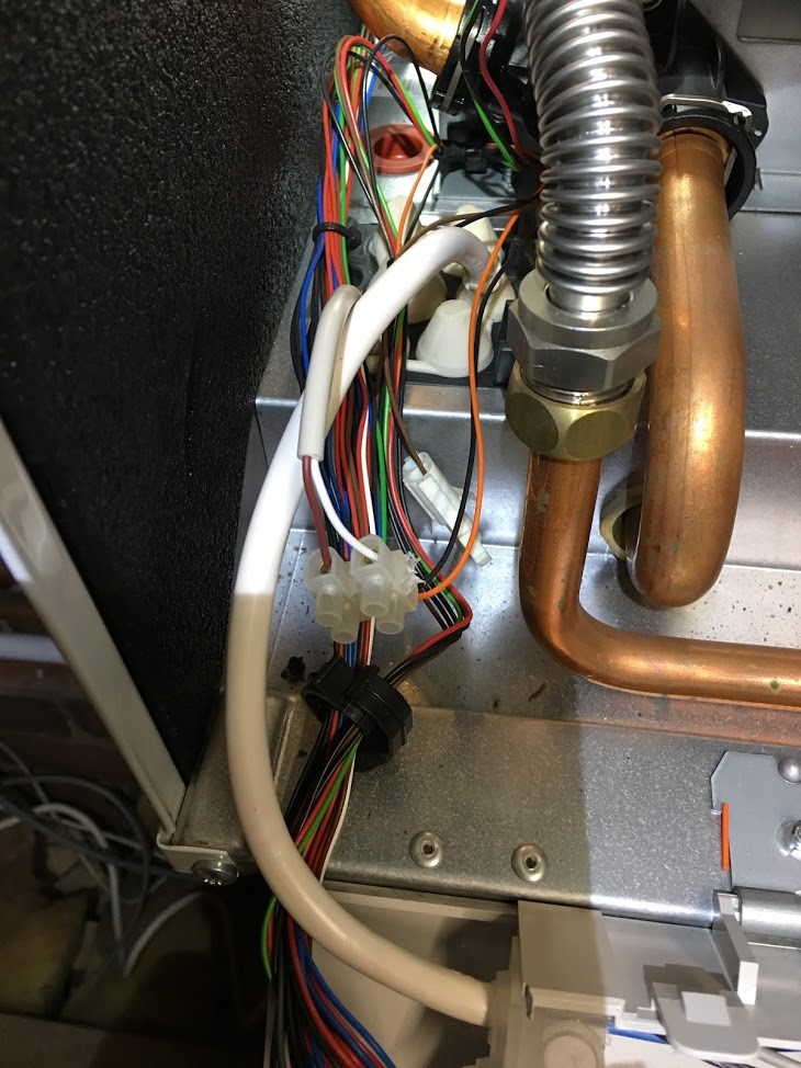

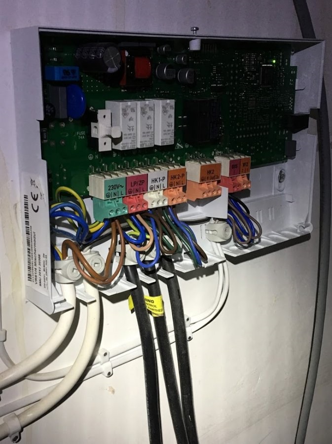

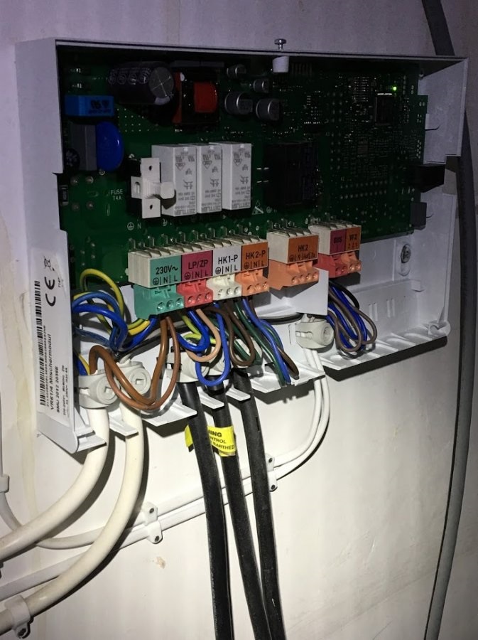

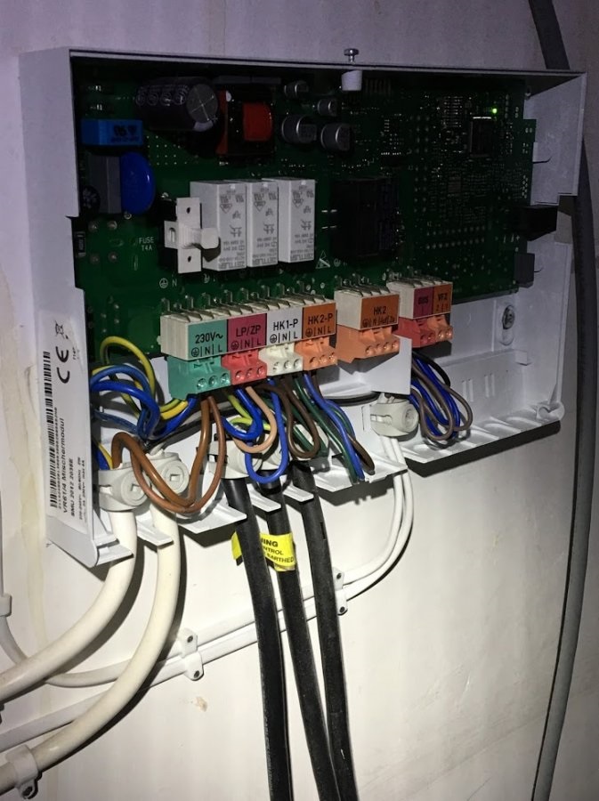

So here i am removing the 470F wireless controller receiver from the front of my boiler, removing both 24V RT and BUS. I am taking 230V RT to BOILER BDR91 B and two cables FROM B to brown on UP and DOWN 2 Port Valves.
Here i am going to remove the VR61 by taking the L/N/E from the fused spur to disable power to the VR61, remove all valve cables from LP/ZP, HK1 & HK2 - VR61 is deadddddeed now. Brown Wires from CH Valves to Boiler B, i guess N & E can be joined to mains from spur?
attachment.php
If i am not mistaken this has taken care of CH and DHW remains. ?

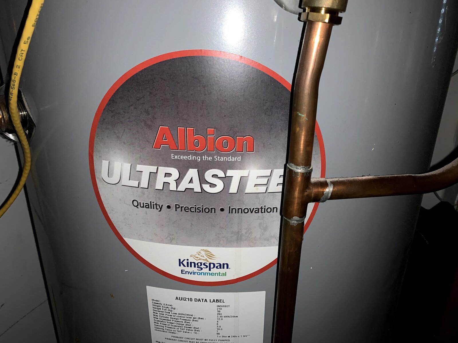

Here we go, take two AND an addon.

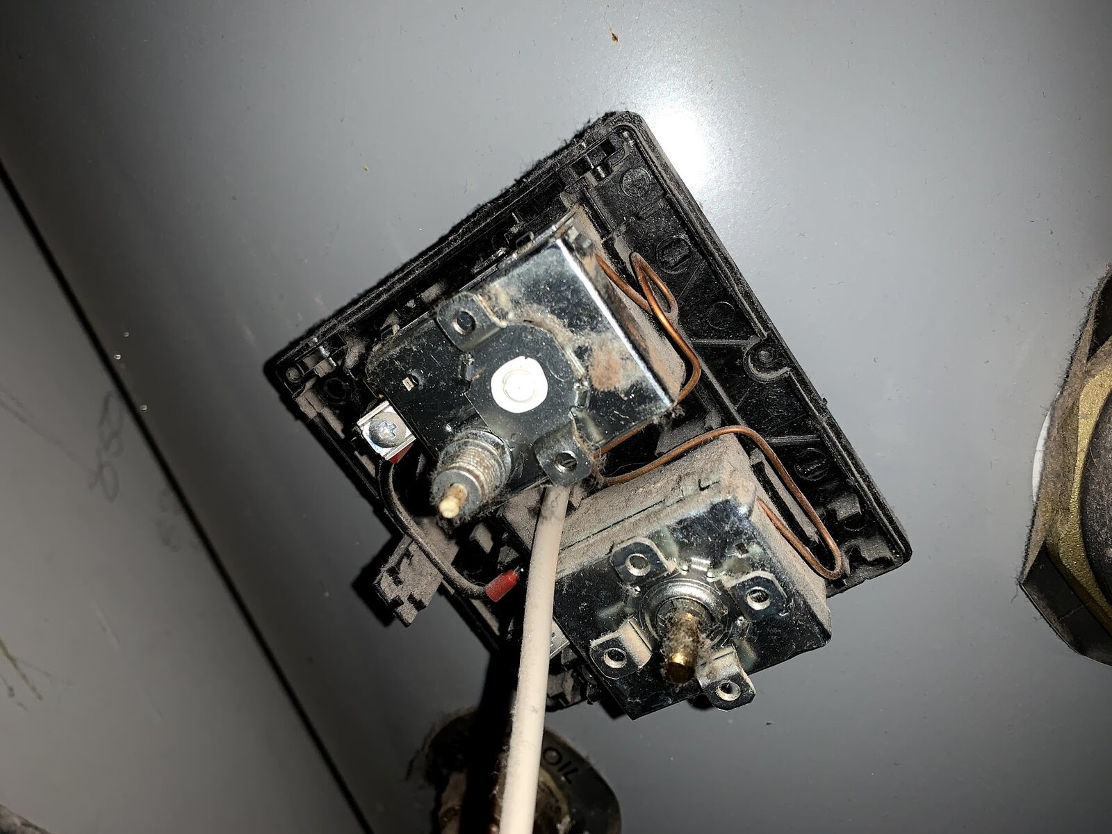

Up until this evening i didnt really know much about the engineering and control of the cylinders, still dont really.
I have A Kingspan Albion UltraSteel 210Ltr Unvented Indirect cylinder:
https://www.fueltankshop.co.uk/kings...cylinder/p5431

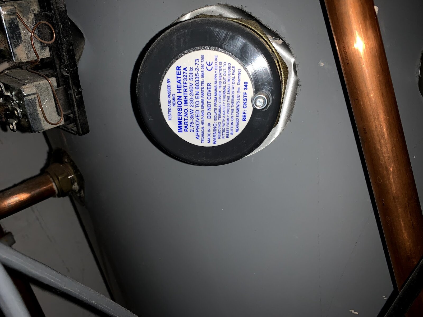

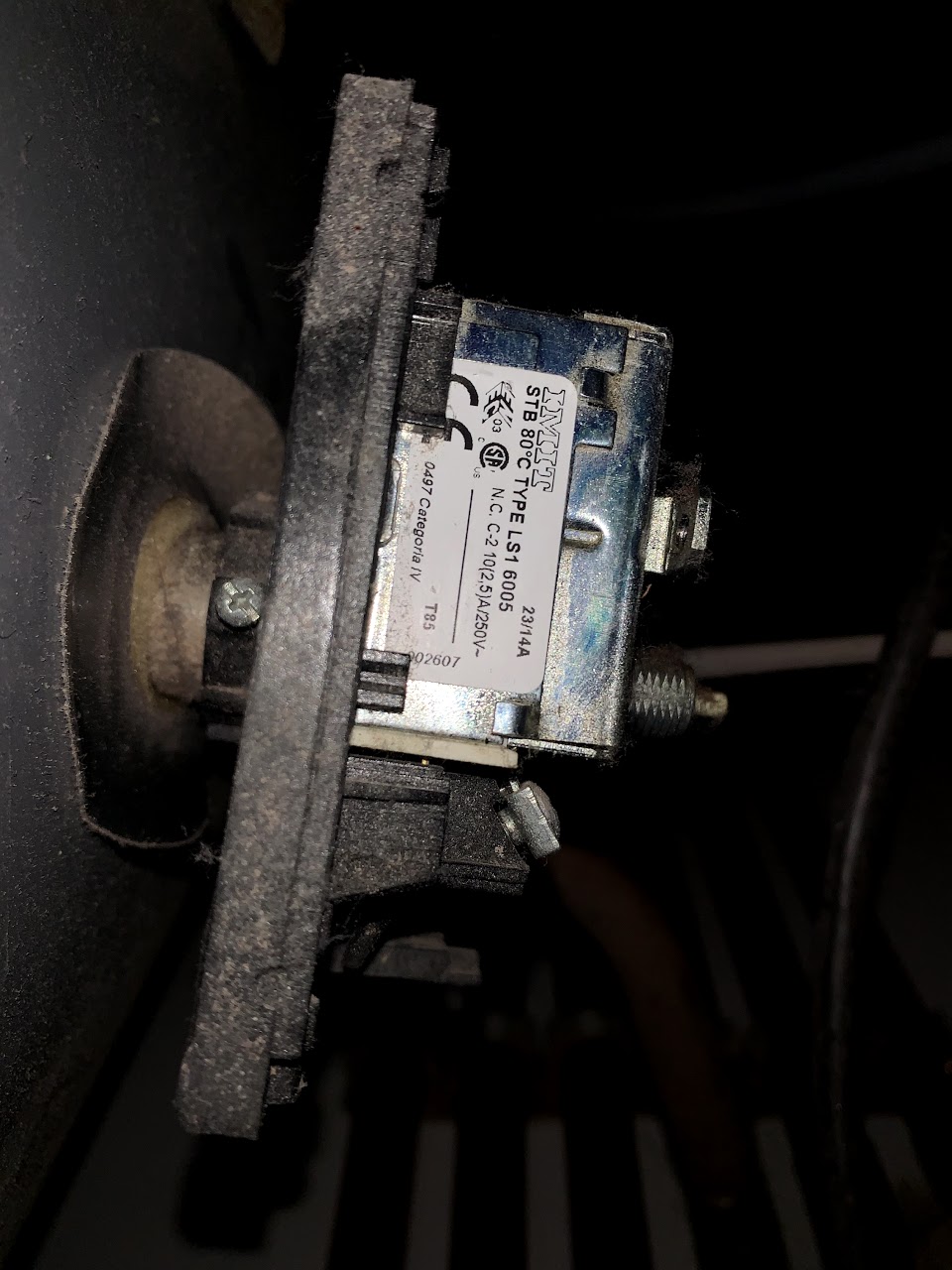

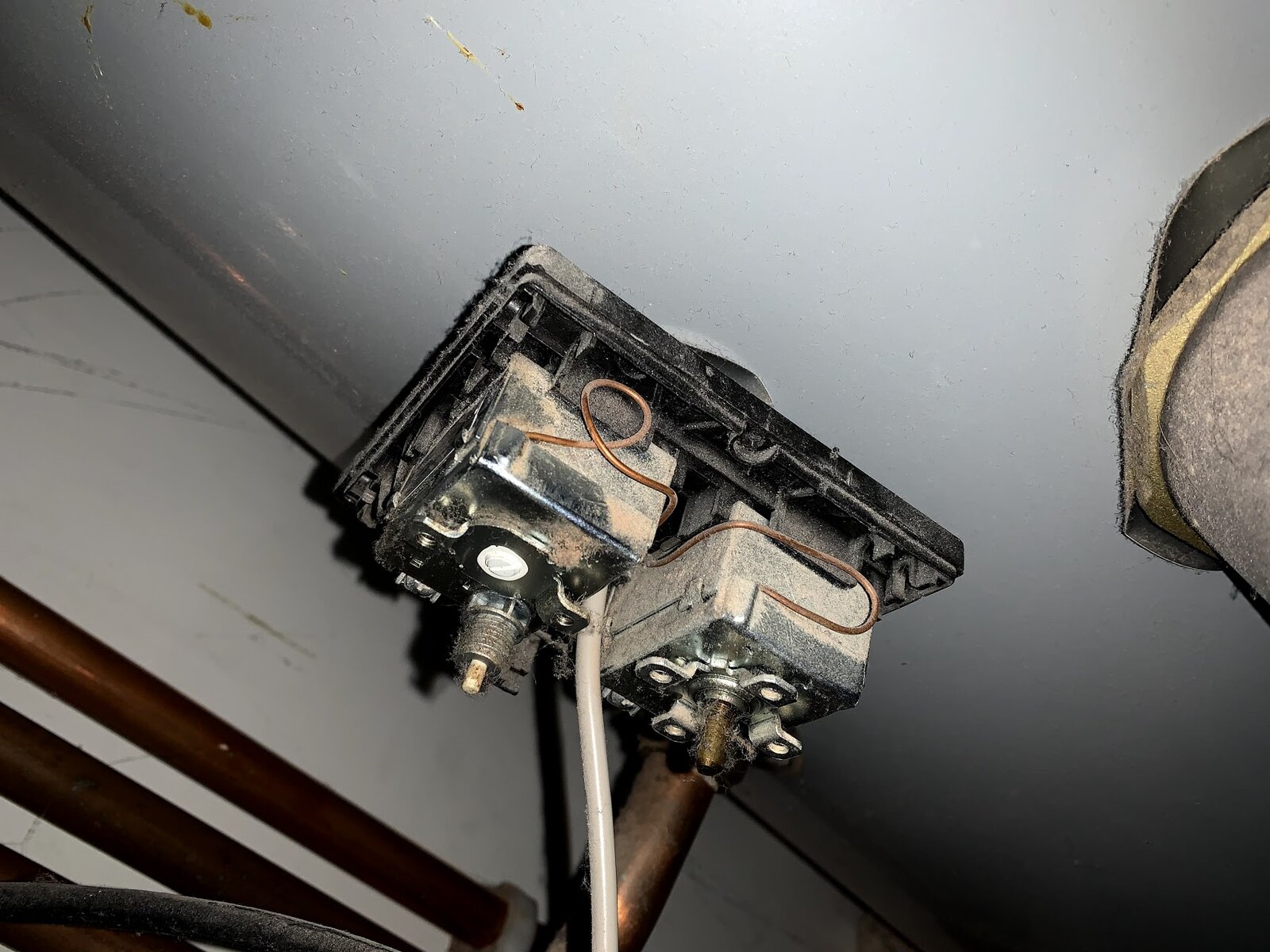

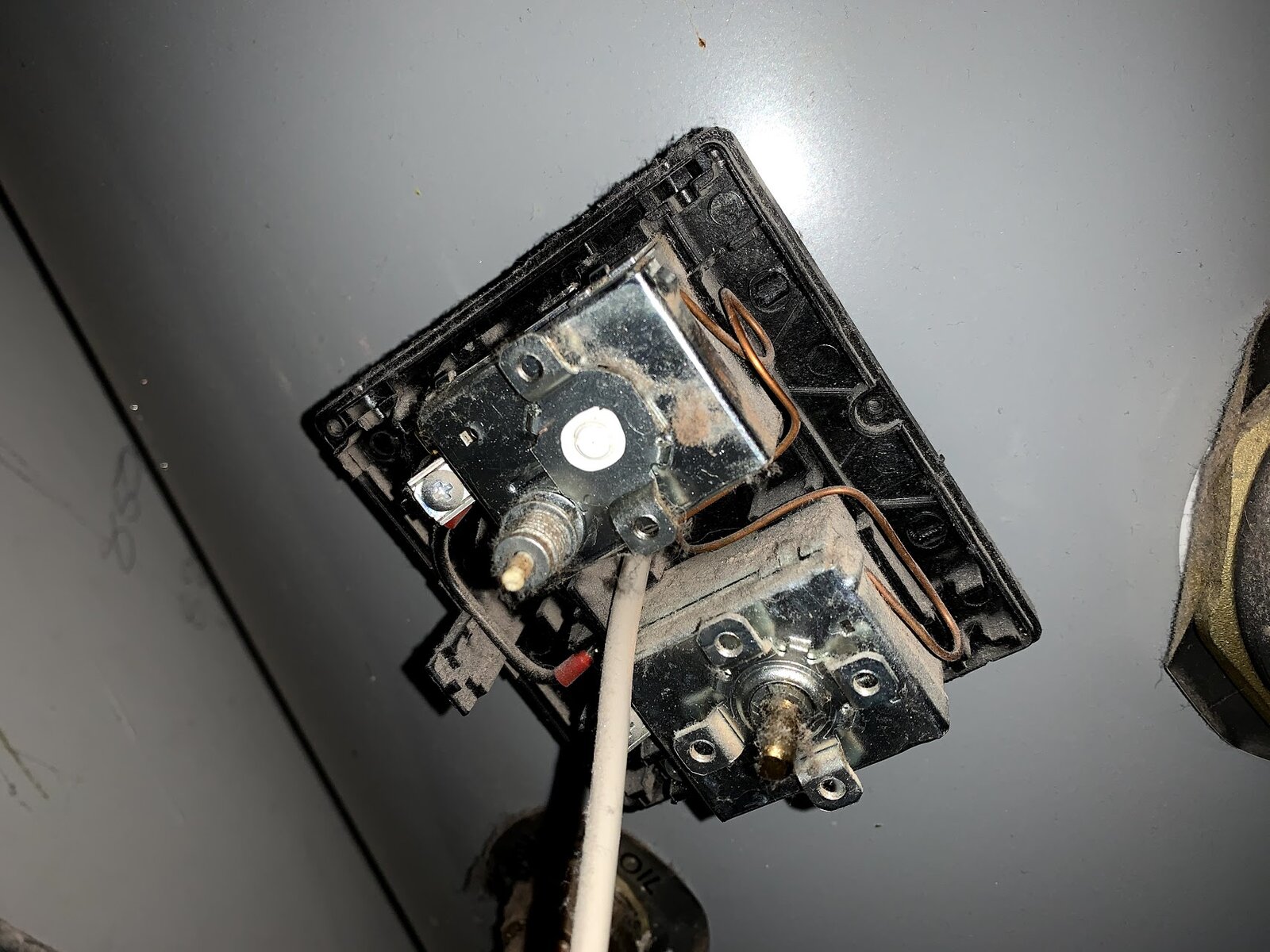

It has a Codice – Dual Combined High Limit Thermostat & Control
https://www.unventedcomponentseurope...ol-542794.html
Kingspan part number - STATDUALALTP
The cover has never been on this device since it was installed and the immersion has never been wired up either - is this something i need to do / have done? will it help things?
So i suspect i have a copper pocket that my aforementioned stat sits inside i have not traced the white cable coming from the DHW Stat just yet, do i need too? i THINK it goes directly to my Boiler and connects here:
the chocblock
With all this in mind, i am ever so slightly lost now so any help will be received with great appreciation.

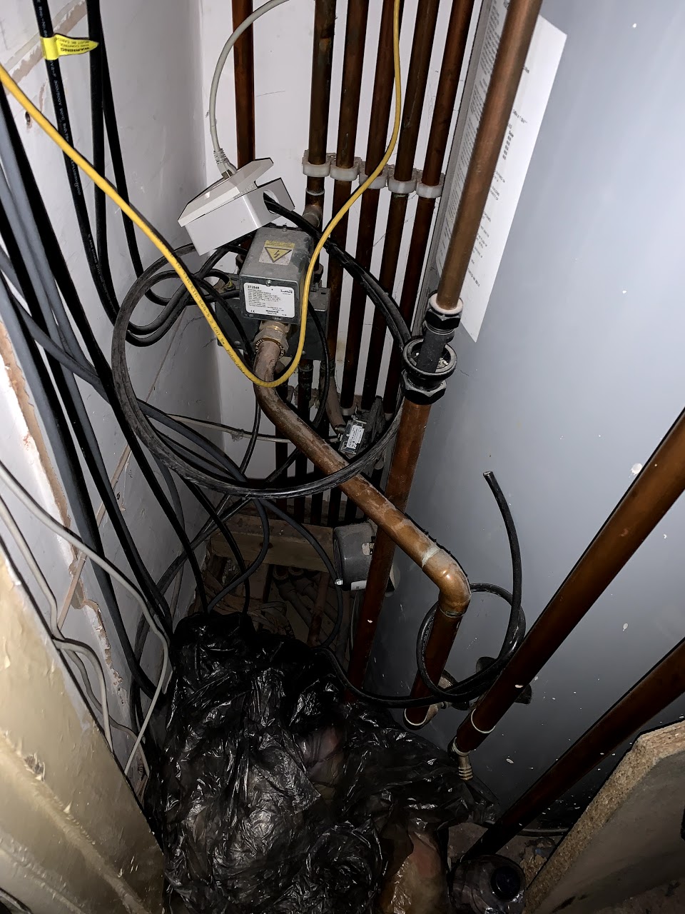

OK, for starters this wiring centre needs to go. It's part of the old eBUS system and won't work with Evohome. You need a new standard wiring centre.
Your cylinder thermostat looks like it's never been wired in either, which means it's not providing the safety overheat function required by Building Regulations. The wire coming out of it is a temperature sensor which reports cylinder temperature to the boiler. Again, that's part of the old eBUS and needs to be removed. Leave the boiler wires in the choc block, they'll be fine there. You can un-mount the cylinder stat, withdraw the sensor, install the Evohome sensor in its place and reinstall the cylinder stat. You'll need the cover for it though, as when you wire it in there'll be 230v in there. If you don't have the cover, The Evohome Shop's sister company, The Intergas Shop, can sell you a safety cutout stat.
I'm afraid to say you're becoming a perfect demonstration of why professional installation is the preferred option for this. Someone who knows what they are doing would have knocked all of this out in a day, and been able to charge everything to you including the entire Evohome system at 5% VAT, giving you a considerable saving on the cost of materials, which would have gone a good way towards paying for their labour

As already said you seem to be struggling with this, here is a wiring diagram to see if that helps if not I suggest you throw the towel in, the central heating zone valves can just be hooked open permanently and you need to remove the 24v link on the pcb.
the two red dots on the diagram show where you have to run a wire through the unvented stat (to comply with g3 regs) and a disclaimer the diagram is the way I would wire it up but I am not working on your heating system so it may not suit, the responability is yours.
Hi mate,
i am aware the VR61 has to go and also all the other Vailiant controls too. When i was taking these pics i also thought the same but to be totally honest, i didnt have much understanding of the Cylinder stat - will get the manual and wire up accordingly.
I have the cover for it, that was just sat on the floor :eek:, i guess the installer (my brother as it happens) could not be arsed to feed the cable through the grommet so left it off. Hummmmm.
I fully appreciate what you are saying about getting someone in to complete the works, i did look initially but nobody knew about the Evo Home that i contacted. Plus, i am a hands on chappy that gets excited about learning new skills and products, especially those that i am using in my home. So, i would like to do everything i can to get this working on my own with the help of the internet - after all, that is what these forums are for.
