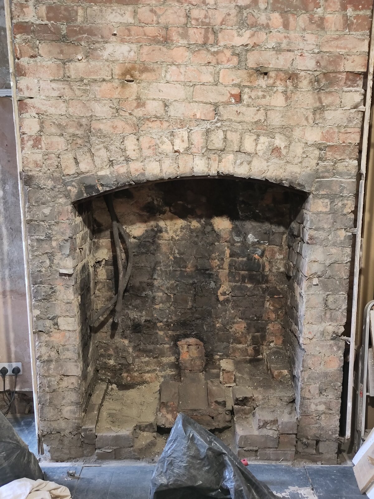

Unearthed the original fire place yesterday after it was completely bricked up. Looking for advice on how to board up completely - my current thoughts were:
- chimney sweep flue
- bung flu with balloon/insulation (cap chimney with vent in due course)
- scrub remaining soot/salts
- batten the walls and arch
- Plasterboard all over (potentially add vent at top)
- skim
My questions also are:
- Any tips on battening the arch, and curving the plaster board?
- Should I use any special plasterboard? Noting we don't intend to put a log burner or anything in there.
Thanks in advance!

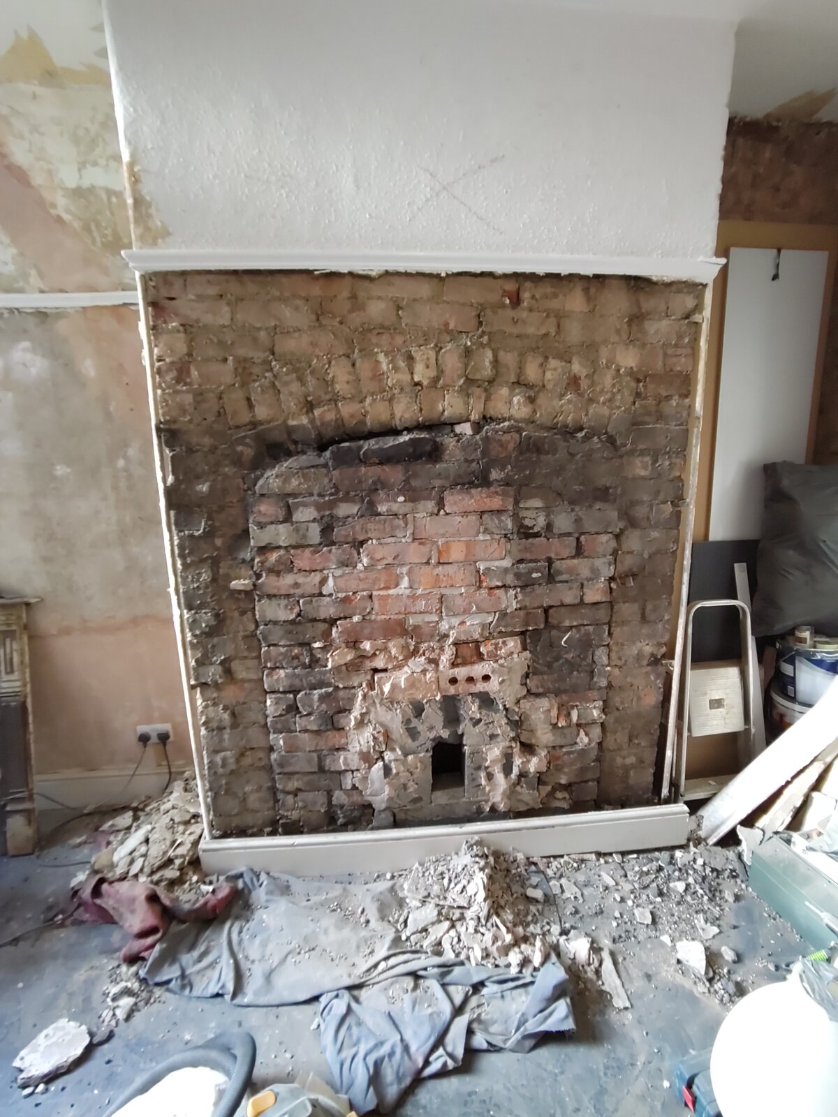

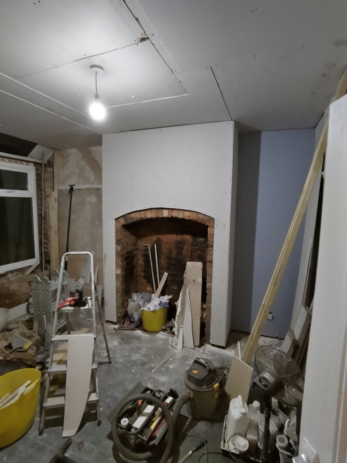

Hi @Jake2021 we've effectively just undone that work funnily enough see the photo with what we started with and what I've now done. Cheers for the input!

We're just going to leave it as a recess for storage, clean the bricks up best we can first.
I've had the chimney swept and it's already capped at the top, so going to put some insulation up to limit any draft/things falling randomly but put a small vent in below just for minor ventilation.
