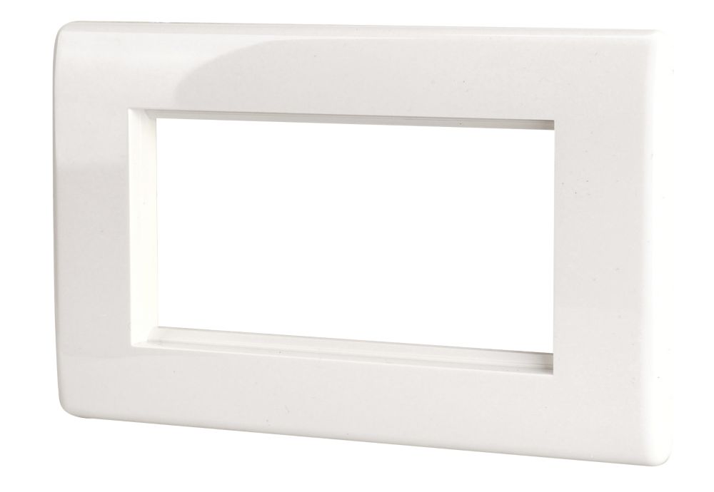

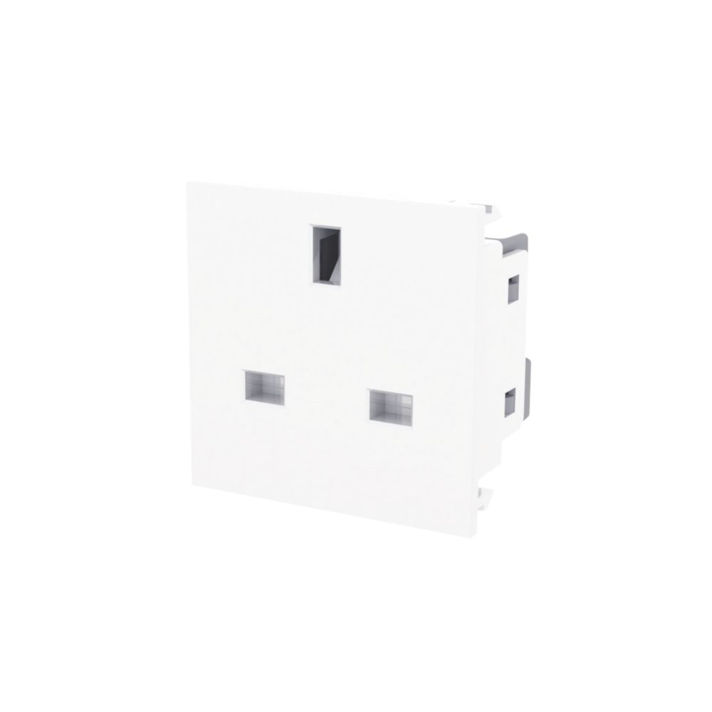

I coming from a double socket, a Screwfix LAP grid system with a 4 module plate and two sockets break the ring final nicely to add more sockets
Yes, several brands offer 13A sockets in "Euro module" form which allows two sockets on a faceplate with independent terminals.You have the screwfix LAP modules that you mention, Scholmore do them as part of their "New media" stuff, MK do tham as part of their "modular datacoms"stuff.
I see a few downsides to that approach though.
1. There are no switches, while switches aren't a strict requirement of BS7671 they are something that most people expect in a modern UK installation.
2. Euro module plates do not have an earth strap. So backbox earthing has to be handled manually.
3. I'm a little skeptical about having a mains socket held in place only by plastic clips.

I thought there was an additional requirement for the wagos to have cable restraint and that’s what was provided by the wago box. Have I misunderstood this part of it?
I’ve not come across these type of sockets. Can you provide a link please. Thanks
Yes, several brands offer 13A sockets in "Euro module" form which allows two sockets on a faceplate with independent terminals.You have the screwfix LAP modules that you mention, Scholmore do them as part of their "New media" stuff, MK do tham as part of their "modular datacoms"stuff. I see a few downsides to that approach though.
Fair enough. A good few people might not regard (1) as a problem (and we don't even know whether the present double socket is switched), and (2) is easily addressed. I share your concerns about (3), but the fact that the products are 'allowed' presumably means that the security of the socket module is regarded as satisfactory.
However, if one remains concerned about one or more of those 'downsides', an alternative, but similar, approach (but one which would require more work and more disruption) would be to replace the double socket with two single switched sockets in a 'dual' backbox.
Kind Regards, John
