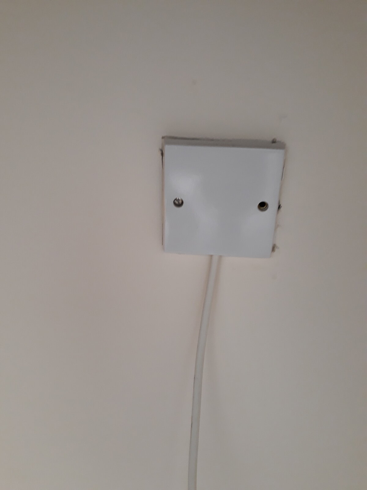

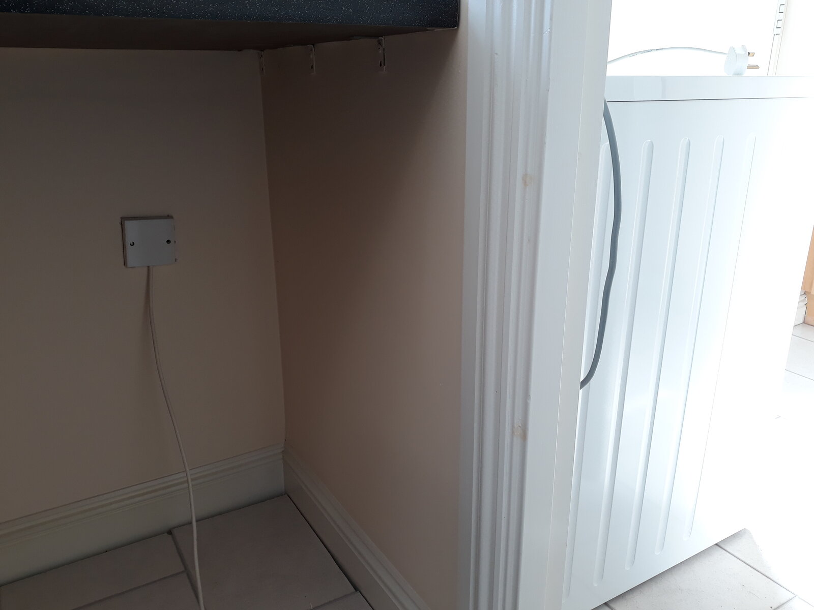

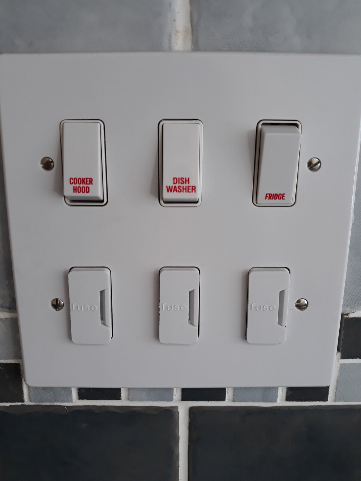

Hi
I would like to install a new socket to power a Tumble Dryer. It is just on the other side of a plaster board wall from the fridge. I have concrete floors and the only accessible point to take a spur from is the one that powers the fridge. It itself is a fused spur that is protected by a 13 amp fuse (probably should be a 3 or 5 amp!). Could I
  • Leave the 13 amp fuse at the wall switch
  • Replace the point behind the fridge with a proper socket
  • Plug the fridge in and protect it with a smaller fuse
  • Extend the radial circuit to power the Tumble Dryer
Would this meet regulations? If the tumble dryer and fridge were on at the same time is the 13 amp fuse likely to blow? I hope I am making sense. I have included pictures below.

Since fused technically you can add as many sockets as you like as long as the circuit is RCD protected, so there is no rule which stops you also powering the tumble drier, however a tumble drier is also technically too heavy to be considered as portable unless it has wheels so if over 2 kW the appendix to the regulations suggests it should have a dedicated supply.
I think very few have a dedicated supply to tumble drier, but never the less you should consider if the load for circuit is reasonable. We have no idea what cable or protection devices feed the switch and fuse plate, likely no problem, but can't be 100% sure.
The guidance (not 'requirements') of Appendix 15 says nothing about portability (or otherwise), and the "2kW" recommendation only relates to 'cookers, ovens and hobs'. The only other relevant 'recommendation' is that "immersion heaters, comprehensive space heating or loads of a similar profile" should not be supplied by a ring final circuit - but I wouldn't personally say that a tumble dryer qualifies as that. Whatever, as you go on to say, I'm sure that are very high proportion of tumble driers are supplied by a ring final, so that 'recommendation' has clearly fallen on stony ground, even if it was 'intended' to apply to dryers!
Agreed. As you have said, provided the dryer is no more than about 2kW, there should be no problem is running both it and a fridge from the same fused spur - but, as you also say, one would need to be sure that the circuit is RCD protected before adding a socket. There's no issue regarding the cable - since no credible (or compliant) cable would be unable to cope with 13A (i.e. 1.5mm² would theoretically nearly always be adequate).

Hi, thank you both for that information and advice. There is a dedicated ring for upstairs sockets, downstairs sockets and kitchen sockets. All are rcd protected. Can I assume that it would be 2.5mm2 that connects the fridge point as they put a 13amp fuse in. Sorry for my ignorance!
Yes, it will almost certainly be 2.5mm² - although, as I said, even 1.5mm² (the smallest cable allowed for a non-lighting circuit) would probably be adequate for 13A.
Kind Regards, John
