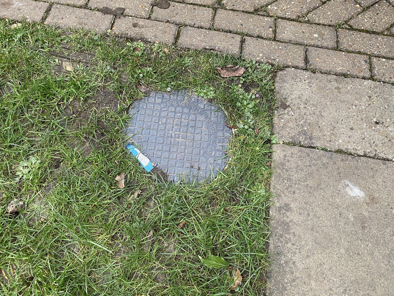

So I want to extend my driveway as I've managed to blag the neighbours old block paving which matches ours.
I have a couple of queries though if anyone can help.
1) Do I still need to put the new edge course in first? I was hoping to start from the existing driveway and finish on a whole brick meaning less cuts (existing pattern is 45degree)

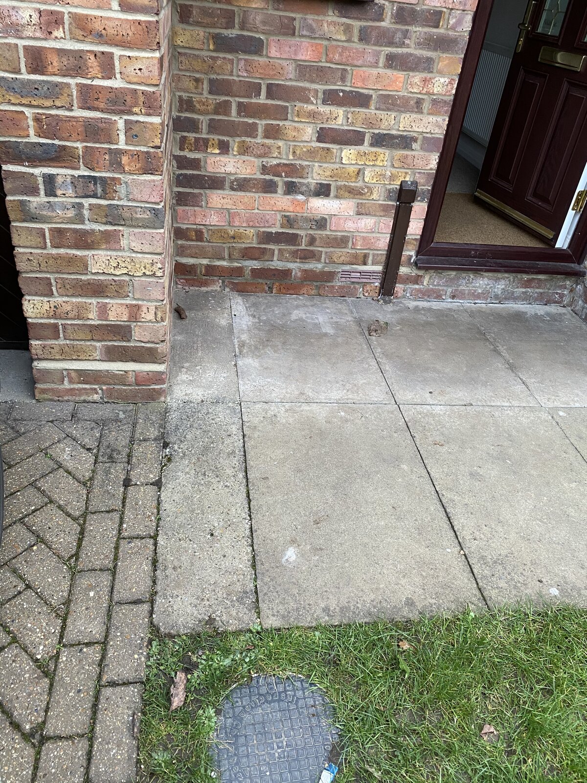

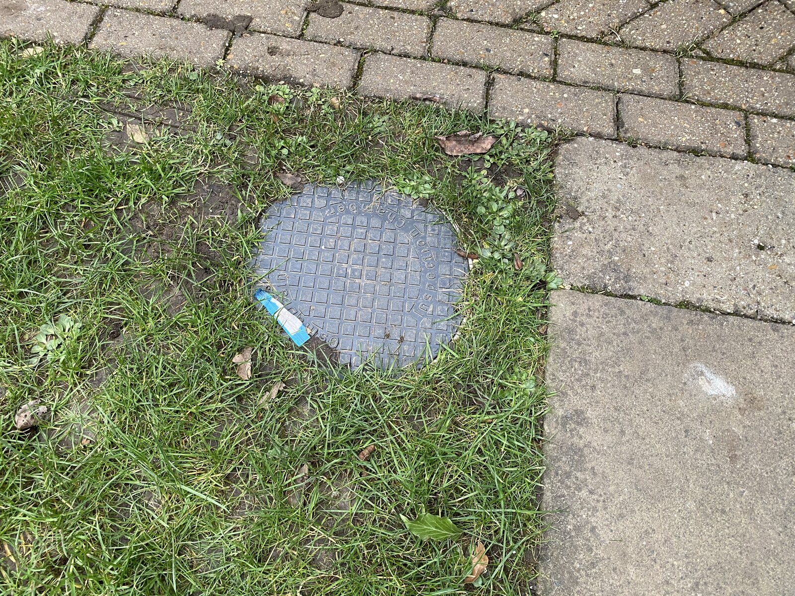

2) How do I deal with this drain cover? Can the round to square covers be used on this type (doesn't look like it to me) or do I just need to pave around it? I'm not even sure whether it will be level with the drive but it won't have a car wheel on it. If it's not level what can I do to reduce trip hazard? Just have it sloping away all sides or where needed?

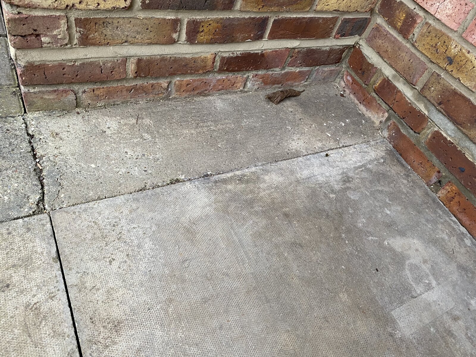

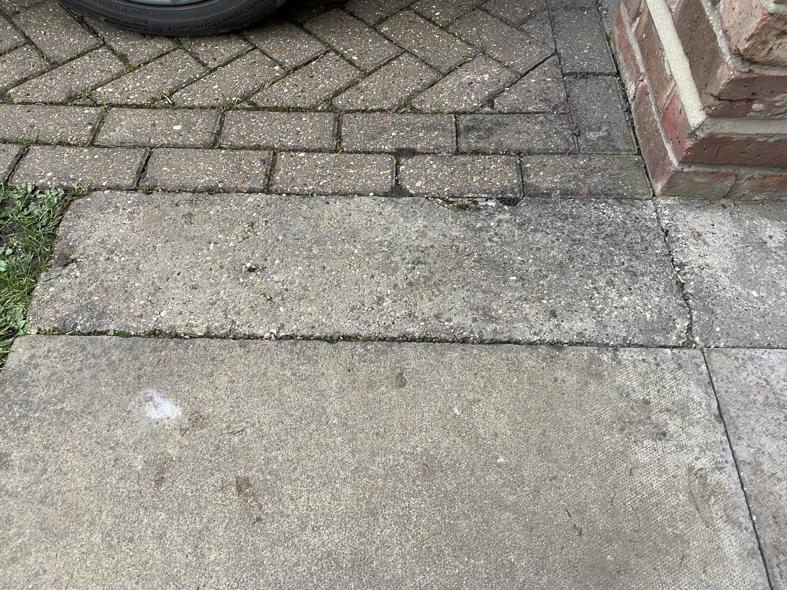

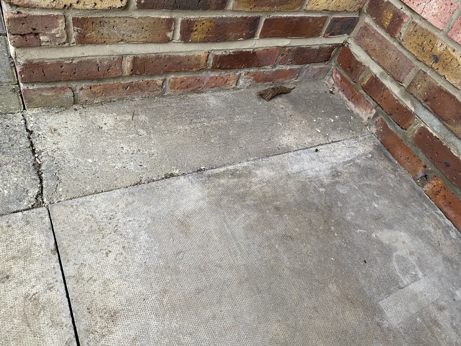

3) I have these patches of concrete next to the old pavers. How much of a concern are they? Are they concealing pipes/wires under, or was it done so they didn't have to cut a slab to fit?
Thanks very much in advance

The concrete slabs may be over cables or pipes and save lifting full slabs or they may have run short on slabs. Either way, whatever is on top will need to be lifted if access is ever required to get underneath so I think it's perfectly reasonable to remove them and replace with blocks. Having concrete between the blocks will not be aesthetically pleasing to the eye.

Lift that black cover and see which direction the service goes, could be in the direction of the concrete. Bets its data/telephone line in 1" condiut and can be dug out and repositioned when you dig down for your sub-base.
Ideally replace the black cover with a metal one and frame.
Put a level on your drive, it *should* have been laid down with a fall for rain water, just match it.

Thanks for the reply. I'm not sure I can replace the inspection chamber frame. Seems to be fixed to the waste pipework
