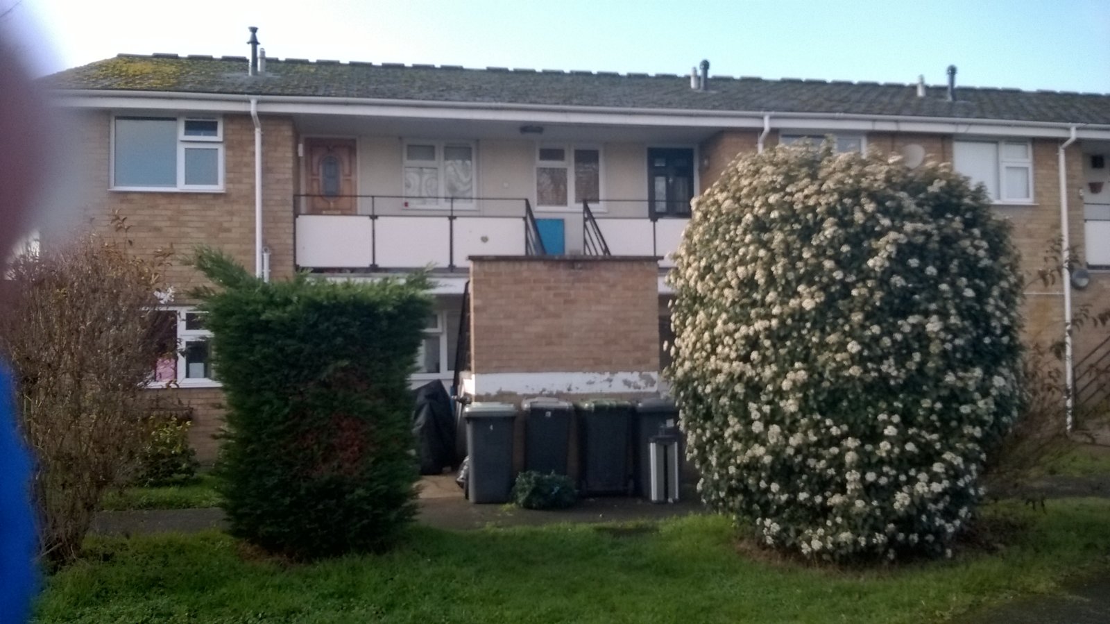

My flat does not have a communal access it has an outside staircase which leads onto a balcony up to the front door. At the top of the stairs it goes left to my flat and right to the other flat on the 1st floor. So, only the occupants of my flat use the balcony to the front door. I have enclosed a photo of the layout my flat is the 1st floor one on the left as you look at the picture.
The issue for me is knowing what the correct requirements are. I will have a look at my lease to see what it states.

That is a communal access (ie it's shared).
However, as its external access some assessors may regard it as not subject to the requirements to have a FSRA. But, as the occupants of the left hand flat will need to pass in front of the right hand flat's [Kitchen?] window, then that may mean that a FSRA should apply as there is a risk there.
In practical terms, if a risk assessment was done, as the front doors are isolated and no other resident is required to pass them to escape the building, then they would not be required to be fire doors.
