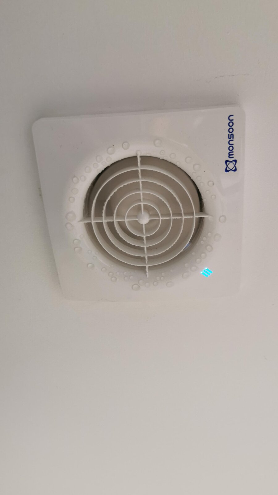

Please show us a photo of your fan. I suspect it it is too weedy.
Thats what i wondered but didnt want to jump to conclusions
I believe it to be a MONS100T which is not bad, but not powerful enough for a shower. I see it is fitted in a ceiling. If you have access above you could fit a much more powerful ducted fan in the loft. It is unusual to see condensation on the fan itself. What is above?

The listing mentions it has "with two performance settings" so I suppose there is a chance it has been left on low speed (yours might not have this). Do you have the fitting instructions?
https://www.electricpoint.com/mons100t-monsoon-extractor-fan.html

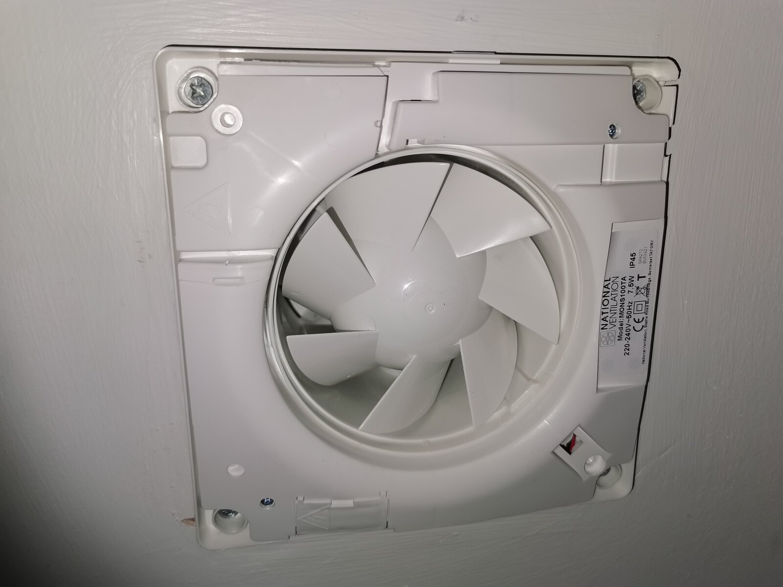

Managed to get the front grill off, but no idea what im looking at as i cant see anything to adjust

I think that panel removes to reveal the wiring connection block, and the timer adjuster.
It is not the same as the similar looking Soler & Palau or Envirovent ones.
See if you can get the installation instructions from the makers website.

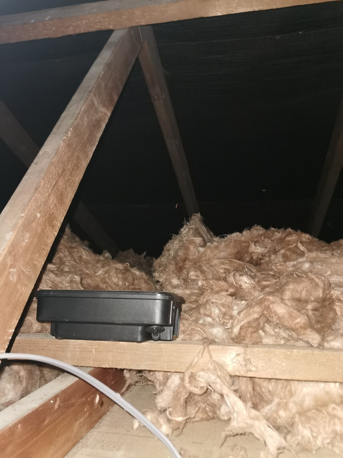

So i might well be wrong, but
Looked tonight from where i can see, the fan is just behind the glass panel/door. And the other photo is above that same area.
So i cant see any ducting at all, and i think, theres some insulation laid down too, though loosely as we have insulated ourselves at all.
So i think the original electrician didnt vent it outside and now i had a new one fitted,.neither did this electrician
Does that seem to be what the issue is?

In that case any steam is probably condensing on the underside of the insulation and running back down to through the fan.
Yes, you need to install the correct sized ducting to an outlet. Do not just let it vent into your loft or you will have damp/mould problems. The steam has to be vented to the outside air, preferably in the sortest, straightest route possible.
There absolutely MUST be ducting to the outside. Typically poked through the eaves gap.

If you have no ducting outside, then you shouldn't really be using it. Having it vent into the loft is going to cause problems at some point (although its quite common).
I'd look at ducting it outside, which isn't easy tbh
