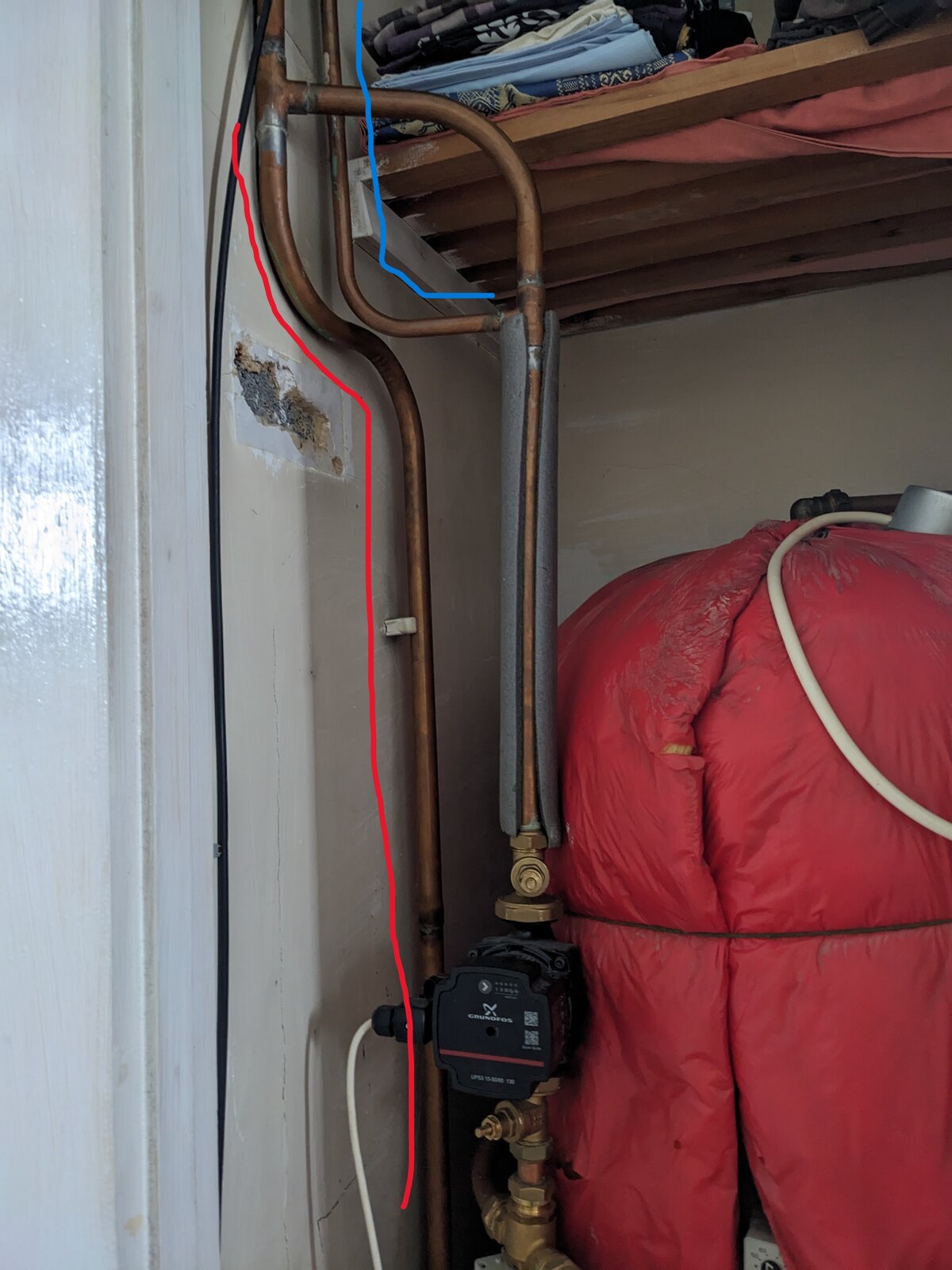

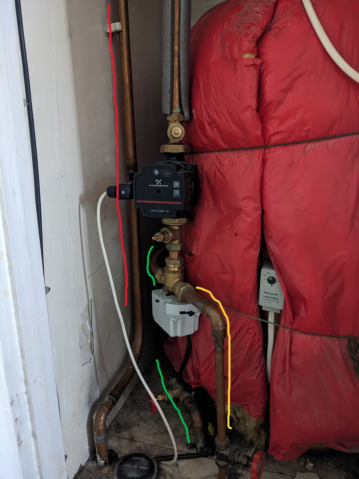

I have attached a couple images of the pipework around the pump.
The pipe marked with the red line is from the boiler (I assume)
The pipe marked with green is the into and out of the hot water tank
The pipe marked with yellow goes to the radiators
The pipe marked with blue goes up to the F & E tank and is the one that I think is filling it
The pump has an arrow pointing downwards so i think this is installed correctly. It was done by a heating engineer so i hope so! It was installed in the same place as the previous one which was done at the same time as a boiler replacement about 15 years ago (before we moved in).
I thought about pumping over which is why i reduced the pump speed.
There are no faults on the boiler, its a Baxi Solo 15 HE. Is there a way to easily see if there is a fault with either of these 2 parts?

Try bending the arm of the ball cock downwards by a few inches, it may not stop the actual over pumping issue (if there is one?does any flow come out of the pipe going over the top of the tank when pump working?) but it may keep the top water level in the header tank at a level below the overflow pipe When everything is switched off and cold how far below the overflow pipe is the water level?
Normally a blockage in the pipework where the feed joins at the T piece (blue line). If a magnet is attracted to the area it will point to that.

The CWST is higher than the F&E tank, if the HW cylinder coil is (pin) holed then the water will rise in the F&E tank.
Even if pump over through the vent is taking place with the HW/pump on then that should not cause the overflow as the water would just recirculate.
