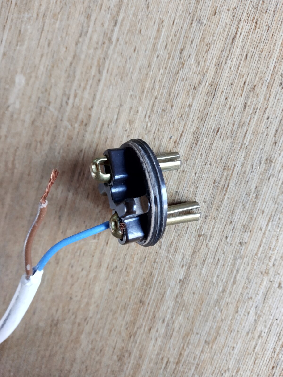

Earlier today I assisted with some PATing, In the MD's office we found this
plugged into a 4way extention lead, under a pile of blankets AKA dogs bed.

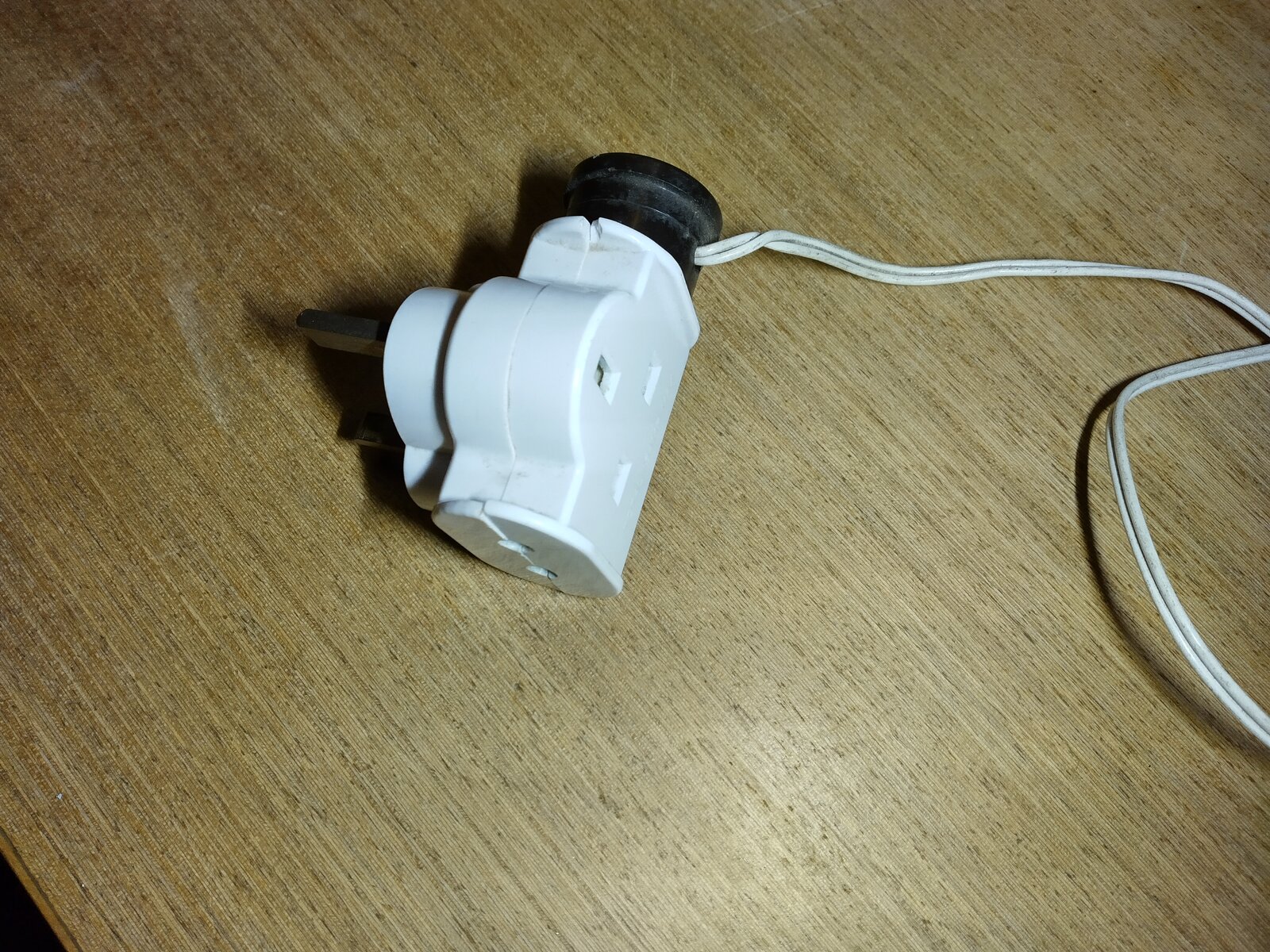

Then this
feeding an ancient metal anglepoise lamp.
Despite the building being only 6 years old he reckons it's worked perfectly for 50 years and doesn't understand why it's failed PAT, however he was aware of the tingle when he touched the lamp.
We offered to remove/dispose for him...

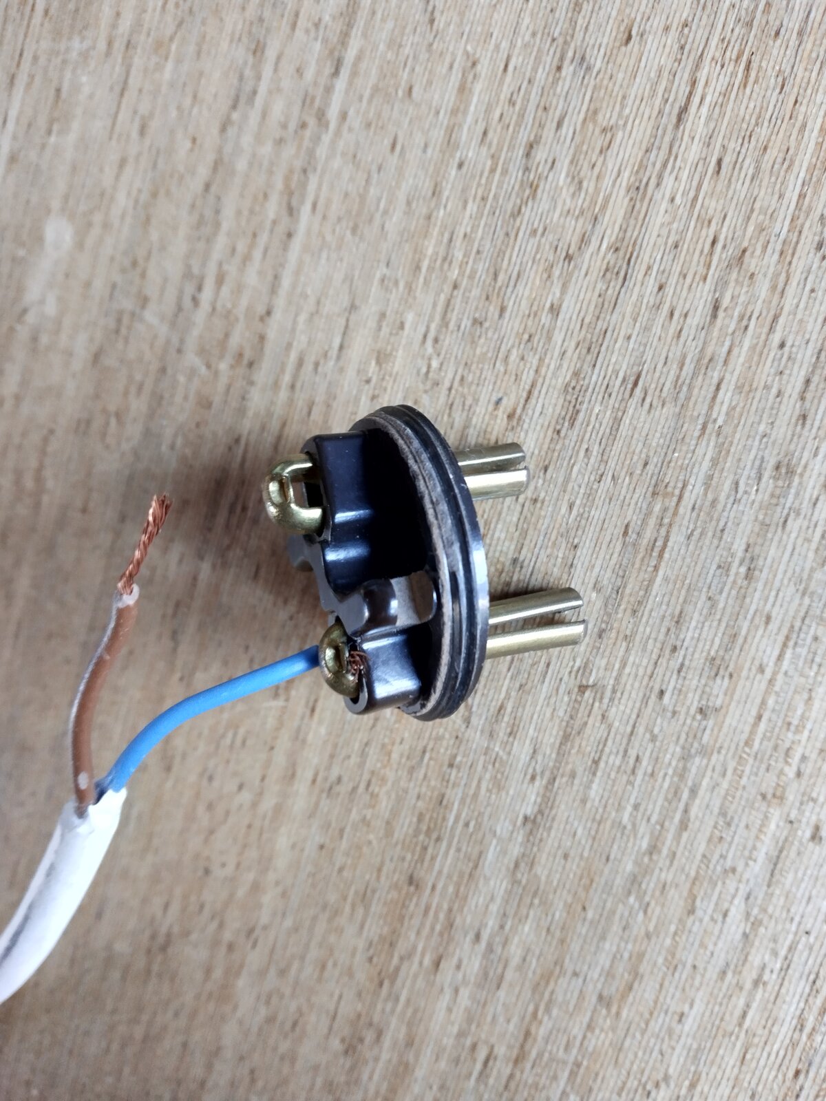

The plug used a sort of brass split pin to clamp the wires, as you screwed the cover down, it tightened the split pin onto the wires. Clever idea, no tools needed.
Not seen one of those for 60 years :)
For the befit of the tape; the evidence:
I agree in principle they are a clever idea but in operation I remember them being horrific.
There is no form of cord grip and the copper often fatigued against the edge of the brass, also some pins had very square edges and if overtightened cut into the copper.
For the befit of the tape; the evicence:
There is no form of cord grip ..........
There is a 'form' of cord grip but in the case you show it hasn't been used. There's a pair of bakelite 'hooks' that the individual wires should be routed
through which are intended to take the strain off the wire terminations. Maybe not very effective but in the grand scheme of things at that time, better than nothing.

It is many years since I've seen these and I remembered them as no cord grip, I don't know if they were all like this or different variations. However I do remember the wires pulling out and getting shocks off the exposed copper on more than one occasion.
There is/was a sort of hook cast into the Bakelite, which forms the cord grip, but it only gripped the cores, not the outer plastic/rubber/cotton or what ever. Who ever fitted that plug, didn't bother with the cord grips.
Back in the day, those plugs were very common.
Jackrae has pointed this out, I'll freely admit I didn't look/notice when I took the pic. I haven't handled one for years but recall the wires pulling out to be a regular problem, more to do with the copper failing than anything else.
