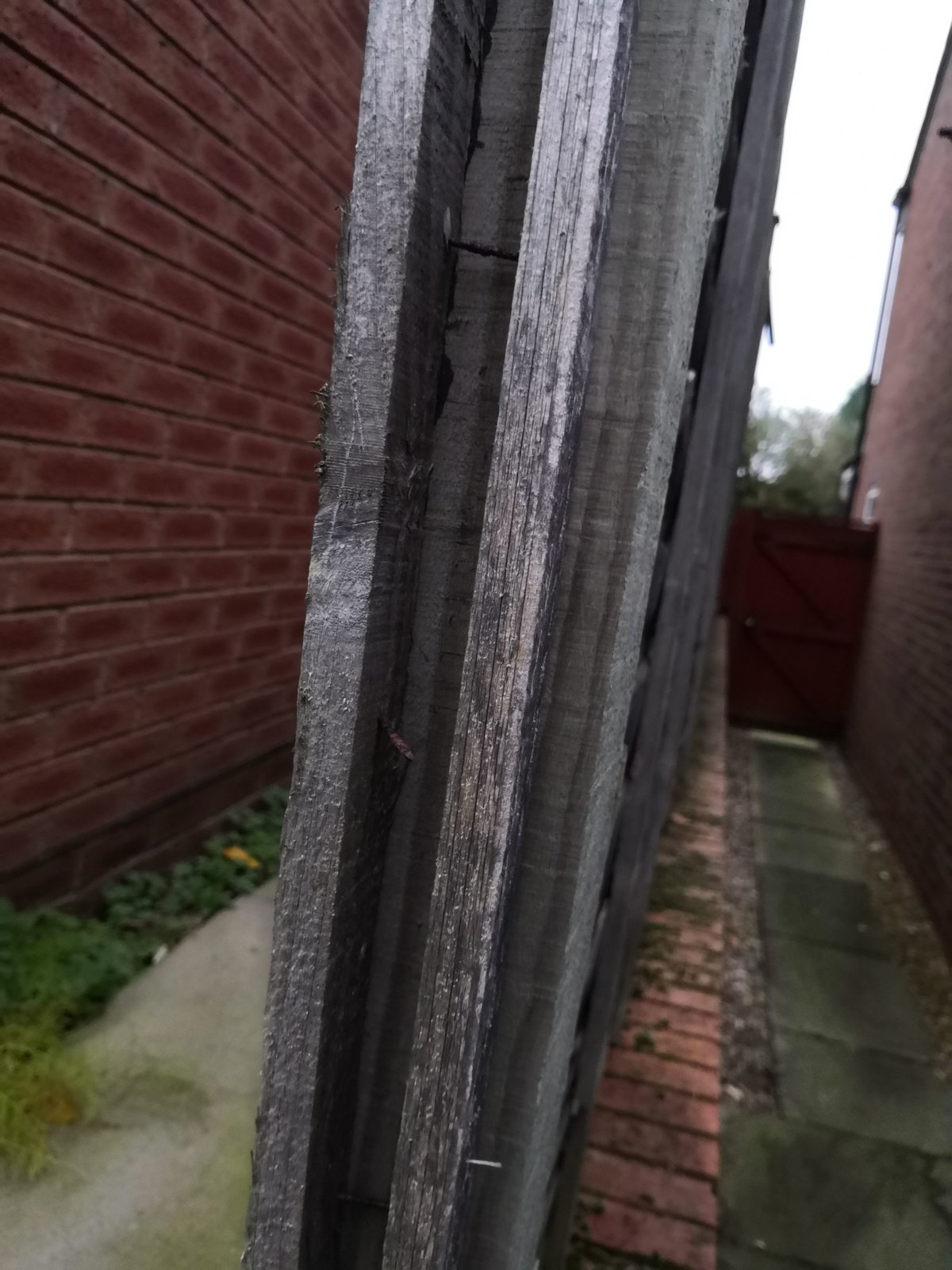

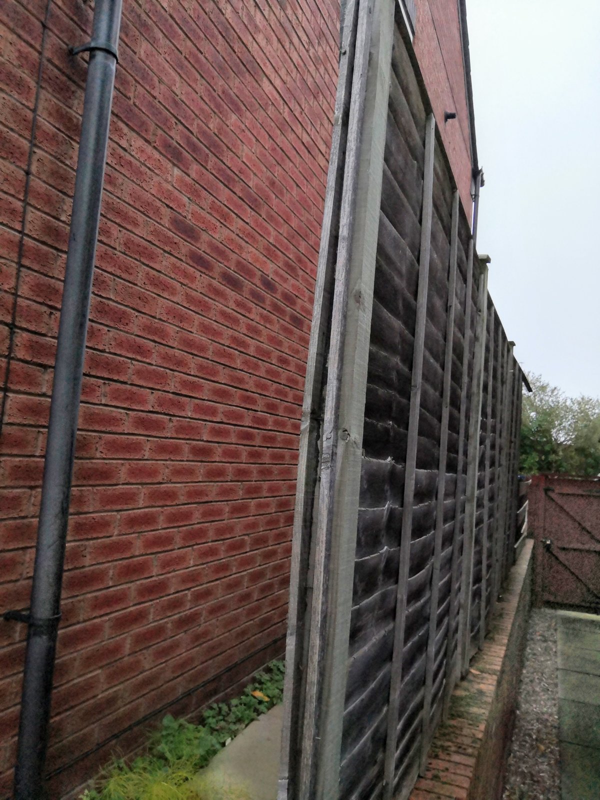

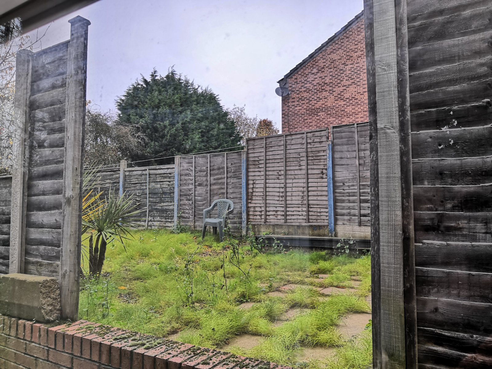

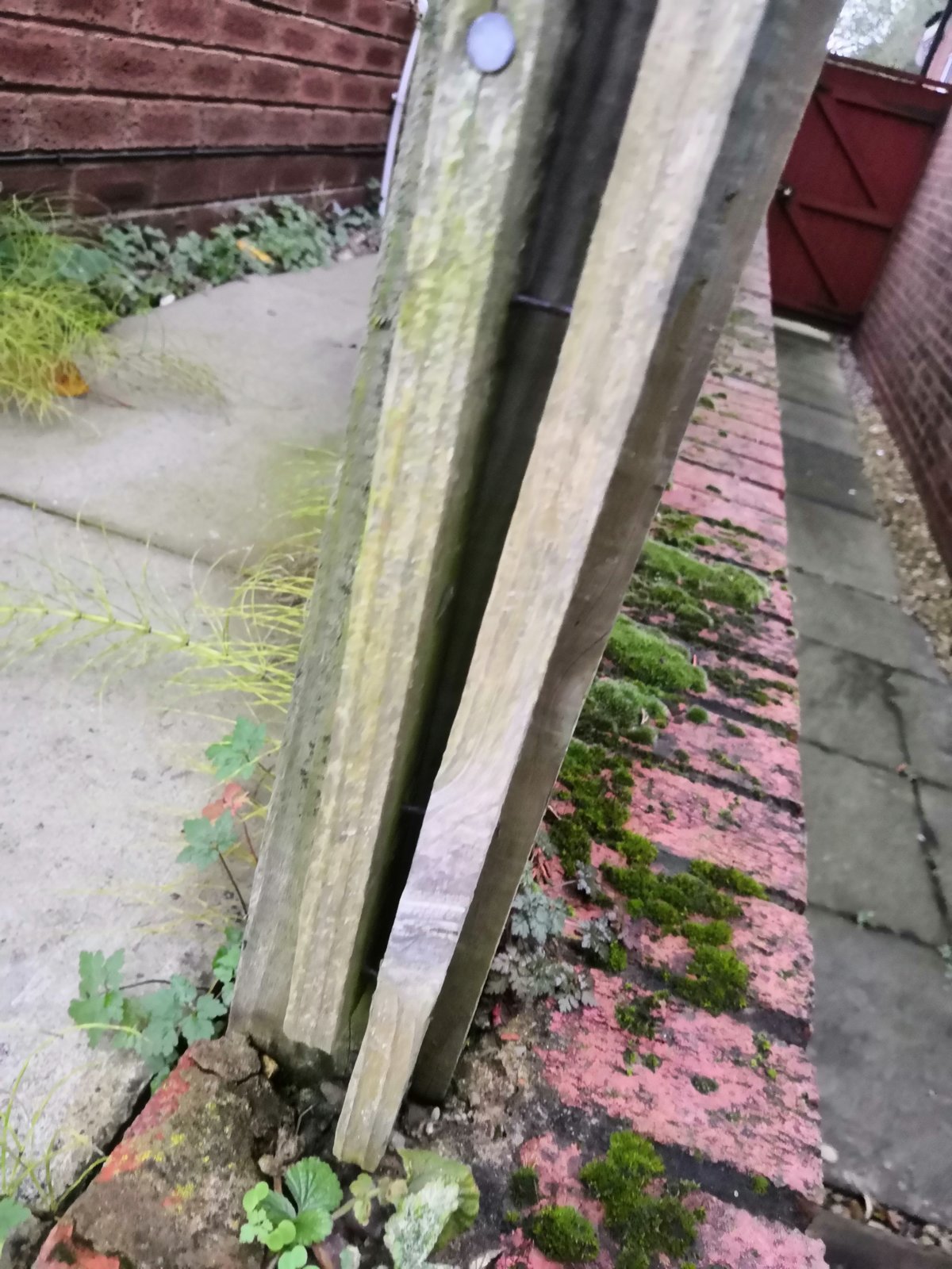

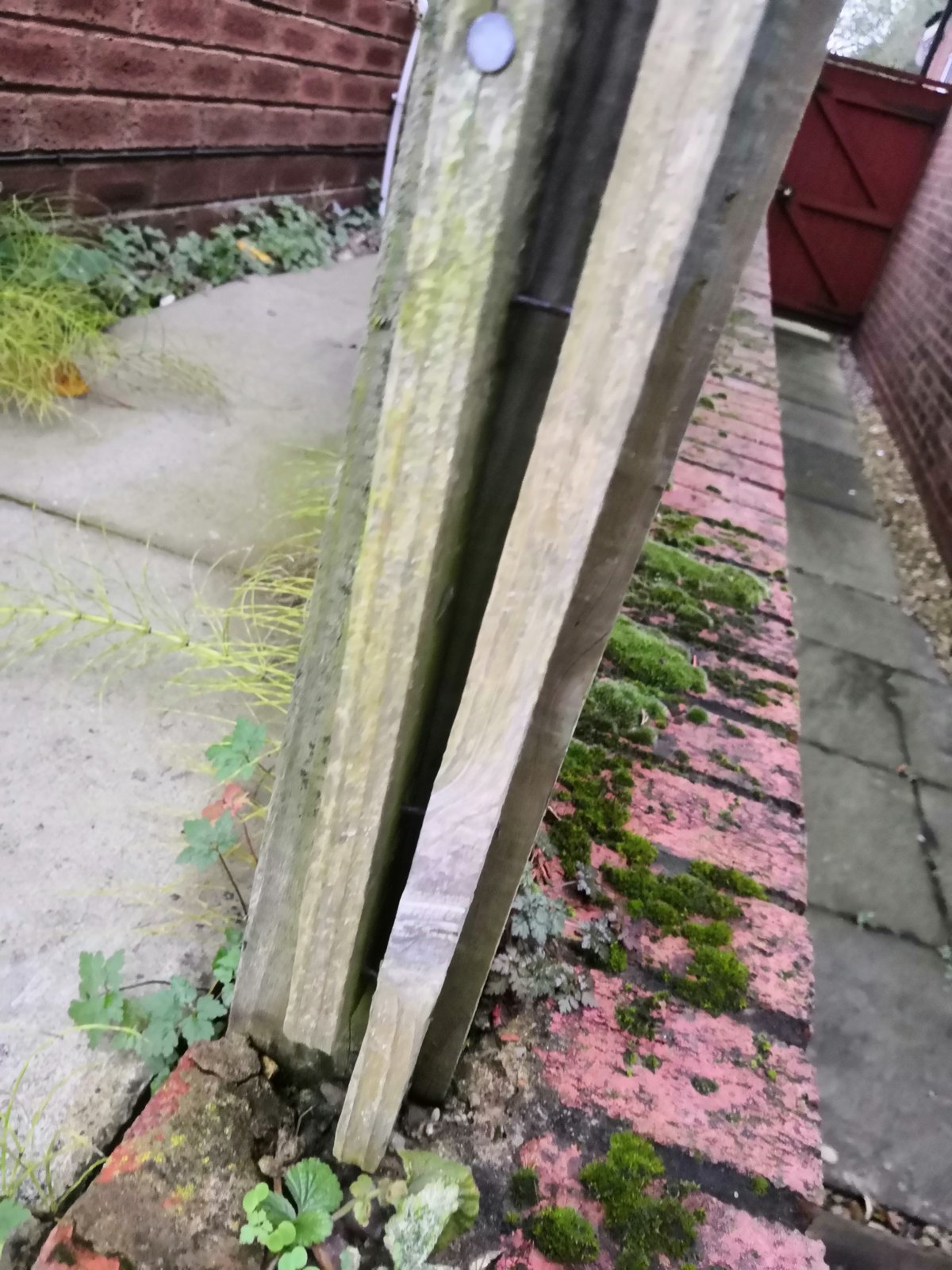

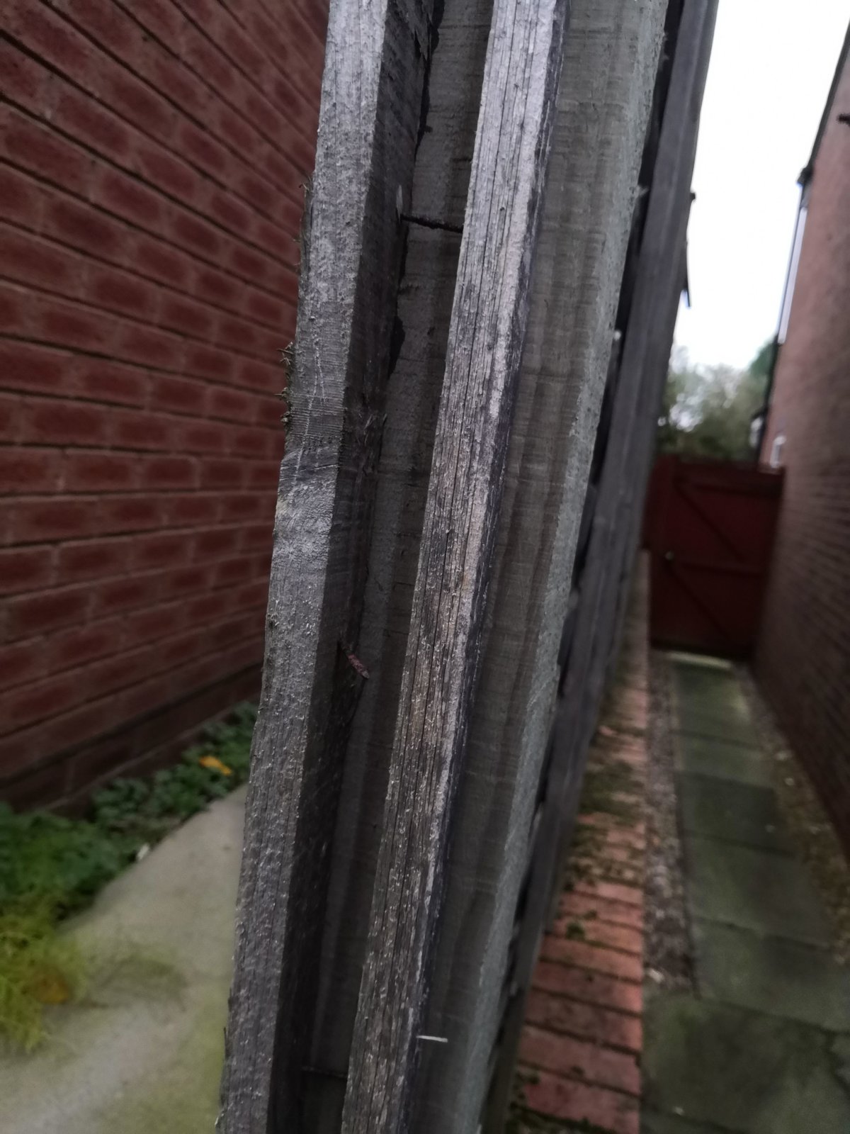

Hi All,
I need to replace a garden fence panel, it's been on my to do list for over a year now :(
I can get a 6x6 ft panel, but the replacement doesn't look so straight forward. Is anyone able to point me in the right direction please? I'm willing to give it a go myself, but not great at DIY. As you can see from the photos the old nails are still present and I can't see any easy way of removing them. Any guidance much appreciated.

Two ways of removing those nails (it can pay to have hands like shovels and a grip like Popeye)
Use a pair of pincers to pull the nails through (the tool may also cut the nails if they are rusty) or.....
Use an angle grinder with a 4 1/2" slitting disc to cut them away.
Either way, those nails have to go.
