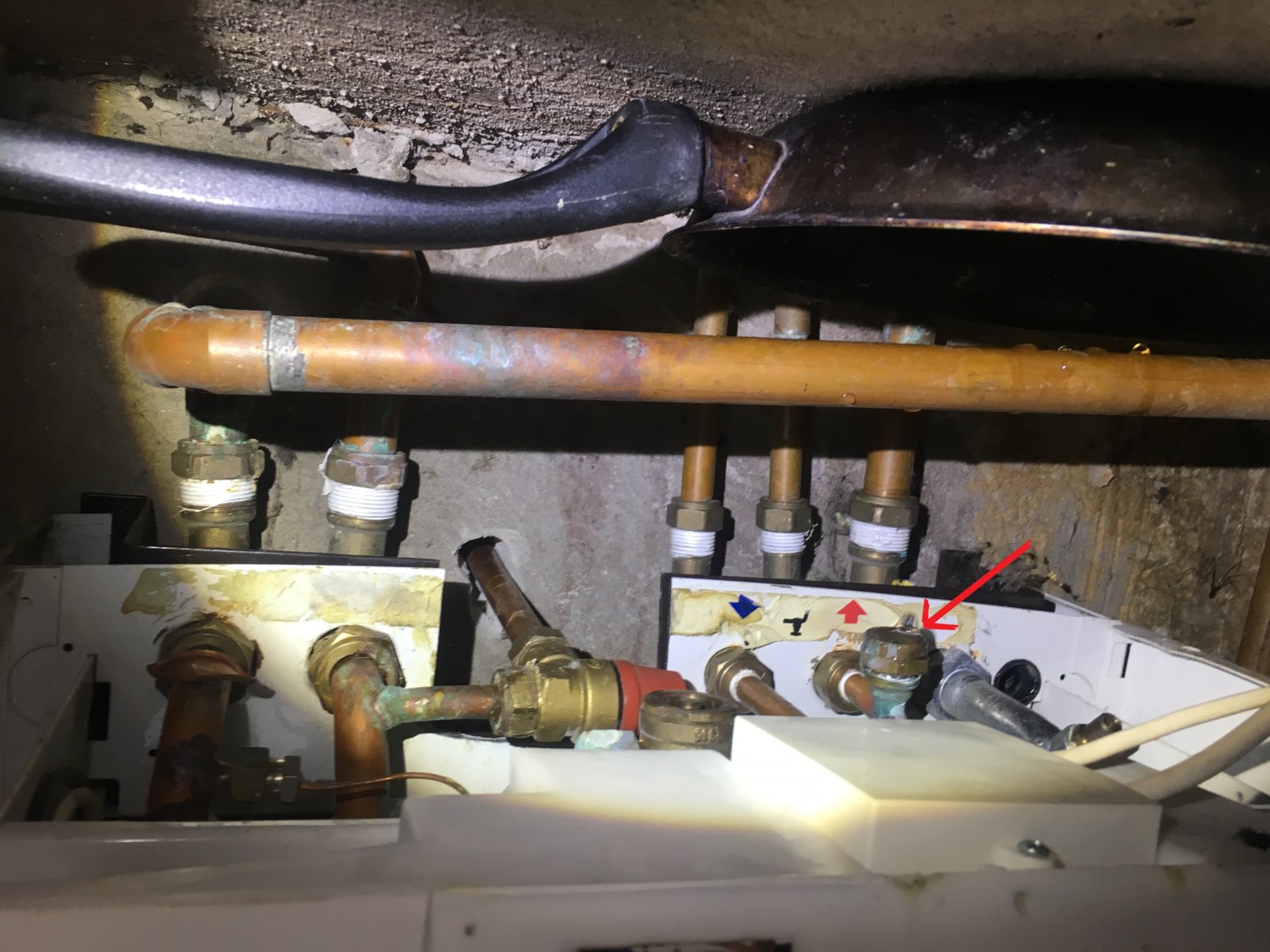

I'm just draining at the proper drain pint on the boiler mate, no **** ups, it's draining ALL the system above/upstairs though!!
Here's the PDF with drain point, Page 19 - https://www.ccha.org.uk/wp-content/uploads/2016/03/Ferroli-Optima_701_Manual.pdf
It's just a soldered T on the CH out. (see my pics above)

I do not know why it's showing upside down? I have edited/rotated it 180 and it still shows the same...
Ha Ha no wonder it is taking ages to drain, That is the Domestic HW drain point that will never stop because you are trying to drain the Cold water mains
I know i am, i stated it a few times!! Where is he point to drain boiler as this is not going to prove anything..lolo_Oo_O
Just opening the PRV would suffice i presume?..lol
yes but remember to leave it open when you are pressurising the ev, unfortunately your boiler doesnt have a designated drain oint , is there a drain point outside the building or a drain down Lockshield valve near the front or back door ? something like this ?

Yes there i have drain all of them near the rads downstairs but still getting water from boiler.
How can i keep the PRV open, they just turn so far the click/reset closed...
I would need something to wedge it open (like the a speedfit locking clip) o i could just use insulation tape.
I don't mind draining it all down anyway tbh as i'm fitting a valve for future drains, plus i'm putting additive in (first time ever).
just open one near a door put a hose on the outlet to outside close the valve at the other end of the valve , open the drain cock and your boiler will drain down, leave the drain valve open and start pumping the expansion vessel up.
I done what you stated above first..
Anyway little update i closed off the drain point as system had emptied/drip.
I then removed the Pressure Gauge connection which is on the CH Return/boiler side and had nothing come out...
Put bike pump on EV and started pumping (easy to pump/no resistance) and it was like a jetwasher with water coming out!! Kept pumping and i was thinking the diaphragm had split/broken as i nearly filled a bucket full and i had NO pressure on gauge!!
I carried on and then the brown/sludge water came out and then it got hard to pump and took about 12 pumps to get it to just above 1 bar!!
It's sat at around 1.2 bar i would say and all looks good..I hope!!
