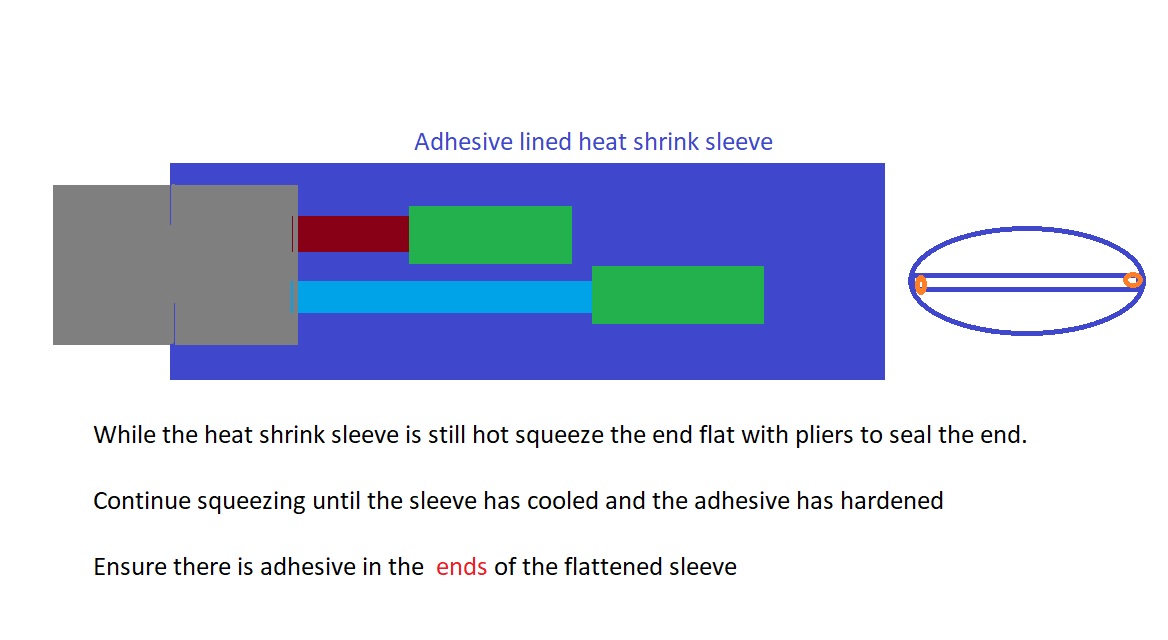

I’ve bought some ip57 outdoor mains voltage festoon lights. They are made with two core flex with a plug on one end and a connector on the other end to join another set if required, this has a screw on lid to make it water proof. I would like to cut the run in half and use two separate runs wired in to water proof junction boxes. The problem is that this would leave exposed ends of cable. What would be the best way to terminate the open ends of this flex to make it waterproof?
Thanks folks.
Heat shrink sleeving that is lined with hot melt adhesive is one option.

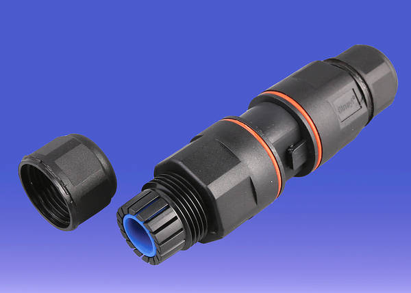

only two pin so unlikely for errors, the Telco IP68 Plug & Socket
Waterproof Connector seems better upload_2021-7-3_2-31-1.png but they are three pin, however if never going to join again @bernardgreen has given best method.

Lawn mover plugs and sockets seem a better idea View attachment 238135only two pin so unlikely for errors, the Telco IP68 Plug & Socket
Waterproof Connector seems better View attachment 238136 but they are three pin, however if never going to join again @bernardgreen has given best method.
Well the 2 pin are not weather resistant and the waterproof type you show are not relaible as has been proved by those who have thied them for this purpose.
Thanks for all the tips guys, it looks like adhesive lined heat shrink is the way to go. Unless I feed it in to the shed with a IP rated junction box at the end of the run and fit a light in my shed. Its only a small tool shed so only very occasional use and I can live with having to have the festoon lights on to use the shed light. Not perfect but better than no shed light at all?
