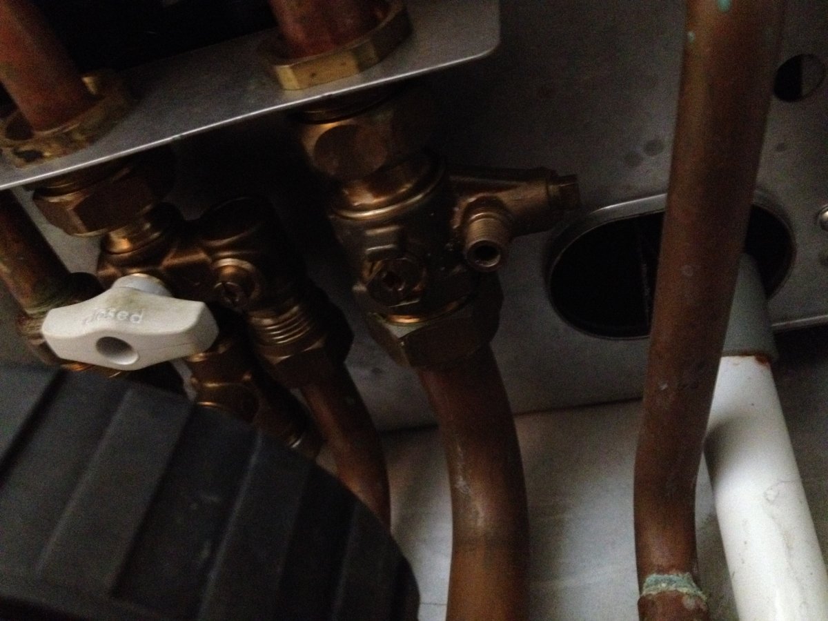

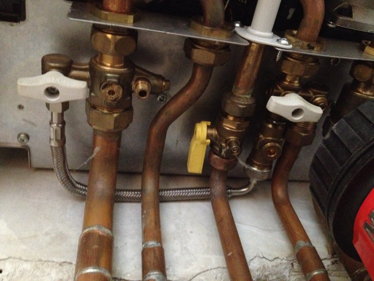

Hi All,
I wish to fill my heating circuit for my Glow Worm Ultracom 24cxi Combi Boiler... I have switched off the boiler and opened both the grey taps through 90degrees and nothing happens.
I am no expert and my boiler is in this current state of the attached pictures.
Do anyone have any ideas?

It looks like the filling loop is in the closed position.
Both valves should be in the open position, which will require a quarter turn so they are in-line with the braided flex.
I would have the boiler on, but the heating in the off position.
Why does the system need refilling?
There is cold water supply to the boiler and the flow/return valves are open?

The flow and return valves are part of the central heating circuit, the two grey valves are part of the filling loop. So not the same thing.
Both grey taps need to be in the open position. I assume you have not touch any other valves than these two.
If you are getting hot water, that would suggest you have a water supply to the combi-boiler and the the boiler is pressurised enough for it to fire up.
What is the pressure gauge reading and have tried bleeding the radiator you have attempted to fill.
If you already gave 0.7 bar, it is possible that this is enough for boiler to fire up, but ideally wants to be about 1.2bar. You should hear and feel water running through the loop when both valves are open, but sometimes the fill is slow if an additional external filling loop has not been installed and the gauge will only move up slowly.
Also check that there is no water leaks on system or boiler that is stopping the pressure from rising.

I found out the problem... the left tap had rounded off and was not turning the valve. I took off the taps and used grips to turn valves, which began the filling of the system. Guess I need replacement taps! Thanks for your replies PrenticeBoyofDerry!
