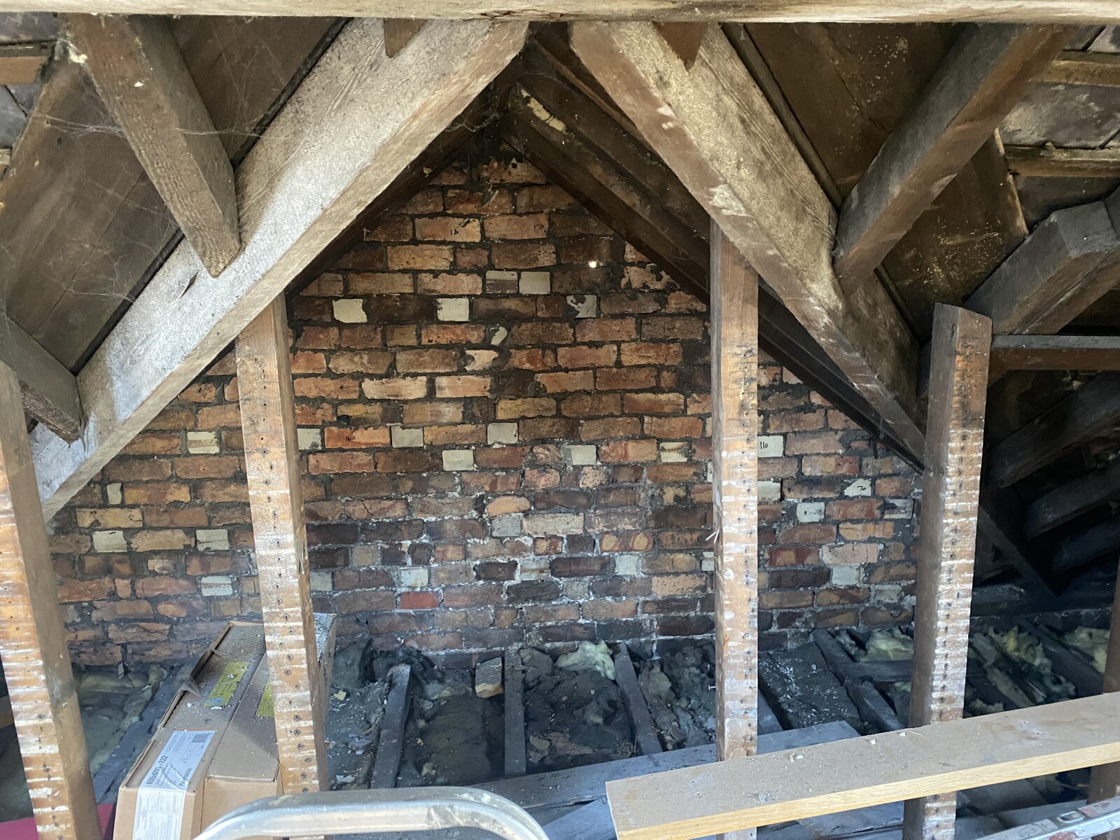

I know you can have an aerial in the loft, but is there any distance from a wall it needs to be set away from ?

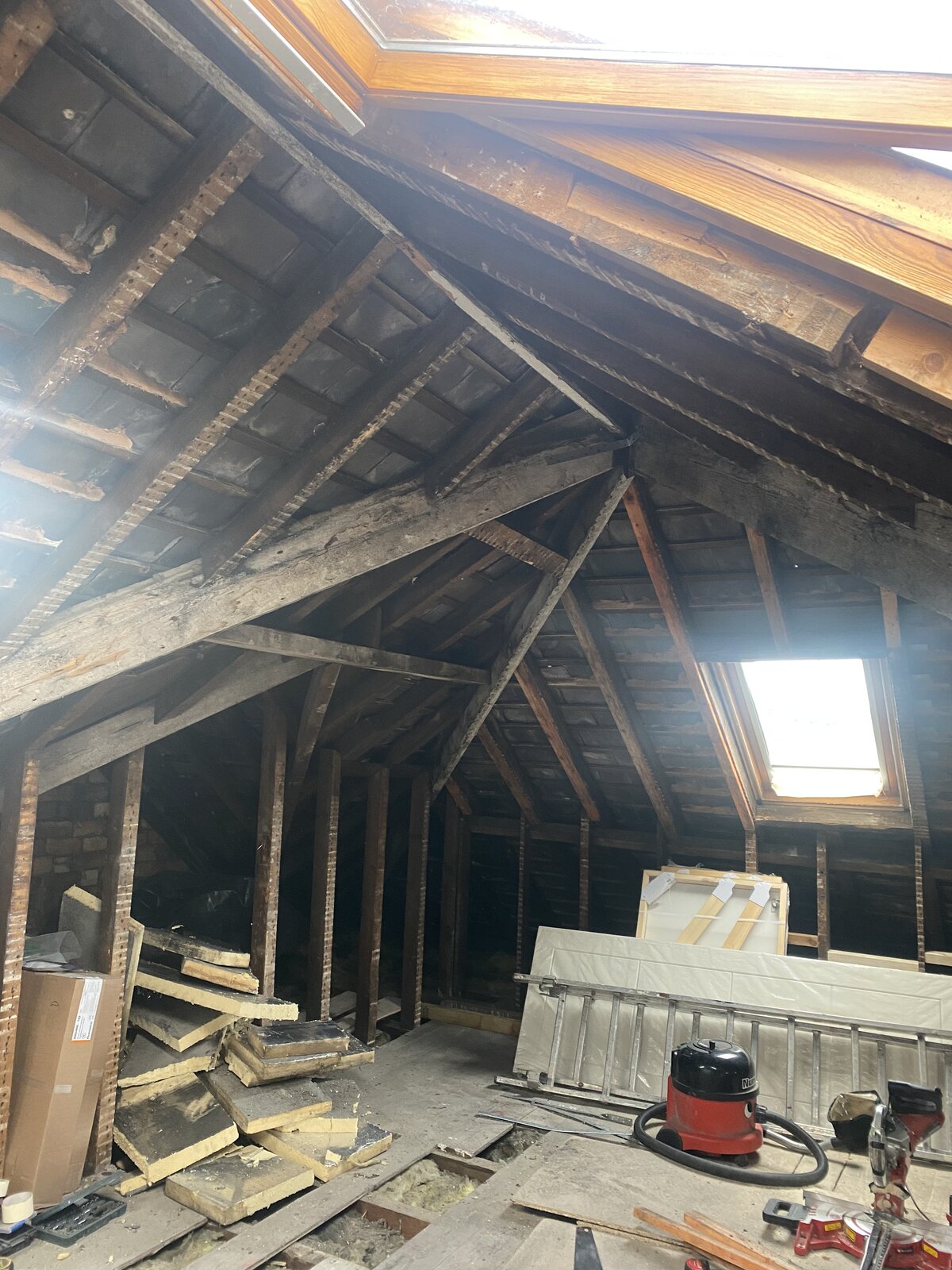

I have a tightish cupboard area which will hold the boiler, washing machine and fuse board on a flat i am renovating. I was thinking of putting the aerial in there as well. The building is high and we have aerials on the wall lower down than this flat, so i dont think i need to go out onto the roof to put one on the chimney.
I have a photo to show roughly where it will go.
It’s in this space where there is a triangle of wall. The 2nd photo shows this space just off to the left of the room

Yes doing 75mm between the rafter and 50mm under. On the walls it will be 75mm.
The tower is so close to this property. It is a few hundred meters away as the crow flies and is on a hill looking down on this street. So the signal is strong.

Others here are correct. Looking at that roof in the pictures it's possible to see the back of the slates. That's going to need some work and insulation. By the time that's done, the foil lined Kingspan and the rest are going to make the space a signal dead spot. (Mobile phone too, possibly.)

That loft space looks to have enough space to make it into an extra room/man cave, you don't want to clutter it up with ineffective aerials :)
