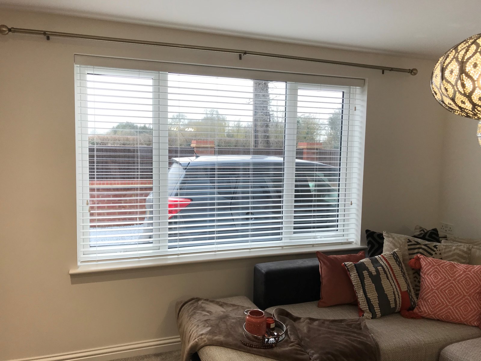

just fitted 5 wood venetians.

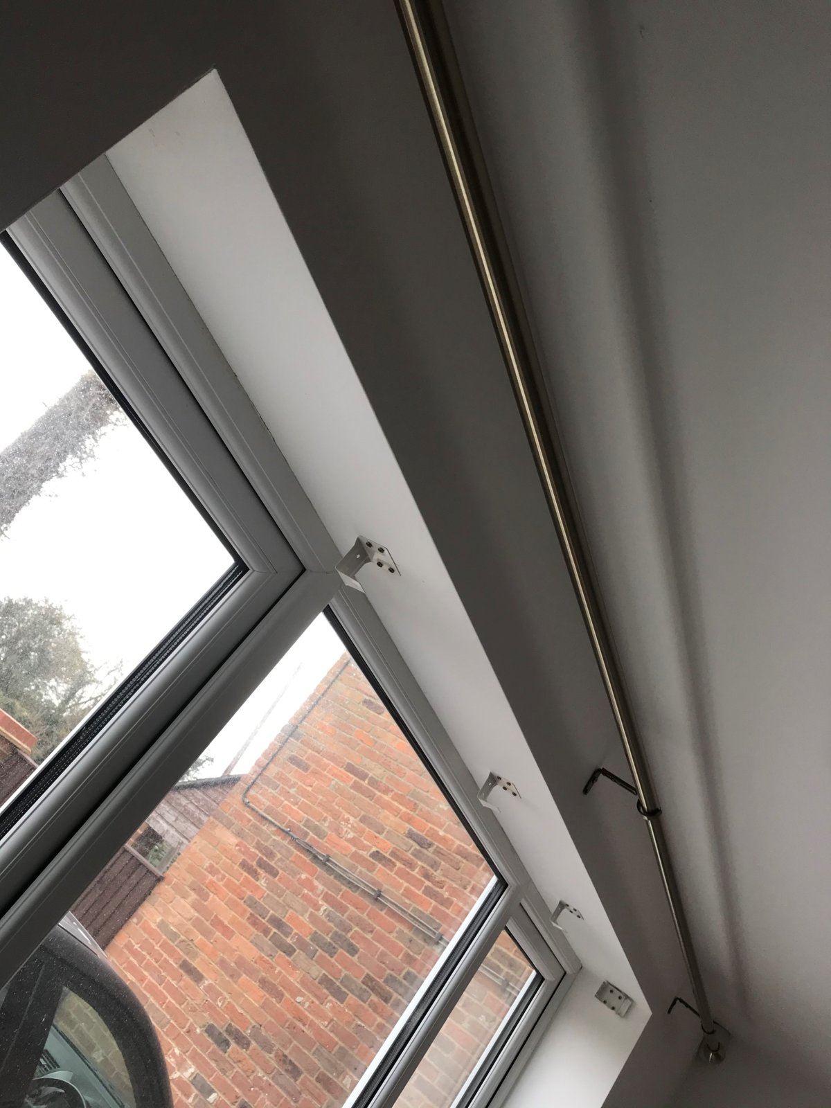

Fixed the brackets to the top of the window reveal. LR window which is around 9ft wide (60's house) had to use the hammer drill as reg' drill wouldn't do the job, but the other 2 windows were fine.
Make sure you set the blinds far enough forward to allow for window handles sticking out.
We used extra support brackets recommended by the company.
In our case, they aren't quite as deep as the end brackets so we had to fix them so they were in line with the front edge of the end brackets, as opposed to lining up with the back edges.
UPDATE: The ceiling reveal had a concrete lintel at the top. My Makita combi drill would not have any of it! I had to use my Bosch mains-powered hammer drill to get through it. This was for the 3 supporting brackets.
The blind also came with end fixings which I was able to drill into the side of the window reveal. This went into blocks (inner leaf of cavity wall).
Thanks for your help.
Welcome. Good job and looks great. Same with our Makita combi. We didn't have a hammer drill (but had been talking about getting one) but it's my favourite toy now! Surprisingly easy to use considering the weight and size.
