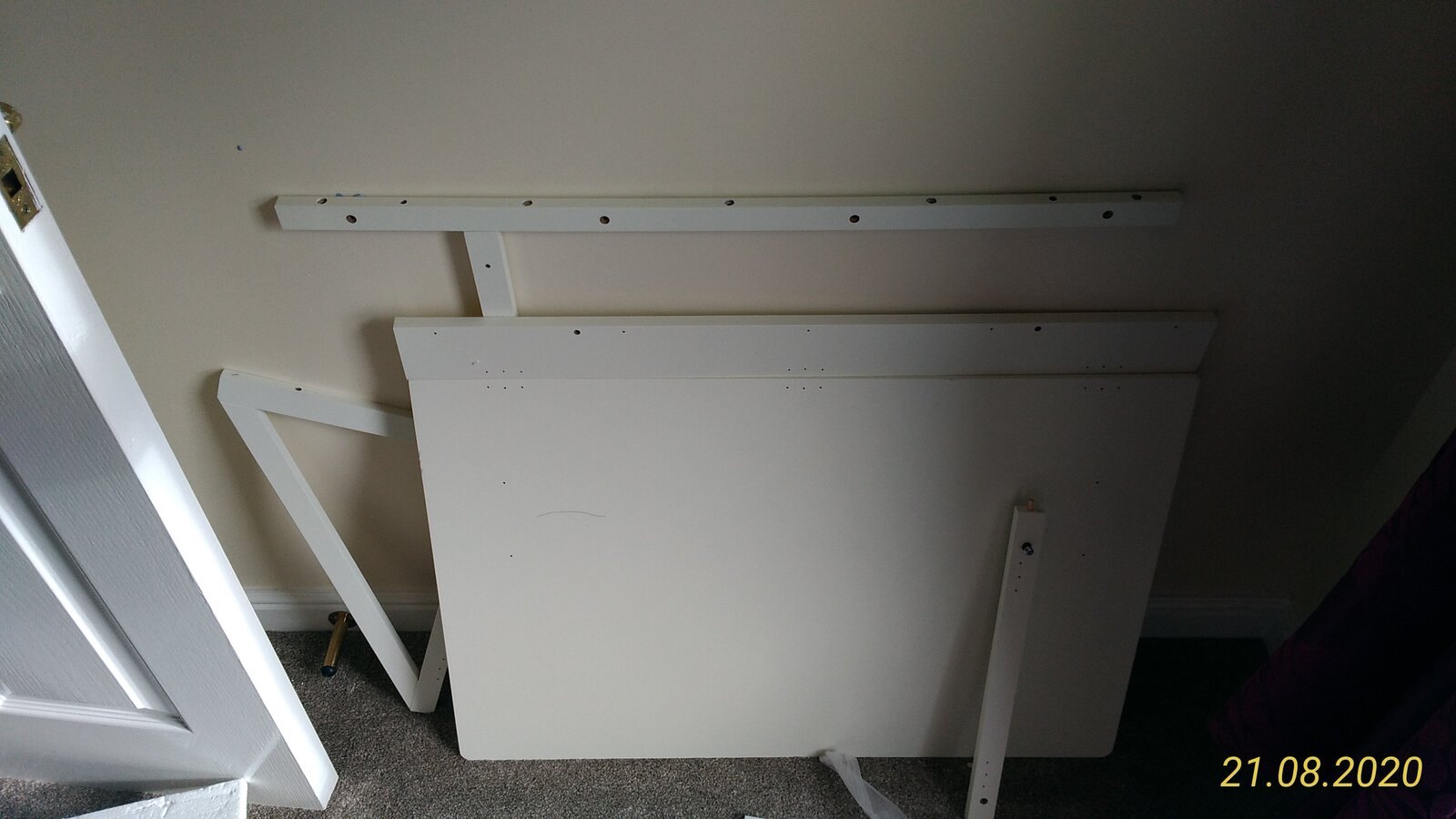

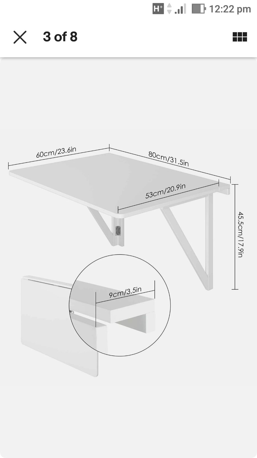

I'm fixing a drop leaf table to a plasterboard wall.
I've read other threads advising to find the studs and fix to a stud.
My wall is only 1.95m in length. You'd think there should be a stud? But I'm struggling to find one! It has the same echo all over.
I wonder if there's a sound frequency app I could use?
Anyway, if fix the table to plasterboard, I wonder if spring loaded toggle plugs would suffice?

You could cut vertical slots in the plaster board and slide some 2x1 in behind the plasterboard to make your own studs to fix too , did this for a heavy wall mounted microwave shelf on plaster board walls.
Obviously need to make good the walls. Friend tried the toggle fixings on a table , first time the top was lowered it ripped off the wall .
The verticals should match the location of the hinge and supports.
If you're ok with drilling a couple of exploratory 1/4" holes then you can make a U more shape out of coat hanger wire. Thread one leg into the wall, sound absorbsion fibre may be an issue. Then as you rotate the leg on the outside, you should feel it touch the studs. The leg should tell you where the stud is.
They are normally 16/24" or 400/600

This might be bad form, but despite the risk of the wall coming down I'm going to try just anchor brollys. I've got the rawlplug tool too.
My stud is too close to a door so I won't be able to open it fully with the desk behind it. Although there is a stud at the other side of wall that I might be able to reach with a long screw.
This desk has a long horizontal piece and 2 verticals so should dissipate the load enough. (Hopefully)
