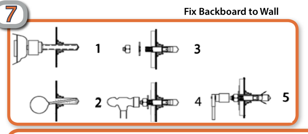

I have a quite brittle old wall I need to fix the following bracket (for a heavy basketball hoop). The instructions for fixing is attached but I feel I need a substantial fitting. Can anyone recommend? Would I be better using a resin or an anchor of some sort?

So i think my only option is to diamond drill the wall, use a 2 part resin and rods. I need to hope I get into actual stone versus mortar on this! Any others ideas are welcome!
Could you fix 4x2 or box steel to the wall first where you can choose where to drill the fixings, then fix the hoop to that?
That might be a great idea ... as I am very concerned about getting the holes aligned to the fitting!
