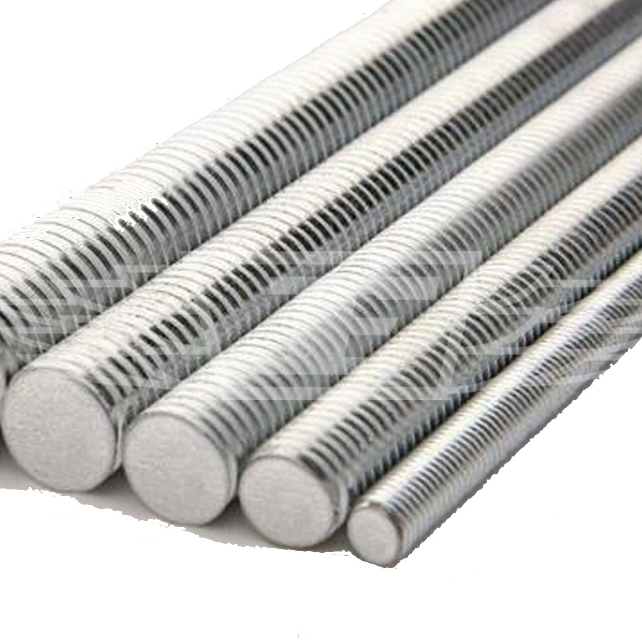

Thank you for the reply. Please excuse my ignorance, what do you mean by the studding method?
this stuff
steel bar, threaded all the way along, zinc plated for short-term rust prevention, called studding or all-threads. What @Harry Bloomfield calls galvanised threaded rod.
Widely used e.g. for hanging suspended ceilings, or anywhere you want to fix something with a nut and unusually long bolt, especially for large sizes of timber if you are not good at joints.
It's quite cheap, usually sold in lengths between 1m and 5m, in numerous sizes.
I happened to have some 4-metre lengths of M8 (meaning 8mm diameter) in the shed, handy for lots of things
you can buy it in cut lengths on ebay for a modest premium, it is a bit tedious to cut it yourself unless you have an angle grinder.

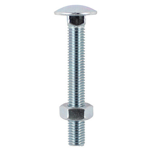

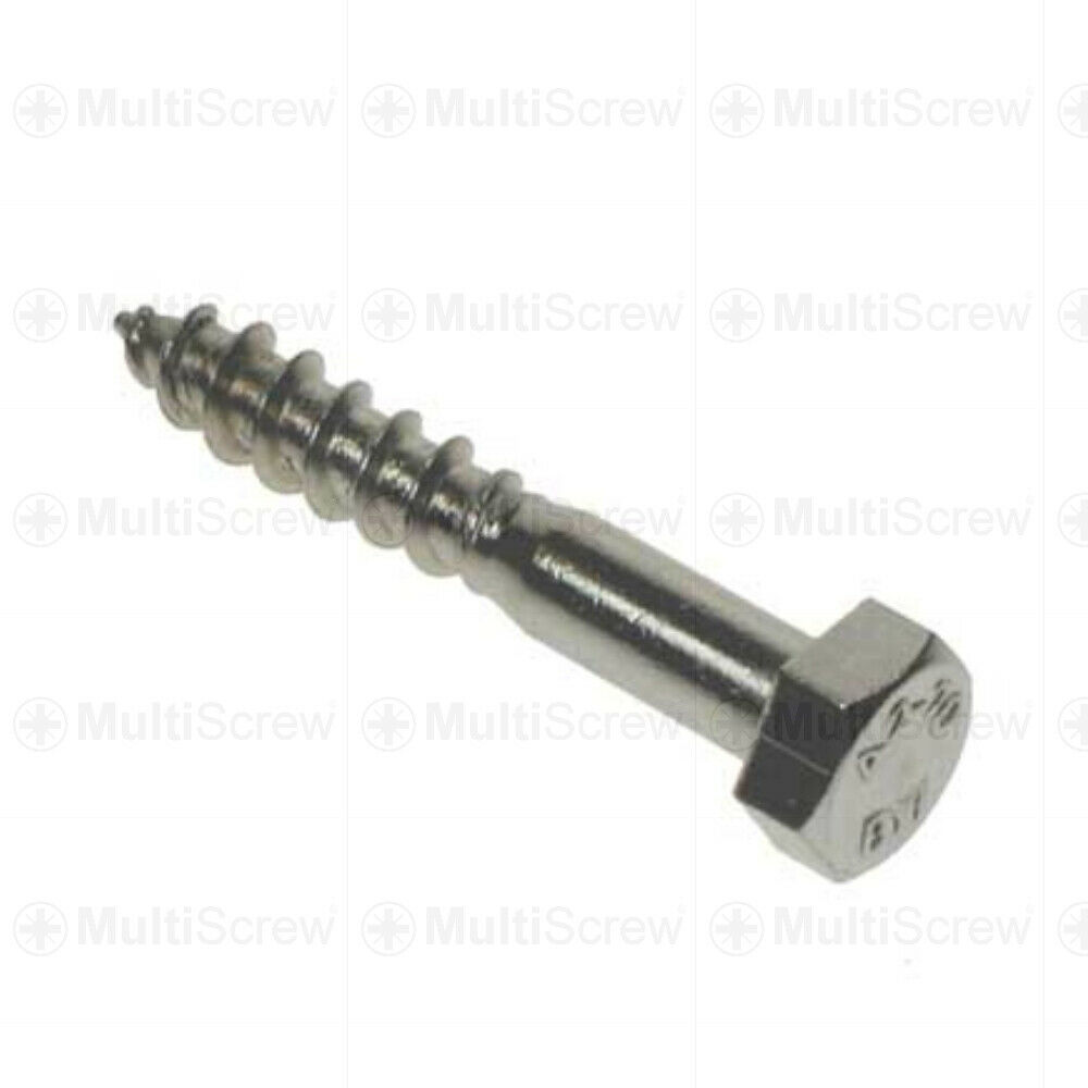

So I used lots of 150mm lengths, with a washer and a nut on each end, to fix wooden fenceposts to concrete spurs, and assembling my shed, and it's much cheaper than buying bolts or screws in such a large size, and it can be any length you want.
compared to a large size of coach bolt, M8, 150mm, or a coach screw, it is a lot cheaper

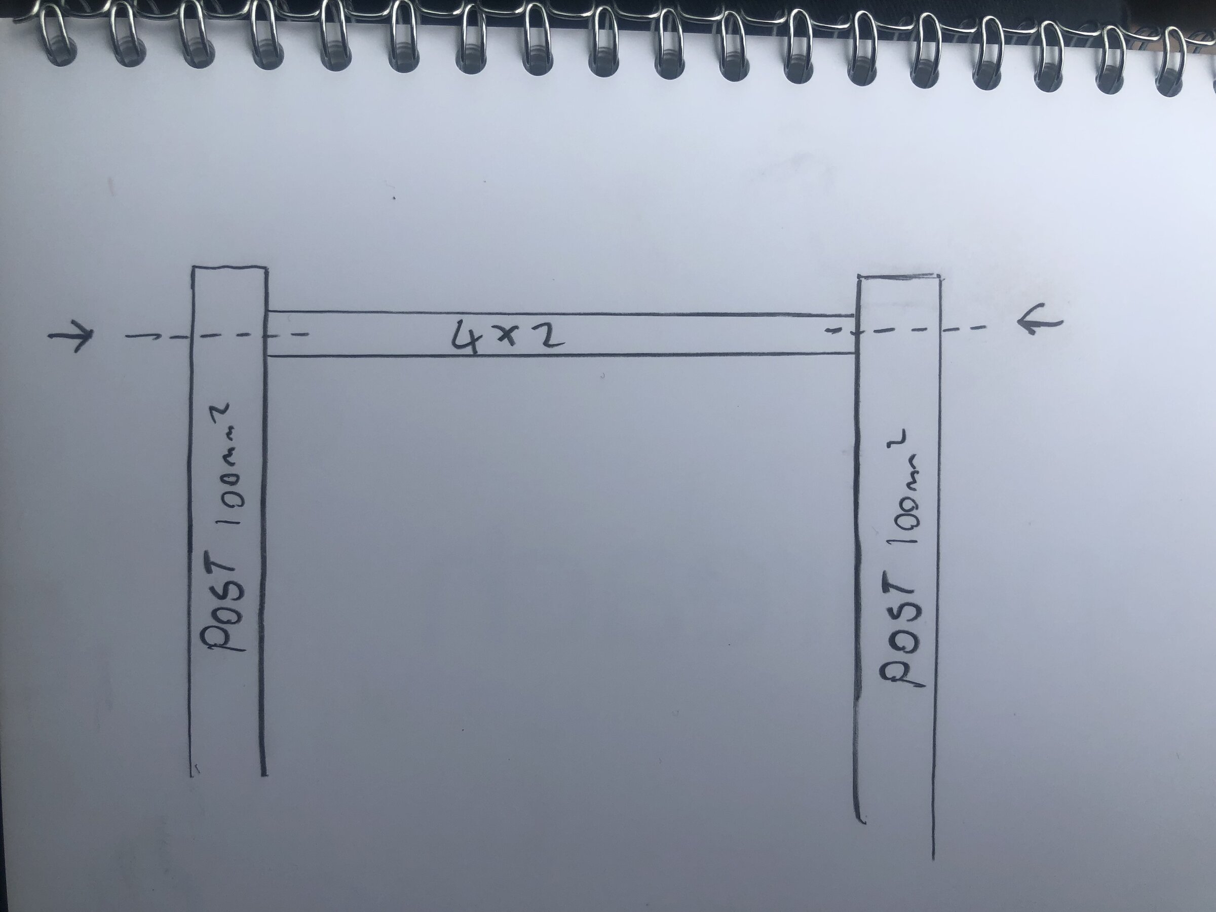

I’m not sure I have explained myself properly, or if I have I don’t have enough knowledge to work it out haha.
As I will be putting the cross timbers between the posts, I can’t use the bar can I? As I could only bolt one end? Would I not have to screw this
Ah, on mine the beams are bolted to the face of the posts.
Screwing into end grain as you show is very weak.
Ah I see. I only have this 4 x 2 available for the cross timbers really. Is there anything I can do to make it stronger?
