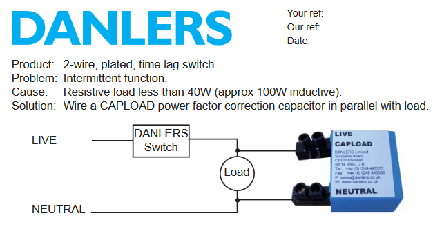

I had problems with flashing, which was cured using a load capacitor load-capacitor.jpg but as to getting a shock not a clue.
