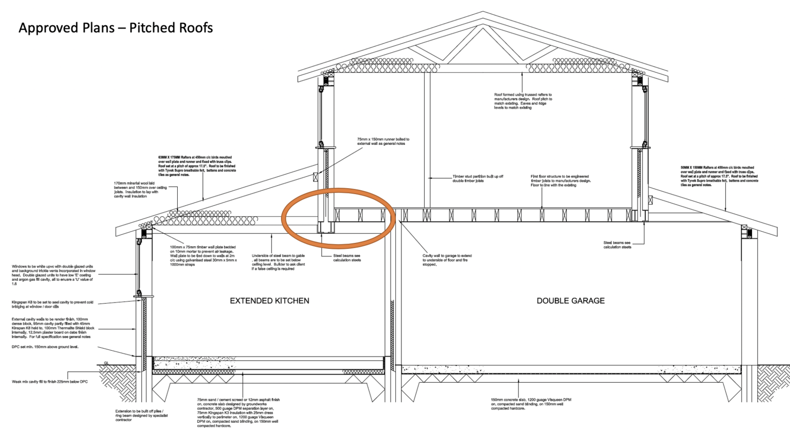

Thanks everyone for your input. Seems like a bit of a mixed view. So hopefully this adds a bit more detail to my situation. Current plans which were drawn up back in 2014 are as follows:
The designer actually didn't incorporate a change I wanted when the plans were submitted - highlighted in orange as I wanted the steels to be at the 1st floor level (sitting on top of another beam that will open up the existing kitchen).

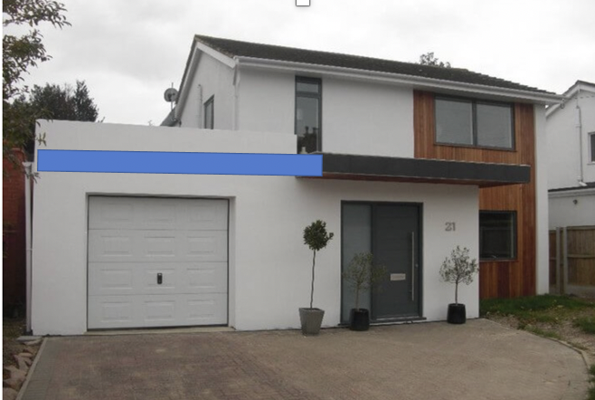

I've decided that I would really like a flat roof at the front of the house as there's currently a flat roof there now and other houses with a pitched front roof look a bit off. Basically I'm trying to copy this look, but with a front roof that extends along the blue line:

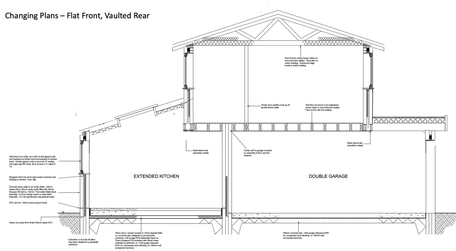

However the rear roof is where there's a few options:
(I don't have a CAD programme, so I doctored the original image using powerpoint - so sorry it's a bit rubbish)
So the above has one of those flat skylights in it, and allows the kitchen sealing to be one level.
I suppose with the latter I could lose the badly drawn Velux, but with the bedroom above sticking into the kitchen roof it looks a bit odd.
I know they all look a bit rubbish in cross sectional view.

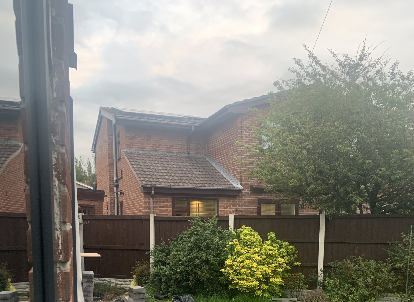

One of my neighbours already has a similar extension with no skylight (nor rear window) and I think it's not the prettiest thing - like a wall of tiles - looks like a steeper pitch than the original design of mine.

the neighbours would have looked nicer if they had stuck with the tiles used on the rest of the building. wesssex rather than renowns
Wessex? Yuck. Hideous tiles - but essential.
It would have looked nicer if they had mimicked the pitch of the main roof.
I hadn’t realised the neighbour had used different tiles?
@noseall what’s wrong with the Wessex? I was planning on replacing my roof with Wessex as that’s what was there before. Thanks
Wessex won't win any beauty competitions, that's for sure. They aren't the cheapest either nor are they much fun to work with/on. They are designed for low pitch situations so are essential for those roofs with very shallow pitches.
