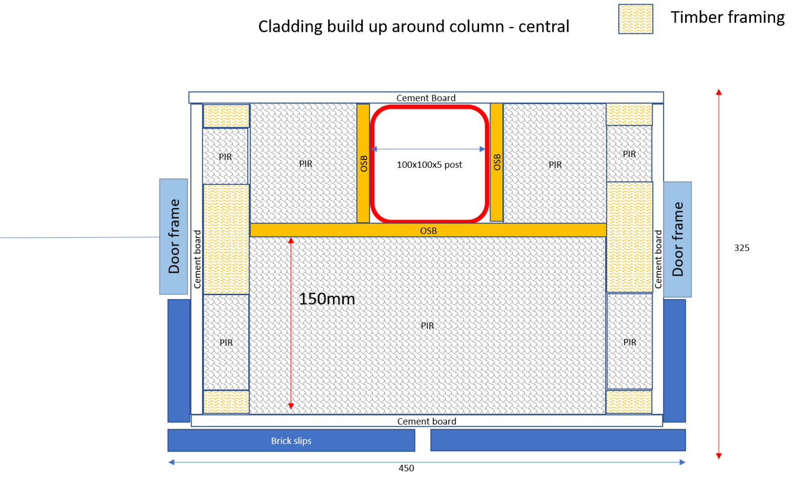

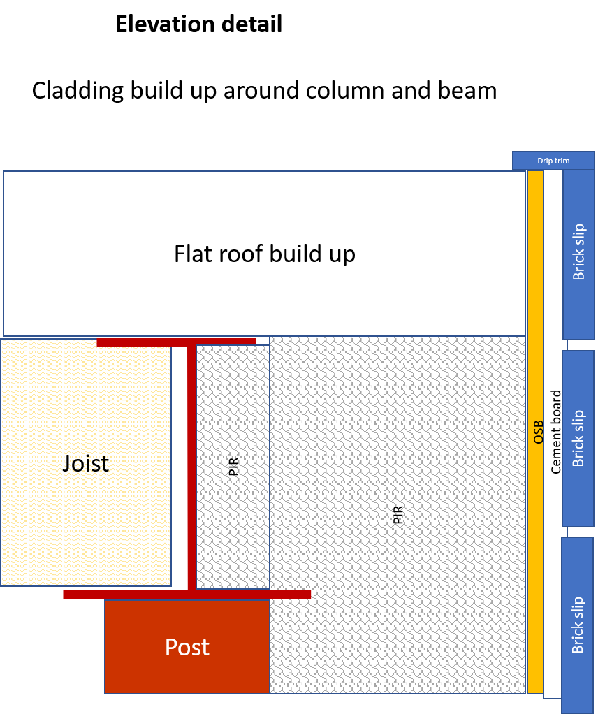

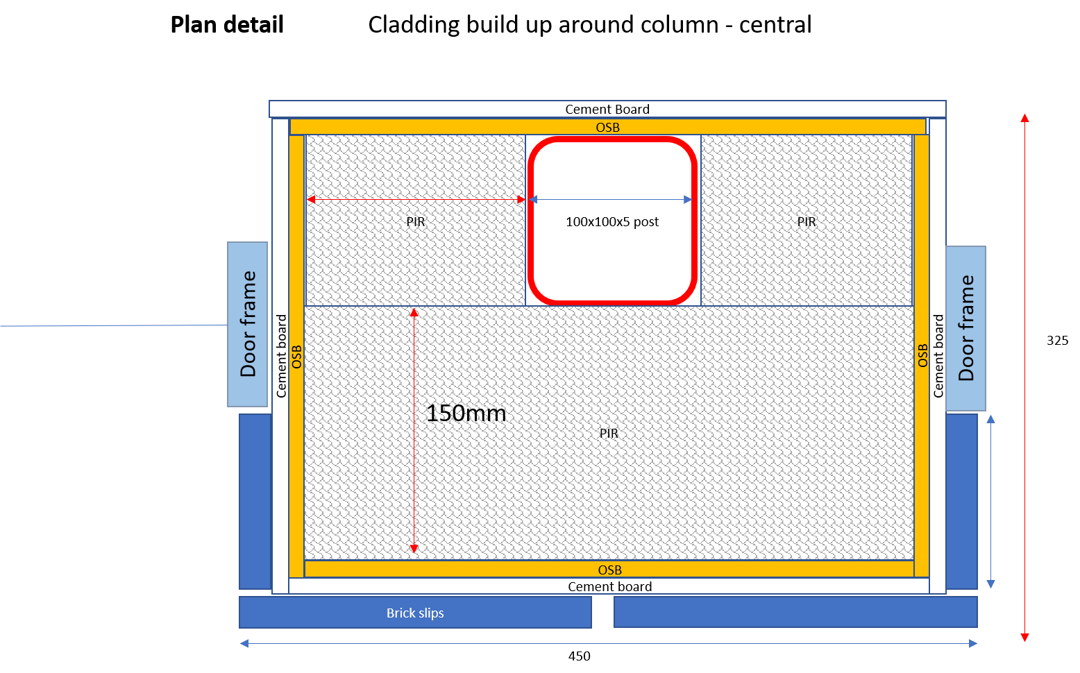

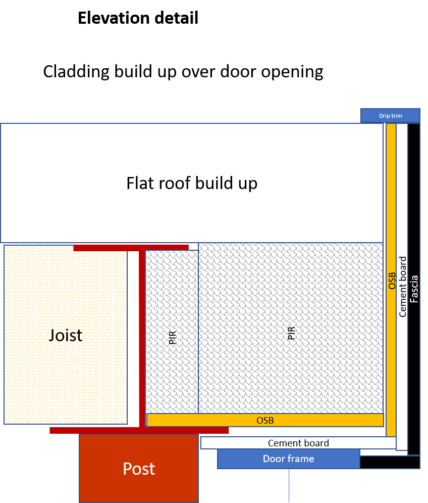

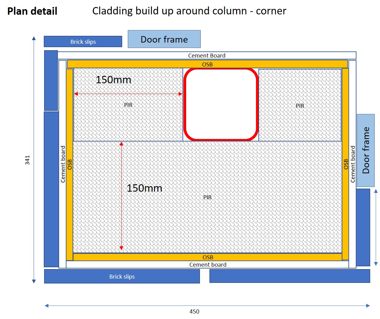

Thanks - this is my "extrapolation" expressed as some drawings... Any comments most welcome

Is it OTT to go into this level of detail or can you let a builder "get on with it".
It isn't OTT to go into this level of detail but I wouldn't give 'drawings' like that to a builder, they aren't proper construction drawings and what you are showing as elevations are sections.
Your drawings are not detailing how it's all to be fixed together. Basically, that's half a job as the whole idea of detailing is to detail how to make the thing.
Builders are typically not designers. They may be great at standard cavity walls with a lintel on them, but not so great at non standard, non traditional construction ..... so you have to tell them what to do.

Well powerpoint has its limits.... I have someone who will produce proper drawings with the actual design once I've figured out all the details, and share them as pdf or dwg on this site.
So my current thinking on the "how to fix" issue.
  • I'll specify that the blocks of OSB faced PIR be orientated so OSB side face steel and is glued to it, then taped with a suitable tape to hold in place while a surrounding frame is constructed.
  • A wooden frame (19mm x 38mm battens?) will be constructed around the posts, attached to noggins (external side) and joists (internal side) at the top and the floor at the bottom. Ditto above the door openings.
  • Any voids/ cavities to be filled with rockwool insulation or PIR
  • Cement board will be fixed to the wooden frame with drywall screws.
  • Brick slips will be attached with [a suitable adhesive when I find that detail]
Questions that spring to mind
  • Should I aim to connect the framing directly to the post eg glue battens to the steel and use them to link to the framing. Or box in the steel post, gluing and screwing the timber to form a solid structure?
  • Can you/should you drill and use holes to fix to steels?
  • What centres for the horizontal bits of the frames - 600mm?
  • Additional precautions for the bottom of timbers re damp?
Typical ways of fixing to steels are self drilling screws (aka Tek screws) with an impact gun or some guys use a nail gun. I've never done the latter.
