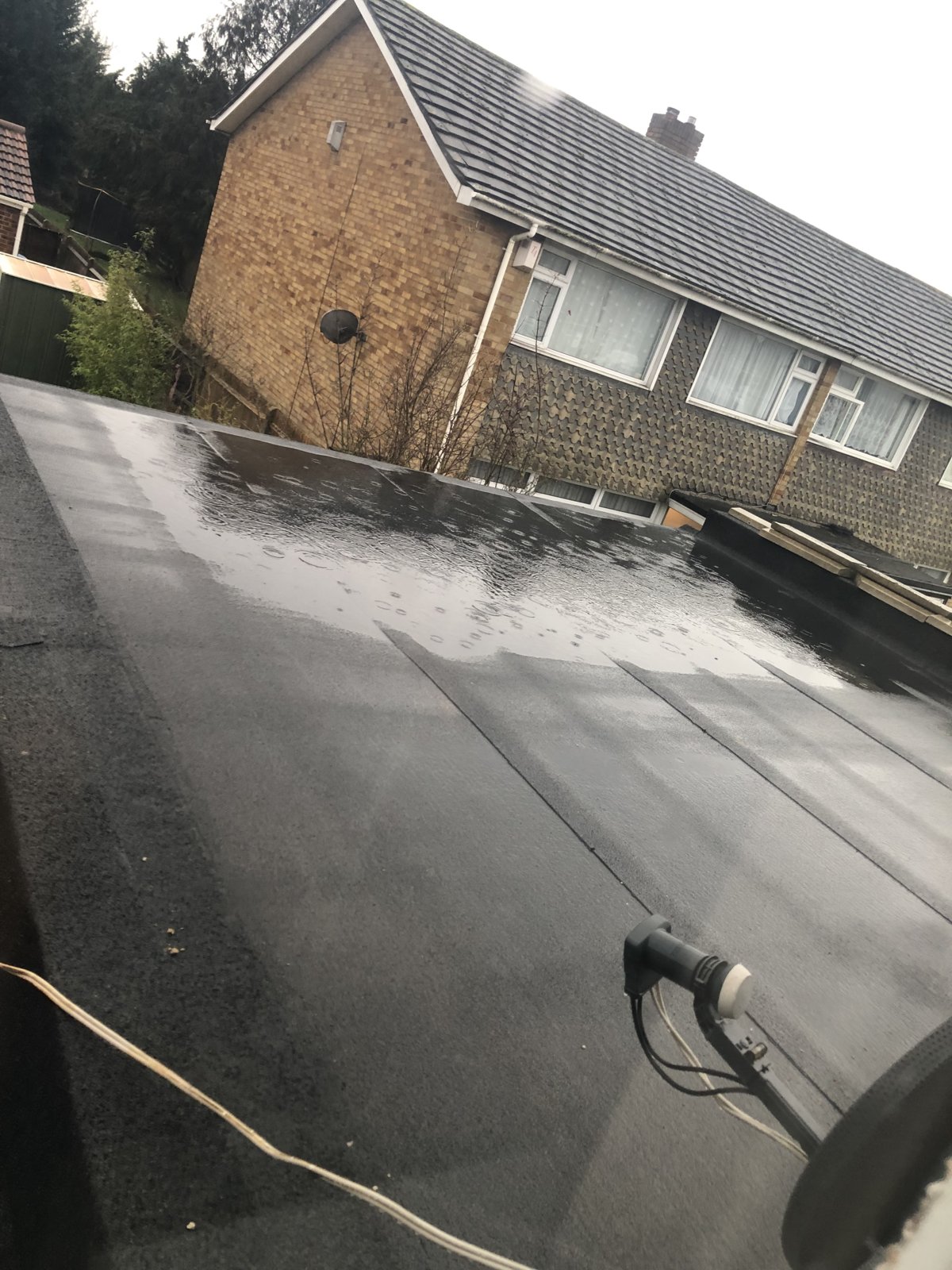

just has a new flat roof installed, chippy done the the structure but obviously didn't do the ferrings properly. He has now done a runner and can't get hold of him.
The roofer said he only installed the felt so not his fault as the chippy didn't install properly.
What can i do with this as water is pooling on the roof?

Rav M, good evening.
Which way was the intended fall in the roof?
Is the run off on the left hand side of the posted image?

Hi Ken,
Its meant to fall toward the sky dish at the end of the roof towards the building with the yellow bricks if that makes sense
You may be able to adapt part of the edge to lower the felt and allow the pool to drain.
Otherwise it will have to wait until the next re-cover

Can i add more layers to build up a slope or will that not work?
as above,
you could re-jig atthe edging strip where it falls into the gutter.
what is the bump at the edging strip?why is it ther? besides the fall/furring problem its daming the water thats poolin .
the top felt layer has been laid in the wrong direction - cap layers go across te roof not down it.
the right hand layer that runs up the parapet abutment looks like EPDM - maybe i'm wrong?
how was the felt fixed - is it self adhesive?
why the stone pieces sittin on the right hand edging/parapet - thats dangerous.

Theres not a edging strip that i am aware of maybe where it is wrapped around the ply and underlay and created a slight bump.
There is no EPDM all felt was all torched on.
There is coping stone on the top which is to be fitted still
No. If you are thinking of adding layers to the dipped area, all that will do is hold the water further back up the roof.
The roof deck is dipped and is the problem. You can't solve that with layers, but as a bodge you might be able to drain that area at the edge with some work on the felt and deck.

thats a very neat torch on job then but wrong - no squeeze out asphalt compound can be seen. sqeeze out should typicly be seen .
does the left side of your photo show your roof joining with a neighbors flat roof to the left?
