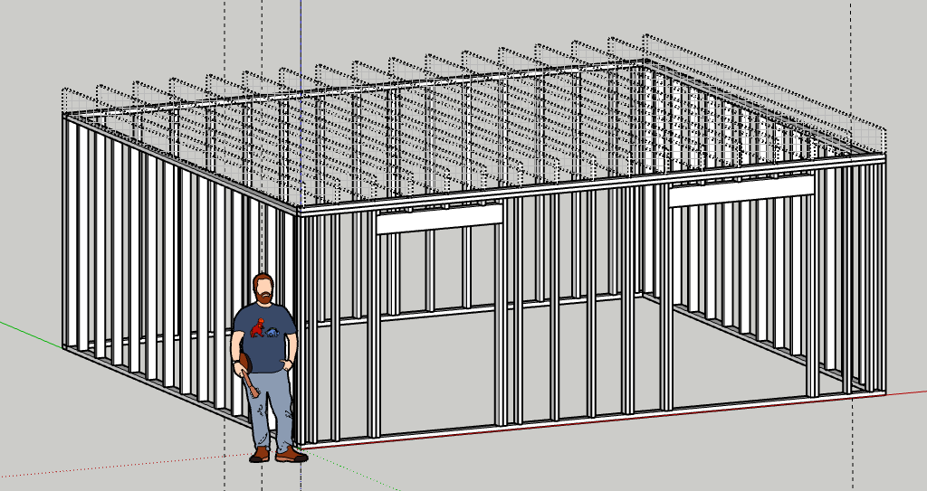

Hello all,
I'm in the process of planning a large garden room about 6.4m x 5.6m, the clear span would be 5.4m. Looking at the span table I can't see any timber over 220mm but looking at it I should be fine with 47x250 timber?
This will be a warm roof with 18mm plasterboard, joist, 18mm OSB, 100mm insulation, 18mm OSB and EPDM. so a fair bit of weight.
I might also put 10 solar panels on it later date probably with a ballast system. Would that work with the 250mm timber or should i get 300.
Thank you.
The risk with flat roofs is ponding and with timber it can creep and deflect over time. If water then collects in the centre this adds to the weight causing more deflection and ponding and so on.
You should split the span with a steel beam (a 178UB should be sufficient).
If this requires building regulations then you may need to get an engineer to specify the steel beam.
It's only a timber roof. If it were a floor then I'd agree. But bumping up to a 203 wouldn't increase cost significantly.
A lot will depend on the solar panel ballast.

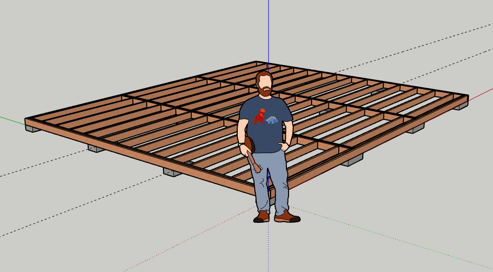

Hi George, thanks for that, I did not consider a steel beam. Building regs is not needed (under 30m2), I had a quick look, this would be 133kg for a 6.4m beam. That is not going to be easy to get in the back of the garden and up the roof. I assume i could then just us 6x2 from the beam as the span is only 2.7m.
How would I best support the beam. The walls are 4x2 timber, would i just double or tripple up the 4x2 under the beam, the garden room will also sit on concrete blocks, I assume it would be best to make sure there is a block under the beams timber to support the weight.
I have added a drawing.

Posi-Joists. (y)
Get that hipster dude to either calculate the required joist sections instead of relying on over-cautious tables, or use calculated engineered joists. Work out the PV panels weight, not guess, and don't forget snow loading.
Alternatively, to design out the risk of settlement of large single span roofs by using a much greater fall than 1:80, or form a very shallow double pitch but still within the tolerance of being a flat roof.
If it's a nice square building then posi-joists are a good option.
It may cost a little more than a steel beam and solid timber joists but you will just need to cost them up.
I specify them a lot and builders usually call and say; is it ok if we use 8x4s instead? to which I say no. Next job with the same builder they usually say; can we have those metal joists again. Once you go posi, you'll never go back.
