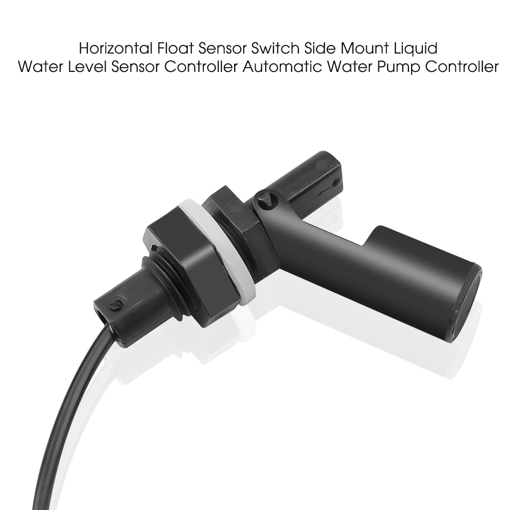

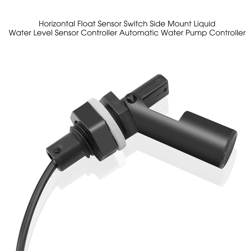

I bough a Float Switch that works with a floating on top of a liquid which opens or closes the electrical circuit as the liquid level rises or falls.
My idea was to use the ports S1 and S2 from the Sonoff Mini R4 to close the circuit and so I would be warned by Alexa the water level has gone down, however I’m affraid the S1 and S2 may not completly isolated and somehow I get 110V in the water tank.
Any smart device I can use? Maybe a dry contact sensor? Any suggestion?

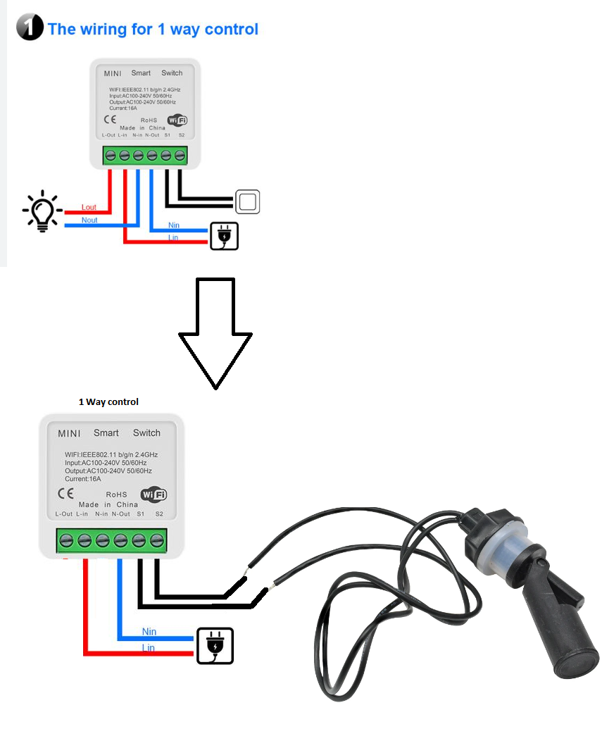

Do you know how to integrate that with any smart device? My intetion is not to turn on any pump, only to receive an alert on Alexa. The float swicth itself would be connected staright to the smart switch.
I was planning to use any smart switch with only to know the state is ON (buoy is up and circuit closed) or OFF (buoy is down and circuit open), however, as I said, I'm affraid to connect a 110v device to the Float Switch without knowing if it is fuly isolated.

Yeah, you both need a sensor not a switch because you are trying to detect the output of a switch.
Something like this might be a starting point for the float switch sketch with some experimental bodgery (to determine whether the thing expects variable resistance or variable voltage from the temperature/humidity sensors)
