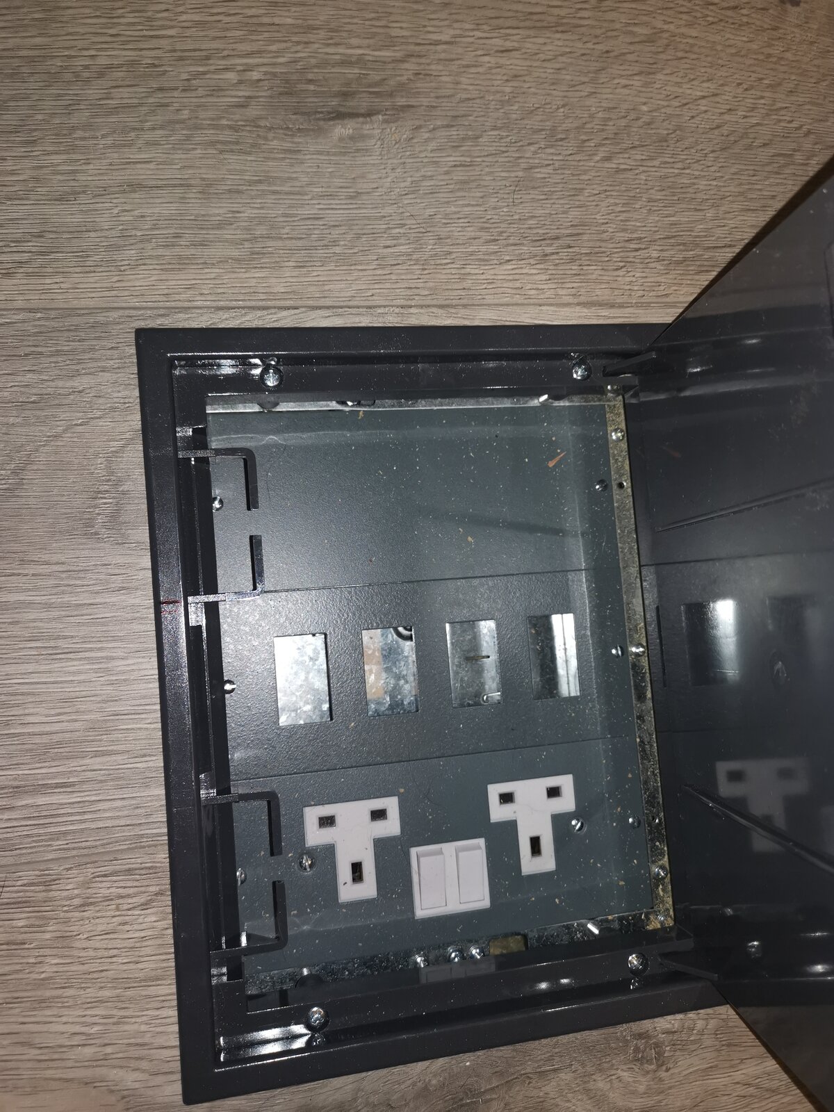

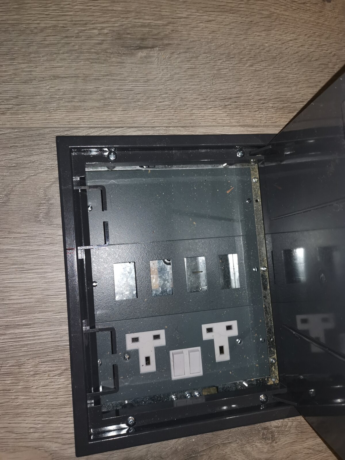

AIUI sockets on the floor fall into two basic categories.
There are the "floor sockets" with spring loaded covers as shown in bernards post, the problem with these is that they are easily damaged and a trip hazard, especially when in use.
The better option IMO are "floor boxes", these have the sockets set considerably below floor level and have a removable cover that can be refitted after plugging in the equipment. So you just have the flex coming out of a small flap in the floor. The downside is that they tend to be relatively large and expensive with most boxes designed to be big enough to provide both power and networking. After some searching I did find one sized to provide one double socket at a somewhat reasonable price.

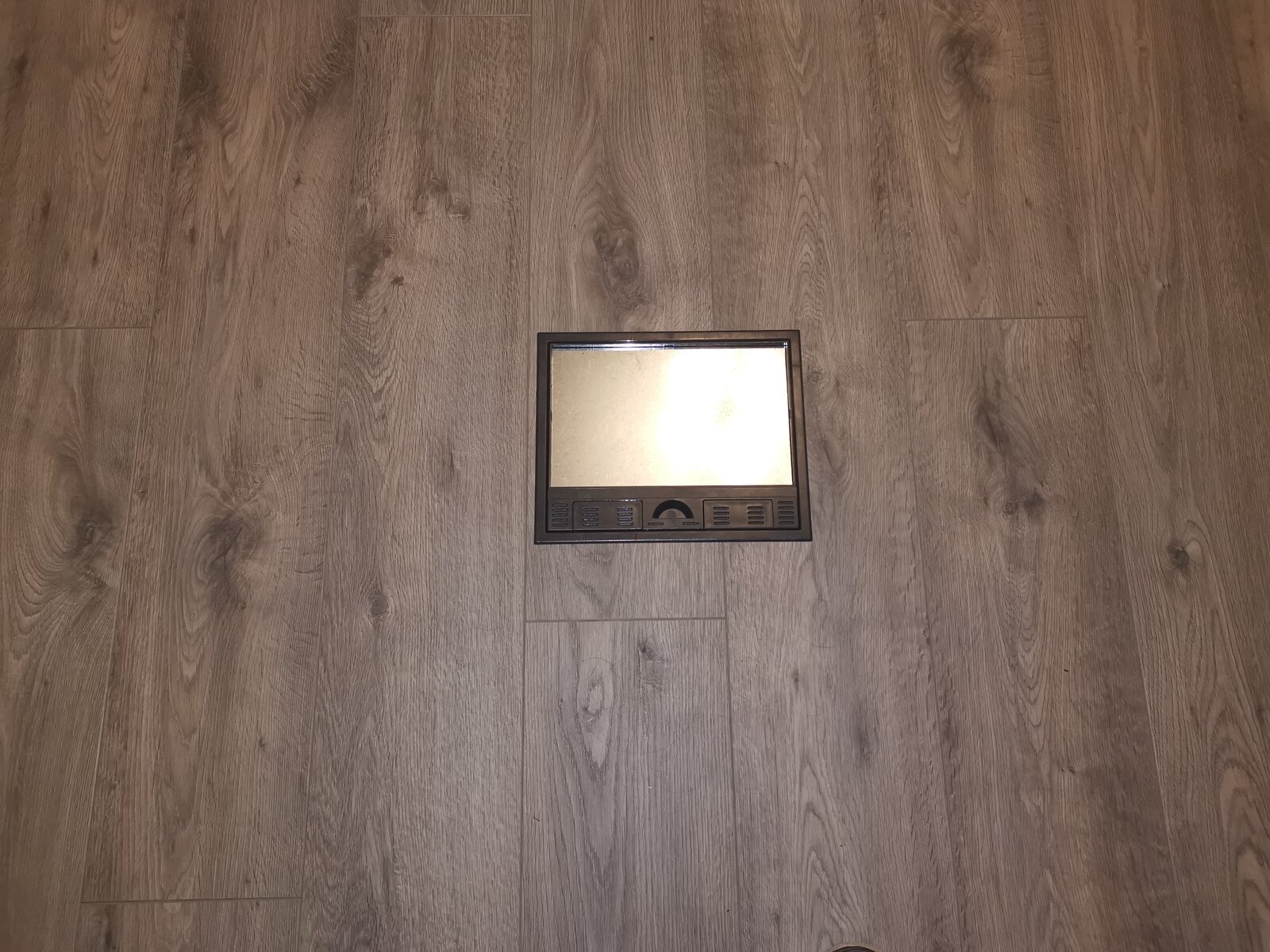

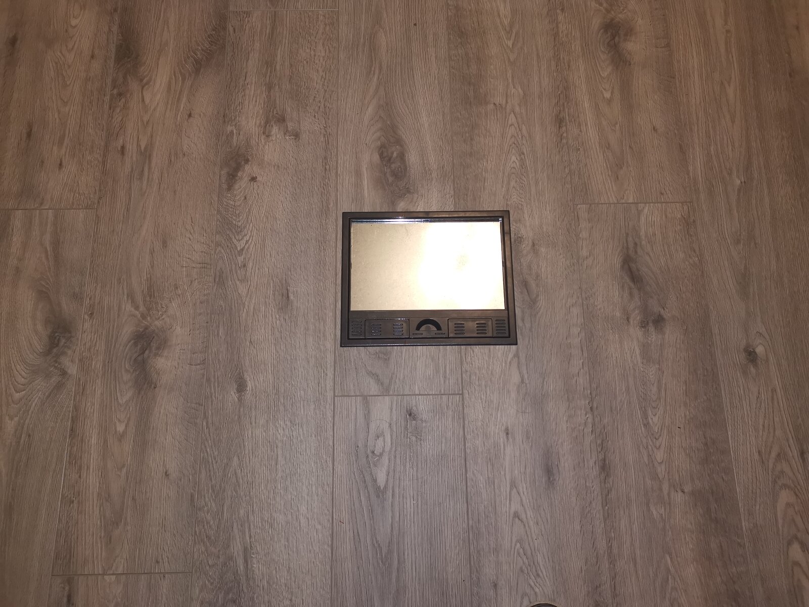

If you buy the correct floor box you can use the existing removed laminate so the box is (nearly) invisible

Hi Guys, all sorted, socket installed, and laminate flooring laid, here's a photo of the finished product, I just need to cut a piece of laminate to install in the top of the box, refit the skirting, and then all finished.
