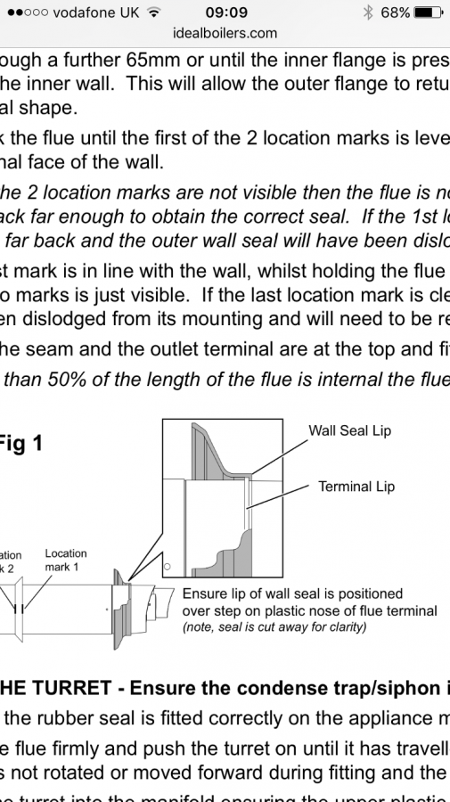

Two things to be aware of first.
Is there any white showing outside? If so flue is too long and won't be sealed properly as the black wall seal fits over the ridge on the plastic terminal.
Second how much of a degree of run back to boiler is there? The logic terminal length of flue has an inbuilt run in the inner flue so if you alter the flue to horizontal rather than back if should help with water in outer flue while still allowing condense to run back.

@shambolic - There is no white pipe showing. Looking at my paperwork from the engineer who was sent by the developer originally, they changed the angle of the flue. Speaking to some neighbours there is a mix of some with no problems, to some with a small amount of water getting in and they have also been told this is normal. I'll attach some images of the flue, you can see a cement patch where it was lowered.

Before you call anyone I suggest you try to measure the angle of the flue.
Some makers are a bit naughty about this. They often say the flue needs to be at, say 3 degrees, but any engineer knows that the fist section has a built in slope and so the outside of that section needs to be horizontal. But they don't actually say that. Worse, the tech help guys don't understand the finer points of boiler design and will sometimes tell you the first section needs to slope as well.
The inner part is carrying moist flue gases and some will condense there and so it needs to run back into the boiler.
But the outer is only letting dry air into the boiler and does not need to be sloped as the boiler has no provision for dealing with water coming back down the outer.
