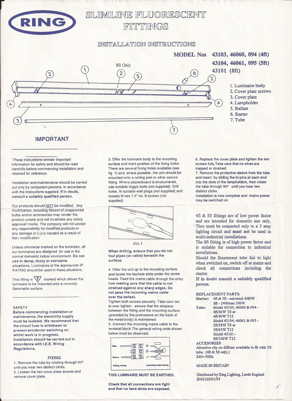

Utility room has a 4 ft tube that is taking longer and longer to get started. Do I need a new tube or a new 'starter' (whatever that is) as per the leaflet?
Can't find a 'Ring' online - can I use any 4 ft tube?

starter? Where and how?
Item 6 in the instructions you included in the original post.
Like the tubes, such things will not be available for much longer.
Starter from Screwfix or similar. If the starter is on its way the tube will be flickering several times before finally lighting up.

Have you tried taking the tube down and give it a really good stroking? (cleaning)
I don't know who it was that first suggested this to me due to slow starting but he was definitely in tweed and smoking a pipe.
Bad starter in my experience usually manifests itself as multiple attempts to setup the arc cycle (that's a really rough handed way to describe what's happening) but this covers it more intelligently.
If you change the starter get an electronic one. Costs a bit more, but less stain starting the tube which then lasts a lot longer.
