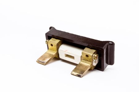

When a repair required is simple and it is carried out in day light, I normally have the the fuse box turned off. In all other circumstances the fuse box cover is opened and the relevant fuse removed. As I indicated earlier, my fuse box is over 20 years old. It does not have switches for individual fuses. To repair a fuse one has to replace the wire inside it. See picture below
Is that the same as your fuses? The carrier you pictured is Wylex brand, and that doesn't look like a Wylex consumer unit (fuse box).
