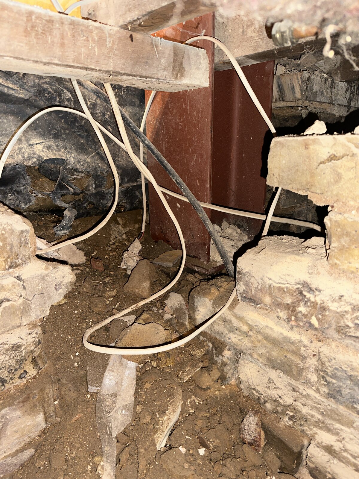

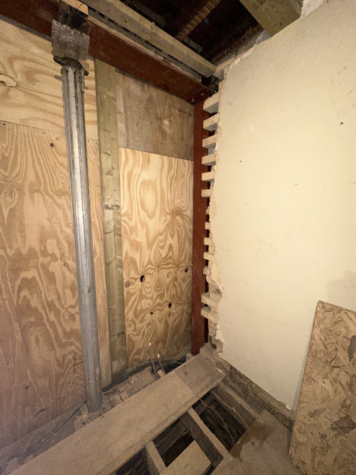

I'm having an extension built and knocking through the back wall. My builder has put two vertical steels and one horizontal steel to hold up the top floor of the house - a goalpost if you like
My question
in the structural engineers drawings, it states the the two vertical columns should be on a 1m2 concrete pad each.
But my builder has put them on the original house foundation that’s only 300mm wide and around 300mm deep.

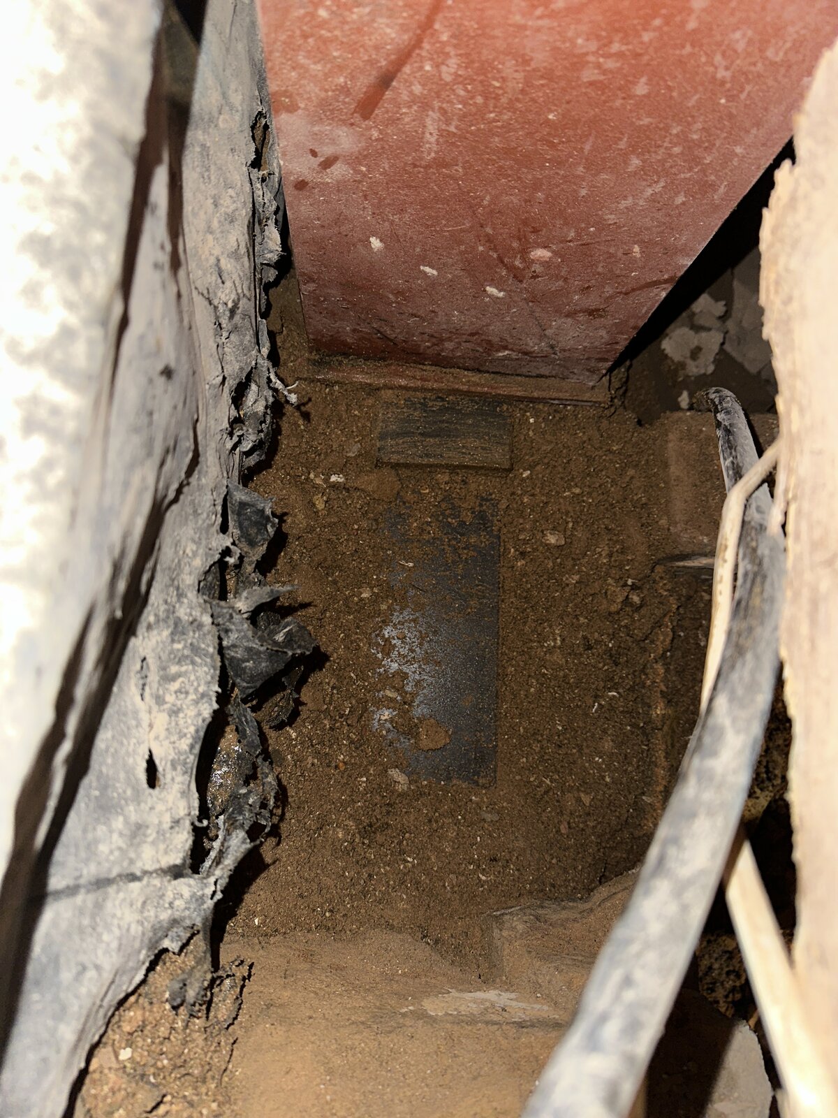

Currently the column sits on a steel plate that my builder has put on top of the original foundation.

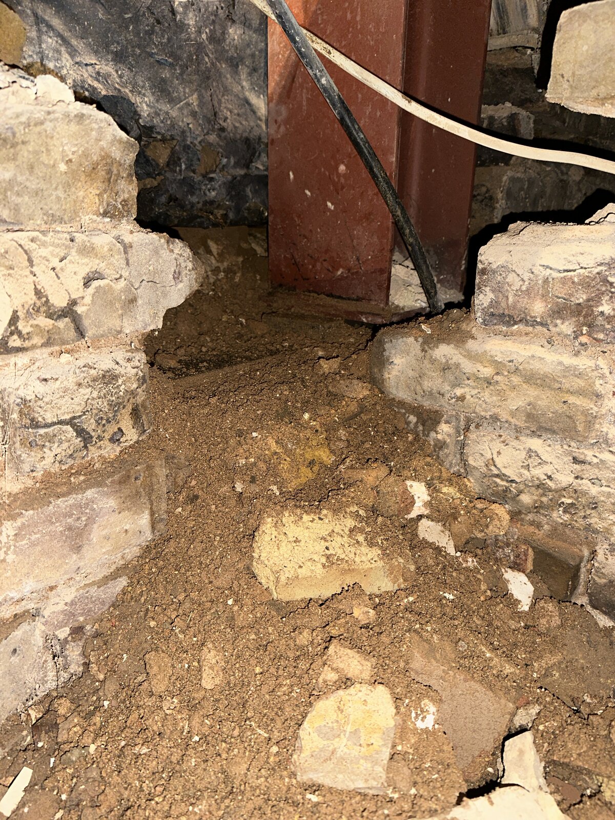

I went out there earlier and I can physically get my hand underneath about 80mm of the steel post, where it isn’t fully on the original foundation
This concerned me, as it’s holding the house up. But My builder assures me it’s fine and says he will pour concrete around it after, once he’s ripped the current floor up
Does that sound ok? And is that possible?

There you go. Photos from below floor, one above. These steels - along with several acrows are current holding the entire house up.

House load will never be transferred to underlying ground by just putting some mass concrete around/on top of the existing foundation, refer back to the SE or expect future settlement/cracks

Anything can be done, just like they stabilised the foundation under the Leaning Tower of Pisa but not without some extensive temporary works to support the steels as they excavate for the new foundation. If the BC has signed it off then since they have eyes on the ground and know what loads are involved then things may not be as bad as it looks.

He may have decided that current foundations were adequate but then he would be taking on design responsibility, best ask him the question
And if you want to rely on their insurance when it falls down, you need to have built it to the drawings they drew..
No point hiring an SE if the builder is going to play at it with his intuition
